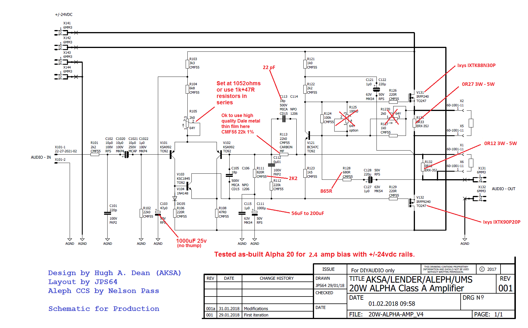

possible FQA38N30 or FQA32N20C

Alibear was asking for ON Semis- so i ask myself too: why a Uni Fet and not a Q-Fet in N Channel?
And FDA has much lesser gm(S).
The above named parts are much closer to FQA36P with S:19,5 (20 and 24)
Is that a good choise too for reg. ALPHA?

Question please, I have used FQA36P15 and FDA38N30 mosfets as suggested by Hugh right at the start of the thread. I need to get some more but my usual wholesaler is out of stock of the FDA38N30. Can you tell me is FQA40N25 a good substitution as those are in stock.I am not very familiar with Fets.

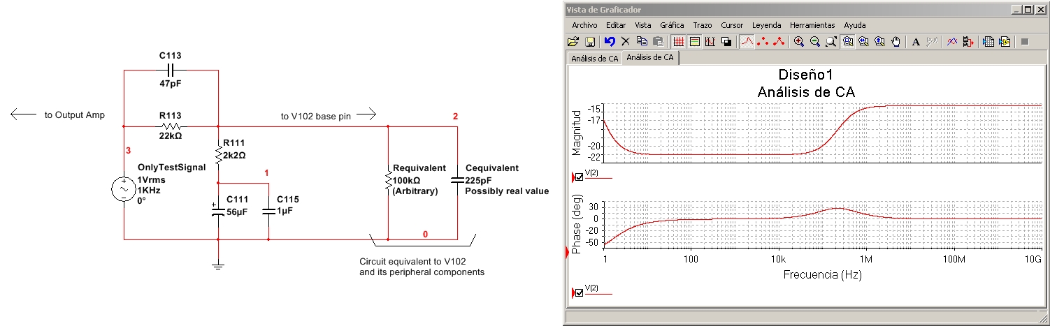

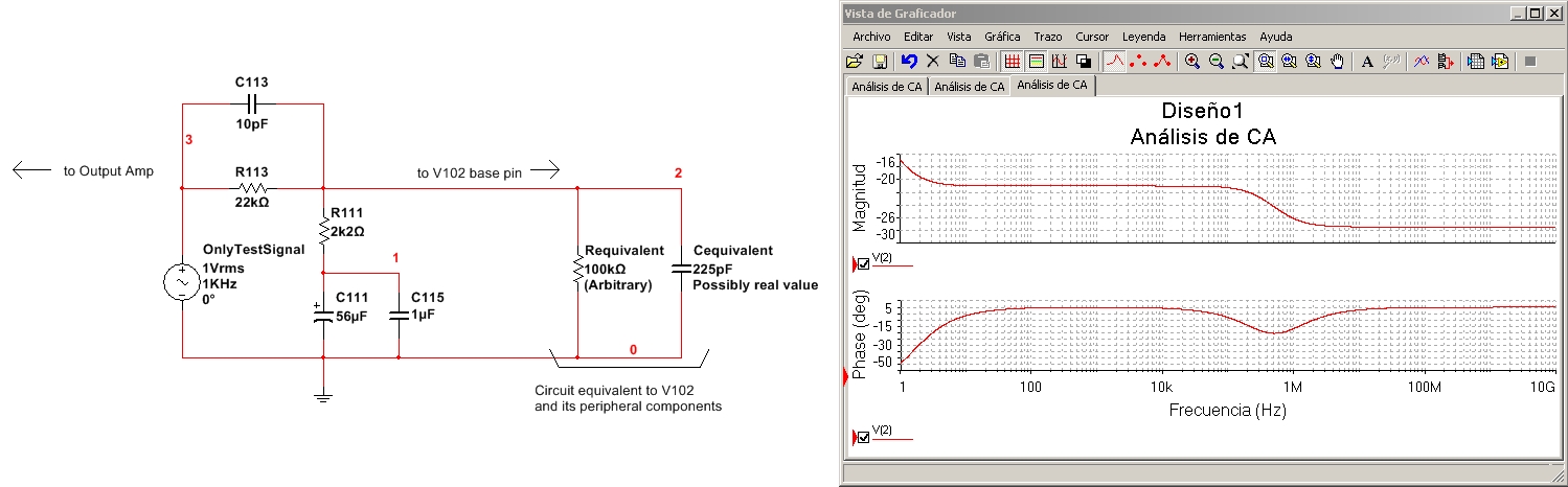

Hugh:
This is how I visualize the tuning process at the optimum value of C113 and, in addition, why it would be necessary to do so.
The base terminal of V102 plus some of its associated components could be simplified to a very simple equivalent circuit: mostly composed of an R and a C, both in parallel. The exact value of R I do not know it in that scheme, although normally it is not a very low value. In addition, its value (while remaining within a wide margin) is not determinant in what I need to demonstrate.
Although the value of C113 is imposed mainly for reasons of stability, it could be tested if, additionally, a feedback signal phase can be achieved without major changes in a wide range of frequencies.
In the tests I have uploaded, it can be clearly seen that a theoretical value of 22 pF for C113 could correspond to an equivalent value of Cequivalent of 225 pF. That is, very close to the reciprocal ratio of the values of the feedback network: C113 = (2k2 / 22K) x Cequivalent.
I think, besides that a concrete and real value of Cequivalent can be measured without problems (that would be very simple: we look for the attenuation point of -3dB, injecting a test signal from a fixed series impedance towards the base of V102, after disconnecting the entire feedback network.
See in all the graphs how the phase curves vary, altering the value of C113. Only one of them remains flat, when there is perfect compensation, depending on their associated impedances.

In the previous simulations you will see that greatly altering the value of Requivalent does not have an important impact on the final results. I have tested values from 22K to several Megas and, to the conclusion that I arrived is that only Cequivalent is the most dominant parameter .
