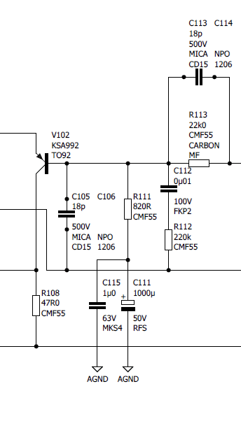

For the feedback resistor why is there a change in the feedback shunt cap (47u, 56u, 68u)? Can't we just use a big 1000uF can be done with it? Or is that big size detrimental? The 1000uF is what is currently on the principal design.

This is R101 and C103 ?

It's part of the fb high-pass filter.
47uf is what Hugh recommended for the 2k7.
On the ac analysis I see it's flat to 10Hz,
lower, it starts to roll off.
1000uf seems too much, there's no roll off, FR is flat down to 1Hz.
If it is detrimental, that's a question for Hugh 🙂

Alpha4R with shunt fb 2k2+56uf: 1.74 Vin (recommended, ratio H1-15/H1-4 = 99.74)
No, it's R111, C111 in this image.

Thanks, I recall Hugh saying a 220uF was plenty. Also, the voltage is not that high as there is the divider, so for 10x divider it sees no more than 5v or so. This allows us to use super low ESR caps like 4x100uF 16v oscons for improved tight bass response.
Thank you Danny your figures are all correct.
47uF is acceptable with 2k7 but if you want less than 10Hz you might increase it to 100uF.
