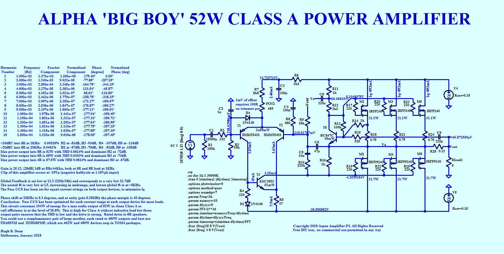

Hi Michael,
Thanks for your post, perceptive question.....
Notice the nested fb, 220k through 10nF. At 1KHz this is around 236k ohms.
This increases the interstage fb with higher frequency.
LTP degen reduces the loop gain and, significantly, the accuracy of the error signal; I am using nested fb here, but not throwing away the high transconductance with degen. The global fb at 1KHz is 236k/22k, a very low 10.73 which is only 20.6dB. All this follows the maxim that you linearise as much as you can, THEN add global feedback. Best to use nested fb to improve the linearity of 1st and 2nd stages and the drive of the VAS, rather than throw it away dealing with the error signal and maintaining a highish output impedance of the VAS.

Here is the latest update on the Big Boy from Hugh. The simulation approximates an FDA69N25 and IXTH48P20P devices with three parallel IRFP240/9240 devices. They have approximately triple the capacitance. This eliminates need for matching output devices and keeps CPU heatsinking simpler.
Why so little current through T3..???

I am wondering if maybe we should be using a 40V trafo and then put it through the nice Prasi cap Mx board to drop to 36v dual rail. We get nice ripple free 36v and lots of amps without such a large capacitor.
http://www.diyaudio.com/forums/soli...sy-capacitance-multiplier-27.html#post5214663
Just some more IRFP's and maybe a pair of 22mF or 33mF caps and exrernal bridges.
