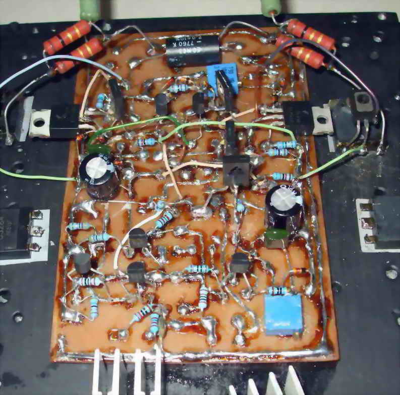

You may want to learn a thing or two from Carlos, diyAudio amp builder speed demon. His regular proto amp build takes literally minutes.I'm going to wait for JPS64's PCB's for stereo. Wiring this amp P2P was a real pain.

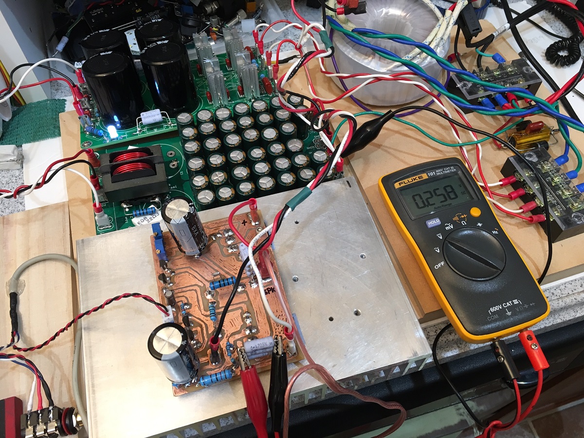

In fact, I did. He suggested use of nail polish to do etch layouts. I use a Sharpie marker. I built the DLH in about 3 hrs from sketch-to-sound. I am going back to this method as it is a lot less error prone than P2P with wire:

Which caps are you referring to? The DLH amp shown a few posts above has some rather large caps on the feedback and bootstrap but is using a 10uF Silmic II vs the 4700uF recommend by the designer. But that’s a different amp and shown here only for purposes of Sharpie based copper etching method.
Oh, that was an LTSpice manipulation to make sure that the input capacitance value does not have any impact on the THD analysis. Forgot to mention that - a 10uF bypassed with usual 1uF MKP should be fine there.

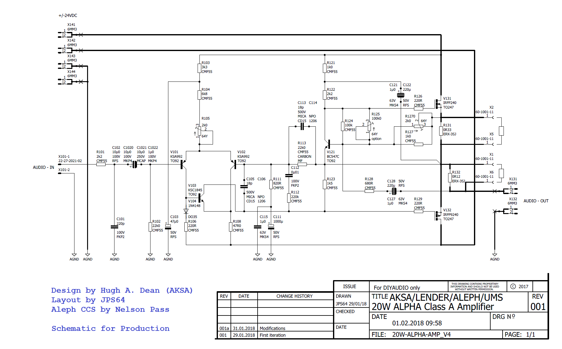

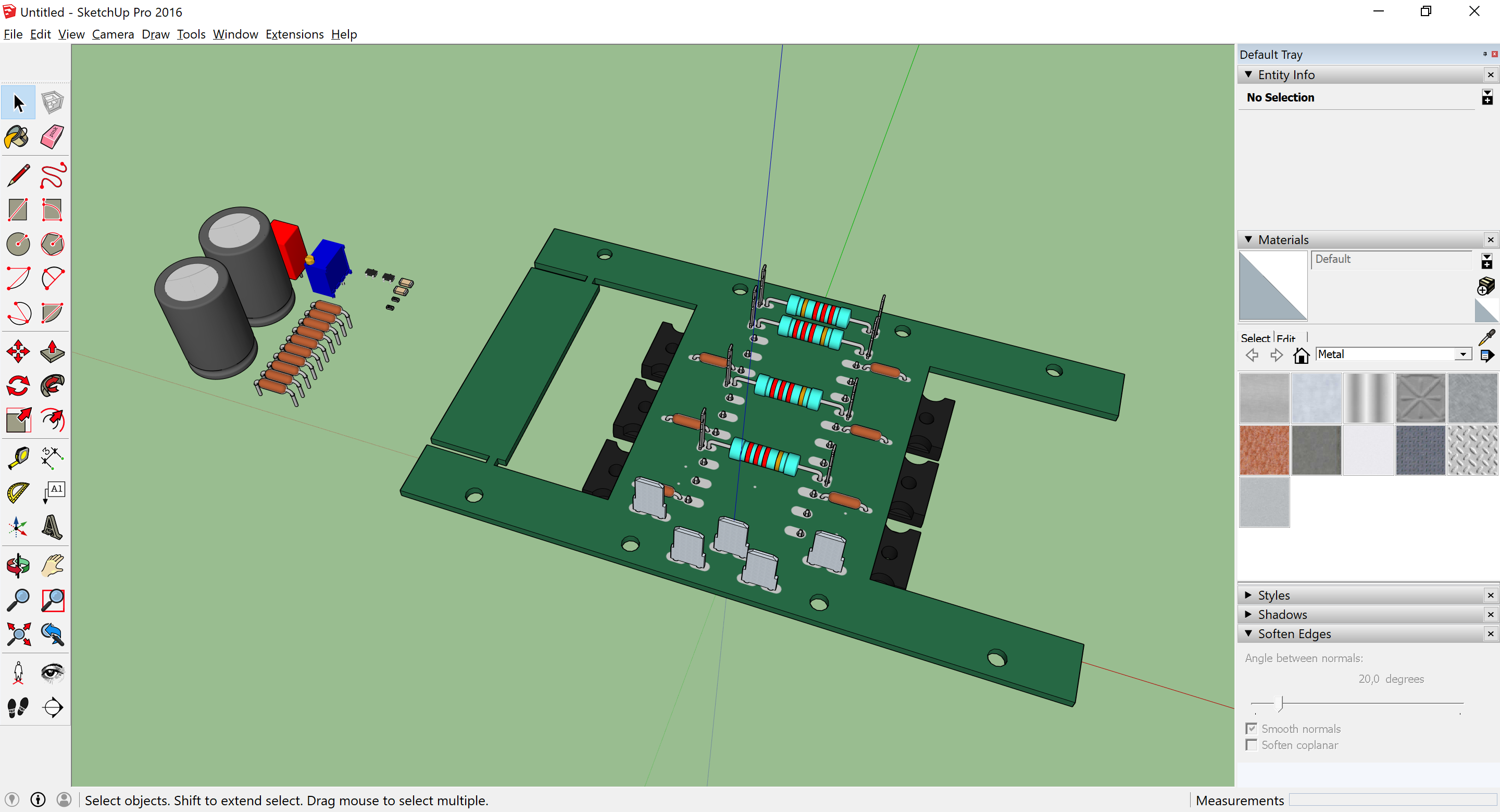

ALPHA 20W Amplifier Design for Production v4
Folks, thanks to JPS64, we have the following for the beautiful pro layout and renders. Looks like it will be a double thickness 70um copper trace board with traces on two sides connected by vias for high current paths for an equivalent 150um thick trace (nice trick there JPS64). The board will be 150mm x 50mm and compliant with UMS heatsink for ease of use.
Schematic:

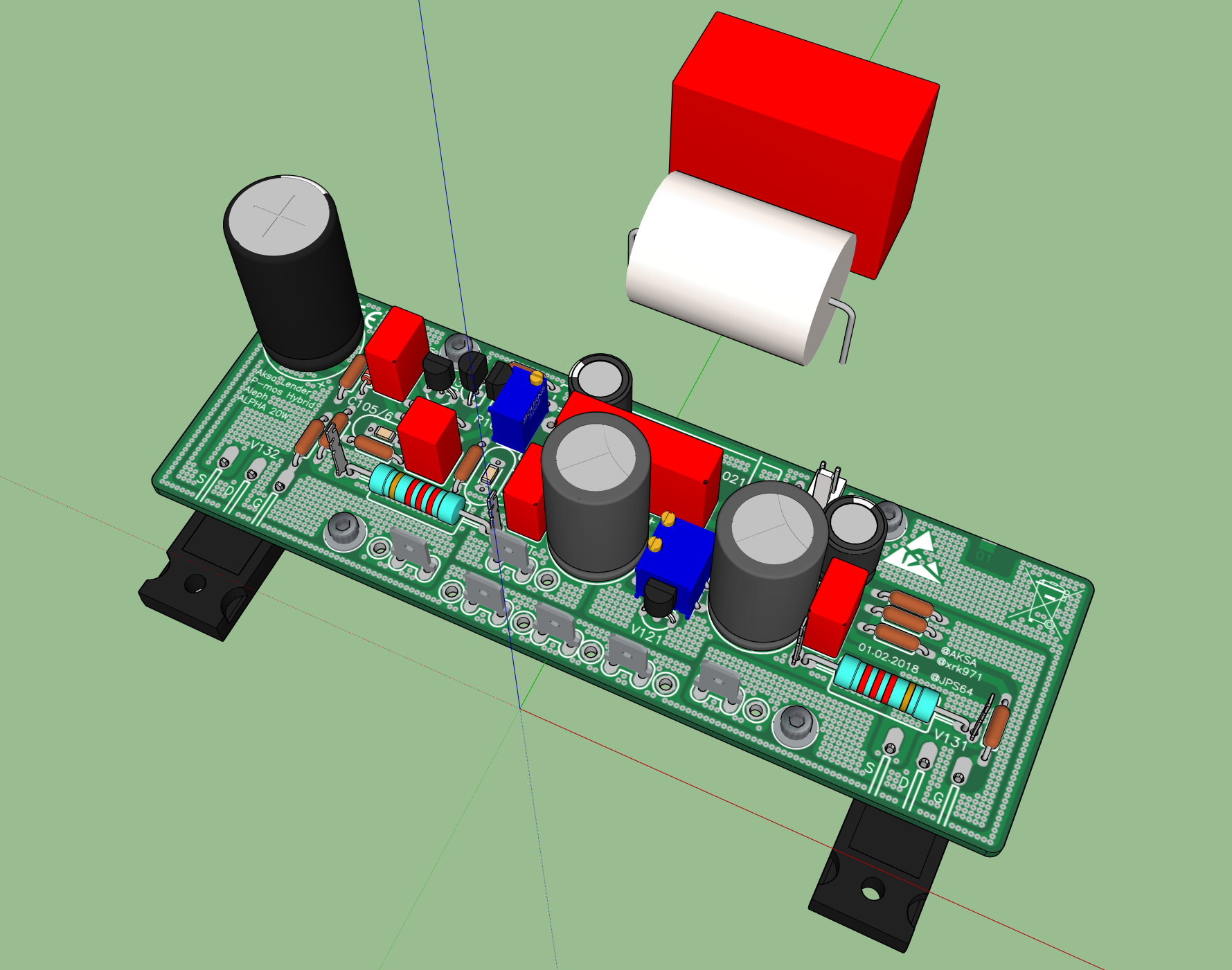

3D Render of built up board:

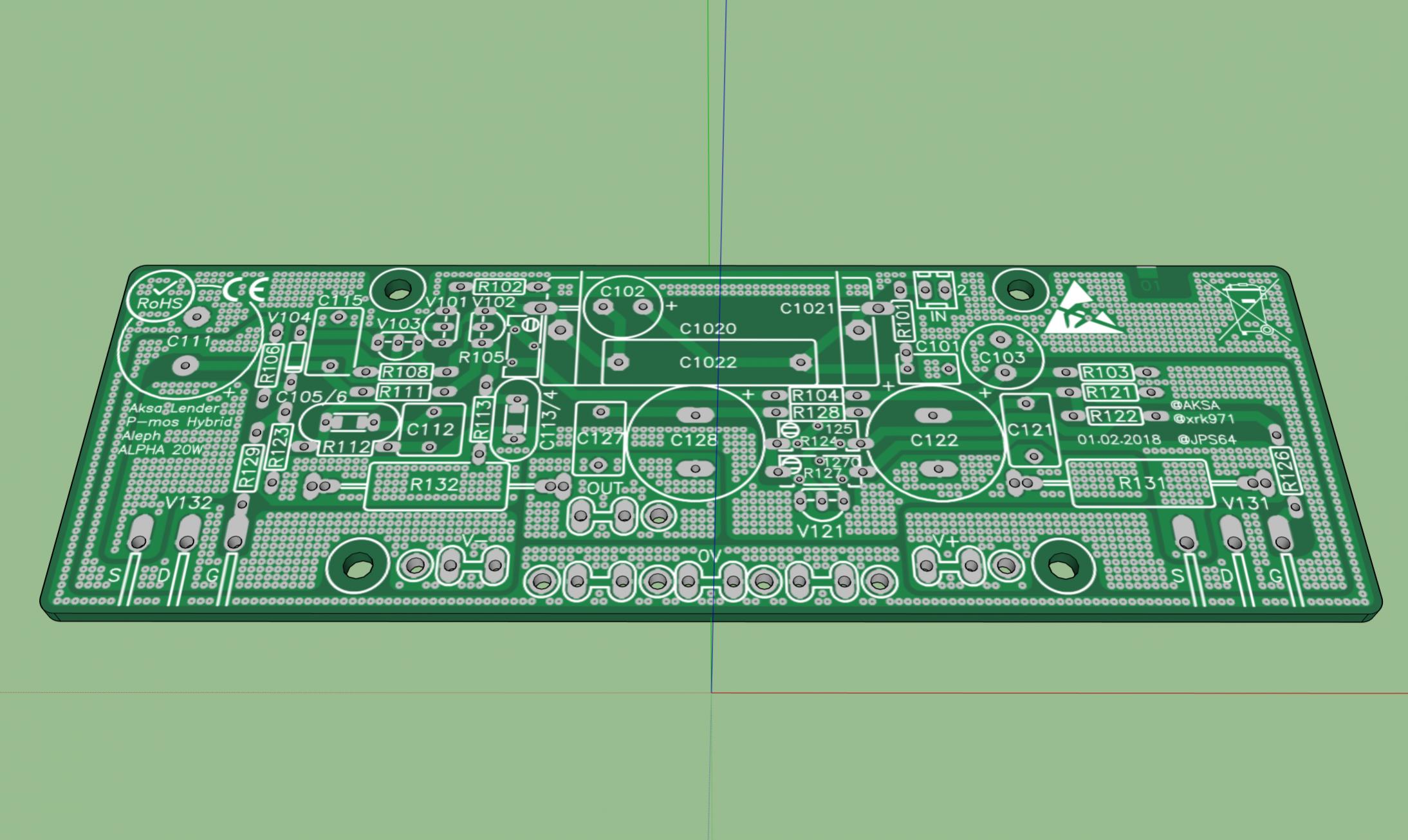

3D Render of PCB topside:

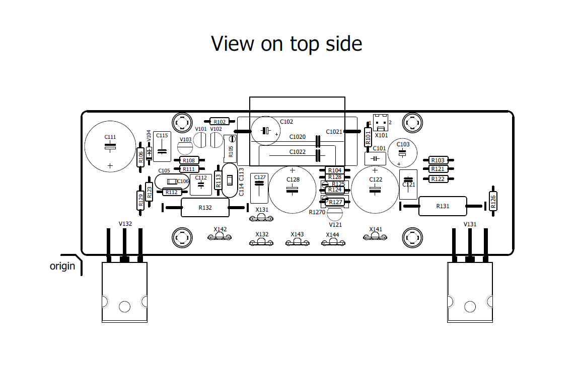

Line drawing of PCB topside components:

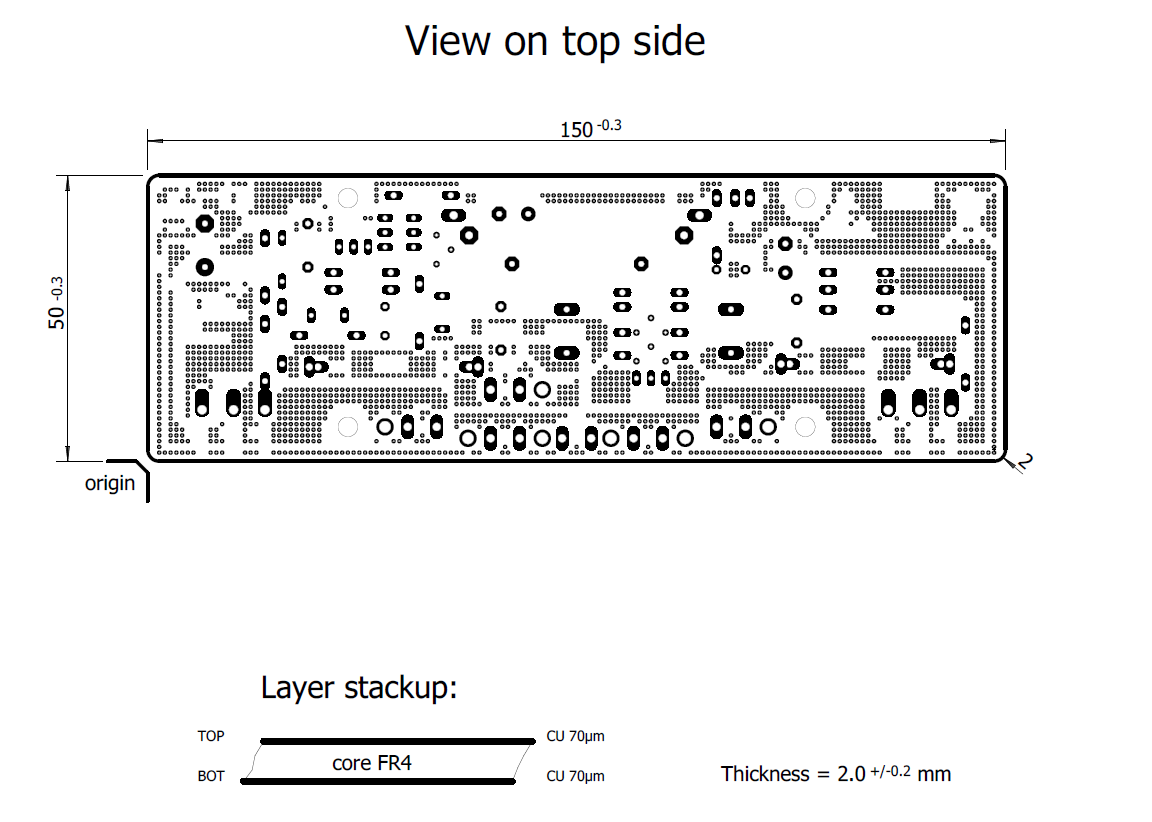

PCB topside vias and stackup showing 2mm thick board with thick traces:
I guess we are ready to start a GB? Let me check with fab houses and I will get back with costs, it's a large double thick copper board so may be a little more than what you may have had in mind. One way to keep costs lower is to go with 35um copper and rely on two sided vias to give us 70um equivalent and use 1.6mm thick boards. What are folks' preferences here?

Count me in. Thicker board preferred.
