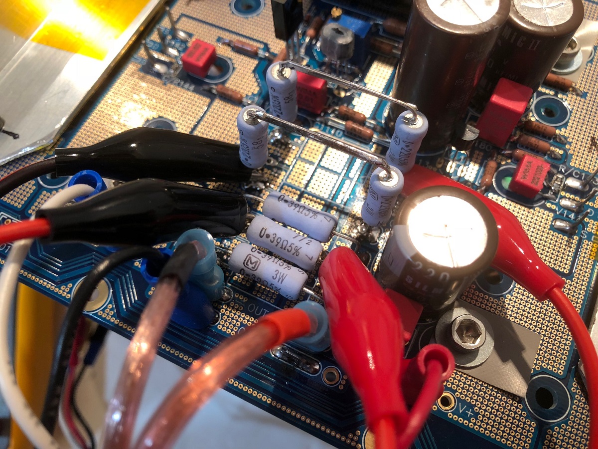

Alpha BB Amp Testing Update - 3amp Bias Current Fixed
Well I was able to get the perfect resistor settings for a 3 amp bias. I used qnty 4 x 0.22R 3W Panasonic ERX in series-parallel for 0.22R and 12W. Should really reduce distortion as heat generated is almost none. Bias comes in at 2.95amps. The corresponding Aleph feedback resistors should be about 1/2 the resistance of source resistors so I left it as qnty 3 x 0.39R in parallel for 0.13R effective and 9w capable (dissipation only needed when high AC swings involved). With this change, the rails are at +/-29.0v now. At 8.0vpp 1kHz I got some reasonable values for the AC voltages across the resistors (they should be about equal for the best balance of push-pull from the Aleph CCS).
Here is the new resistor setup:

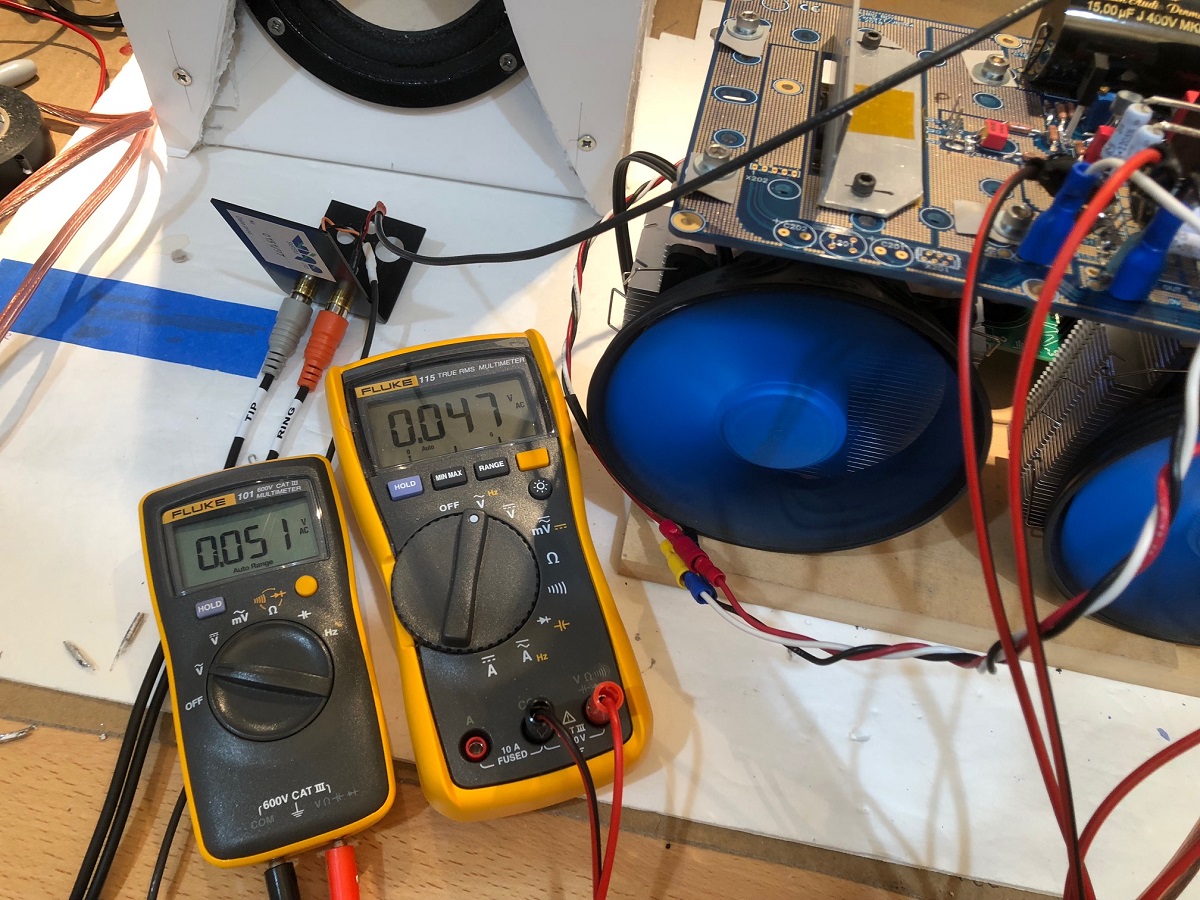

Here is photo of the two AC rms voltages with 8.0vpp 1kHz applied to check the Aleph CCS balance (the values should be similar):

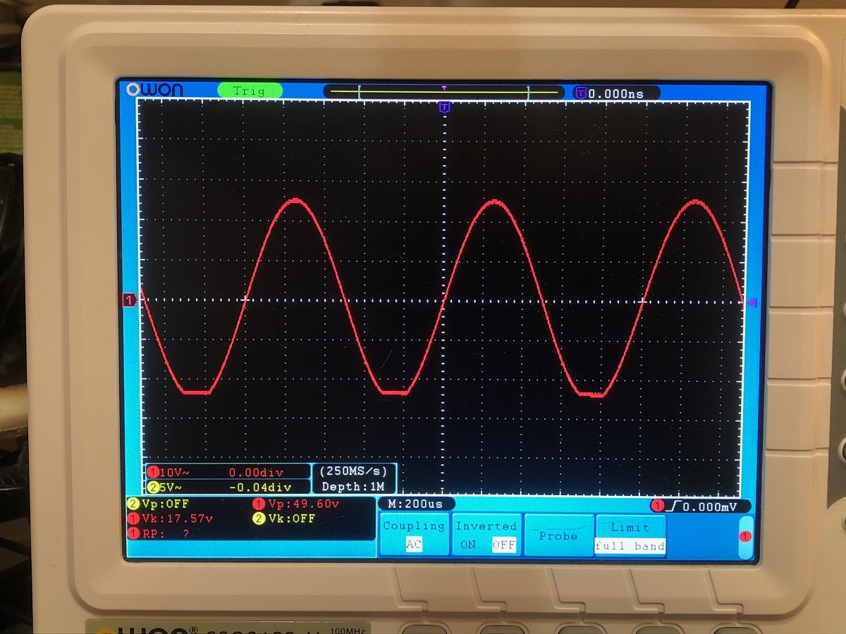

Here is a scope shot of the clipping behavior (+/-29.0v rails), it clips on the negative rail first (at clip power is 38wrms):

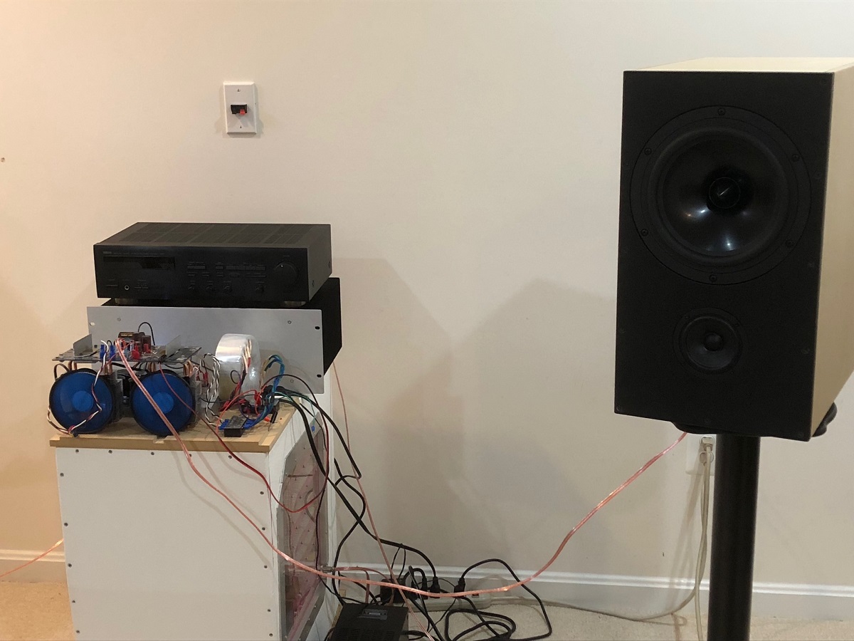

So listening to it now on mono test speaker and sounds very nice, can get very loud and not sound strained. I think I need to fix the PSU voltage dropout issue to try and get the full 52wrms. A 400VA 25vac trafo should put out more that +/-29vdc at 3amps. I may try a monolithic square puck bridge and couple that into the current CRC beyond the diodes.
Then try to figure out where the 2.5mVac ground loop hum is coming from. DC offset is still 0mV to 1mV at all times and all heat loads. Fans are running at 25% setting, and it is too much cooling, if I could go slower, it would be even more quiet. Temps are 37C on P body and 33C on N body and 28C for heatsink fins on both sides. Barely warm.

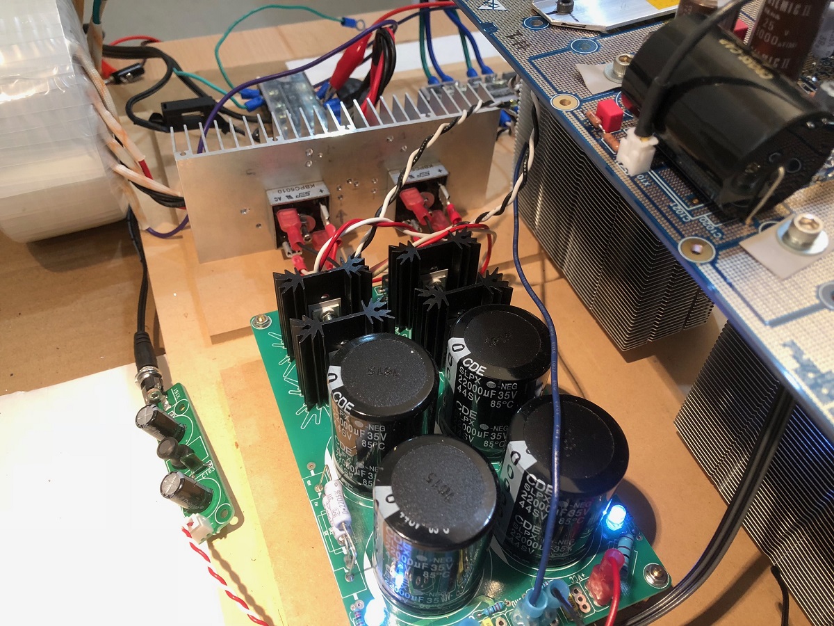

I bypassed the MUR880 diodes on the CRC with a pair of external square 35amp puck bridges and got the same thing as the on-board bridges. I changed the R on the CRC from 0.235ohm to 0.11ohm and got a few more volts, now at +/-30.0Vdc under load of 3amps. 33.5vdc with no load. Moved it over to my main 10F/RS225 FAST speakers for a listen. Listening now - plays very loud and clean. Very nice.
So I think the trafo is the issue. This is an Antek 400VA 25VAC, model AS-225. I might need to return or exchange them as I need 35v rating under load.

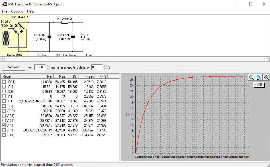

Hi X,
Try the PSU Designer.
A very good tool to simulate the voltage drop and ripple of a PS.
Be sure to enter the correct resistance of the transformer,
and you'll get accurate simulation results.
I had to run it as administrator to be able to load .psu files.

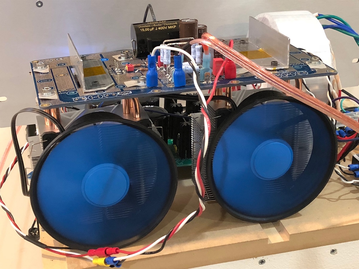

Looking good your BB !
The heat dissipation system seems to work very good.

Thanks, Danny. I will look into it. I understand that load draws the current and droops the DC voltage. The strange thing is, I have always noticed that the DC voltage from after the bridge with a CRC or even C is pretty close to 1.41 x Vac. The Vac is 27v yet, Vdc is only 33.5v under no load.
Closeup of amp showing heatpipes visible underneath:

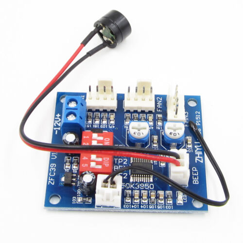

Well, I found out what the two pots on the eBay PWM fan controller do: they allow you to set the minimum fan speed manually. I turned the pot all the way CCW and the fan is almost inaudible. The SPL meter did not register 30dBA until I brought it within 6in of the blades. The other trick is to use the Fan 2 and Fan 3 connectors as those can go down to the minimum 10%. Whereas Fan 1 goes only to 20%. The fan on my laptop is much louder and more annoying.
So 6in is .154m and at 1m, that is 6.5x father away, or about -7.5dB less or 22.5dBA absolute at 1m. Pretty much within the room ambient noise - circa 30dB to 42dB for my listening room depending on time of day.
I am using the following DIP switch settings (1 to 5): OFF/OFF/ON/OFF/ON
If you want to get these, do a search for "PWM fan controller CPU" on eBay and you get dozens of hits. About $3ea.

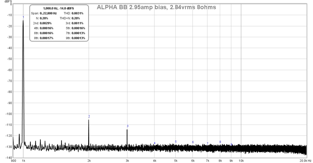

I am still working on the PSU issue, and also perhaps related to the PSU is that the amp has about 2.5mV 60Hz hum - which is audible at about 25cm away from the speaker - as I am used to having 0.2mV noise on my amps. So the PSU needs a lot more work. I will have to order qnty 16 x 33mF 50v caps in order to put this to rest.
In the meantime, I can look at the amp's performance to the right of the 1kHz excitation. Here is the first FFT for 1kHz 2.84vrms into 8ohms. A very nice profile showing low noise floor, and dominant 2nd order and lower 3rd order and THD of 0.0031%.
Source was Cayin N3 with AK3390EN DAC playing 1kHz test tone file generated from Audacity as FLAC. Signal going through Aksa Lender preamp for volume control. Vrms measured using Fluke 101.

Hi Hugh,
After adding a 10mF//0.22R//10mF CRC on top of the existing CRC, the ripple under power is now 32mV. Hum is still there, so I have to look at either perhaps the toroid is too close to the amp and radiating EMI, or maybe I have an inadvertant ground loop created by mounting the CPU cooler frame and it is touching somewhere, etc.
Edit: just moved toroid around to 16in away and below amp and no change in output noise, still 2mVrms.
I discovered that the ground plane (ring) around the PCB that touches the MOSFET crossbar clamp is floating (about 0.46vrms). I grounded that with a wire from clean 0V to the plane but that did not affect the 2mVrms output noise.
