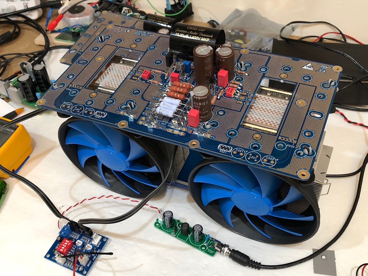

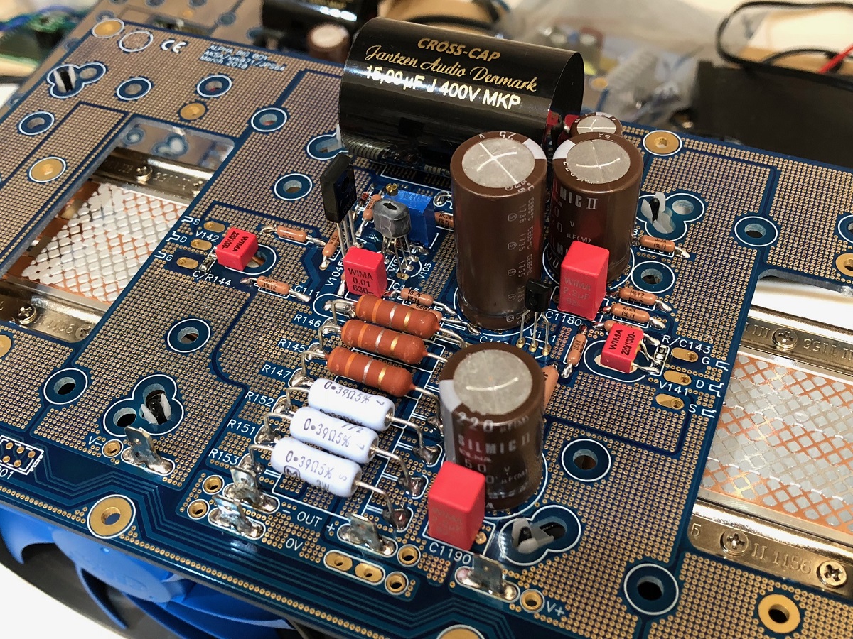

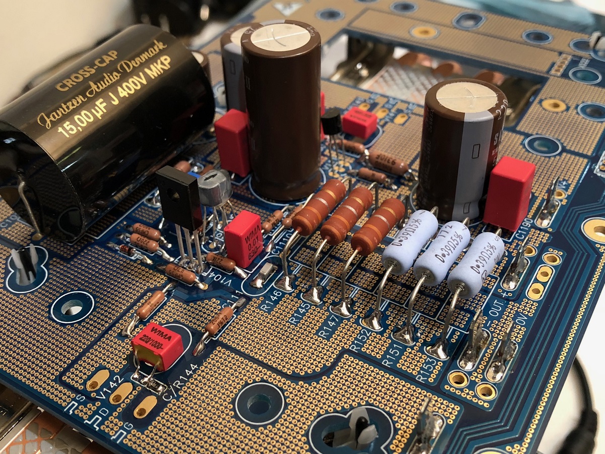

Alpha BB build begins. Managed to stuff and solder everything but the output MOSFETs. That will have to wait for tomorrow as I also need the non-conductive heatsink compound for the ceramic spacers.
attachment.php
attachment.php
attachment.php

XRK how do you get good pressure for mosfet to cooler ? Also better have the coolers running at max speed befor powering up the ampboard, I think temp will stabilize around 45 degrees above ambient, but I seem to be only one that sees over 200W dissipation per mosfet and 6A bias 🙂
Can I ask you where did you get the IXPS devices? Did someone ever compare with the IRFP type?
I do have some IRFP at hand (I could use those for PS) at low-Class A amp or Class A/B type. I wait maybe someone will offer some matched sets with the BB.
Of course, bought those devices from mouser. Not the cheapest ones though.. Haven't compared to IRFP's, I just trusted (Aksa's, if I remember right) word that they are good. Amp sounds great as far as I can tell, even my capMx seems to oscillate (?)
Will wait until you test it. Can you do an A/B test between the L & R channel of course in case if you are not set up both channel with the IXPS devices?
Maybe to much power (it not supposed to oscillate because of that) or something else got the best out of the capMx, other people had similar issues. I am a fan of the old style PS. CRC set up. MLytics are exceptional but $$$..
