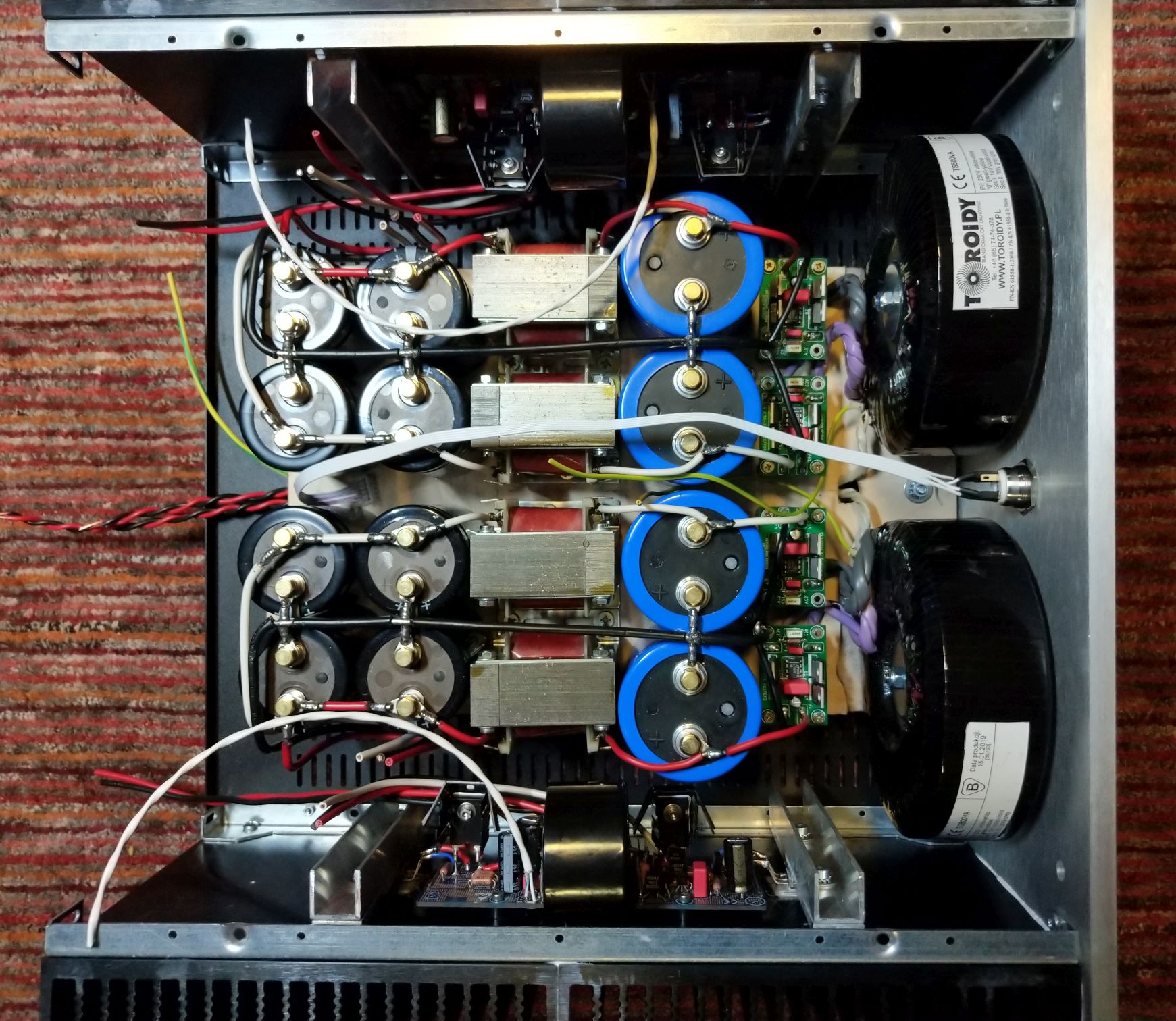

Aksa Lender P-MOS Hybrid Aleph (ALPHA) Amplifier

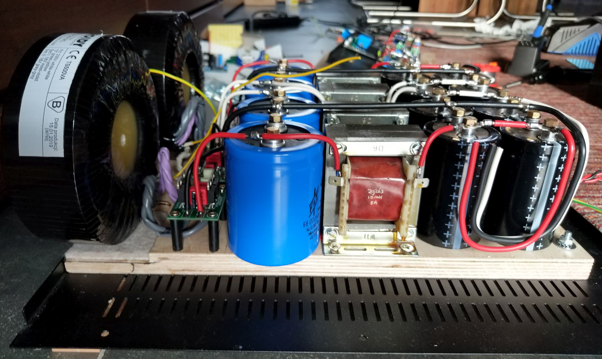

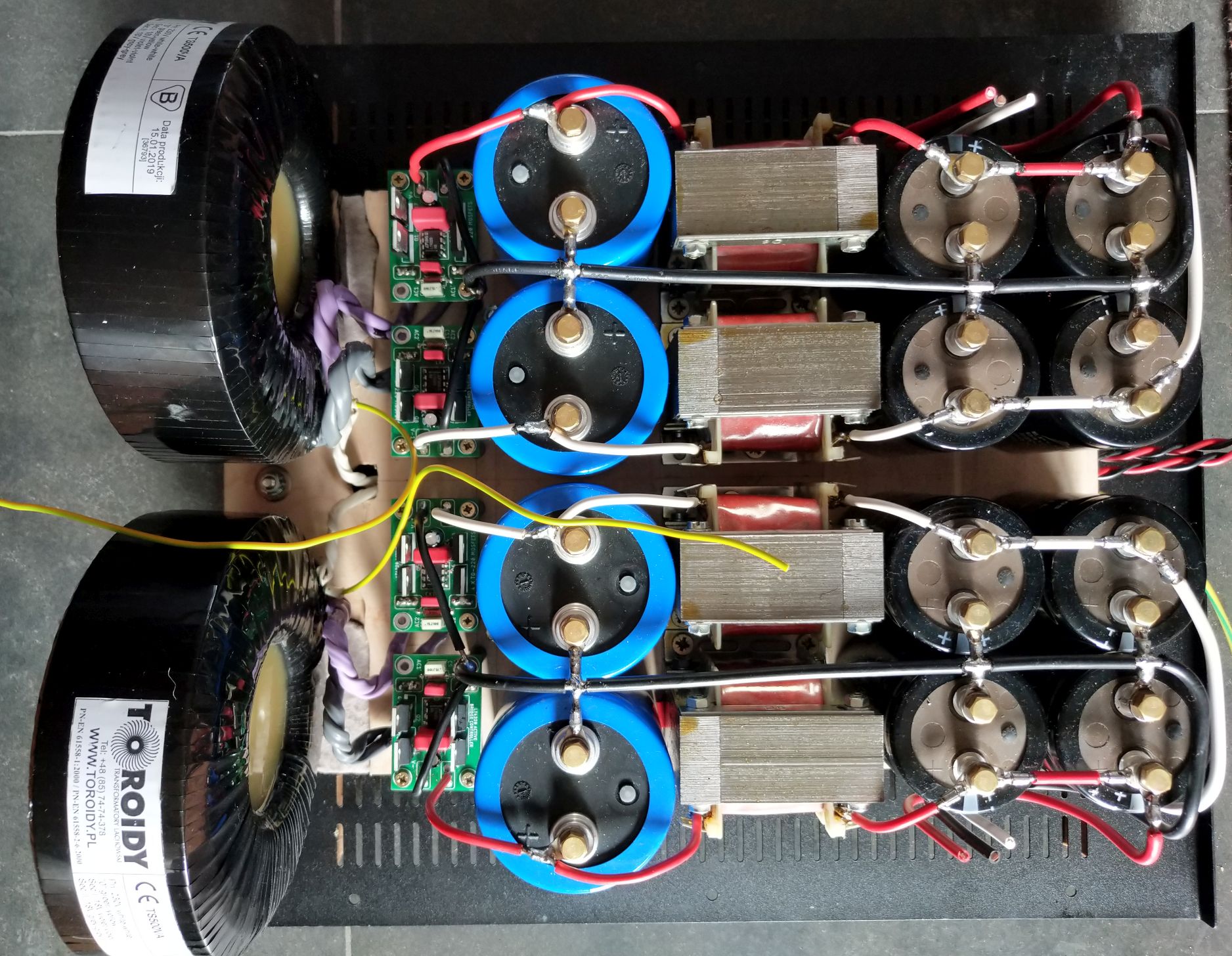

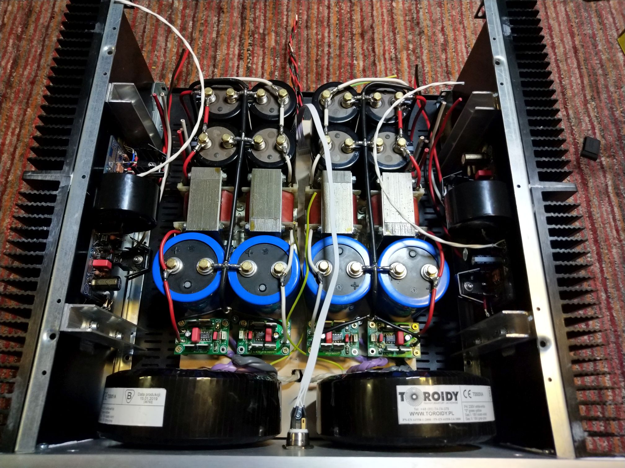

Getting closer to a working amplifier, I hope :)
Although it's a large 4U 400mm case, there's not much room left.
Small detail, I've put thermally conductive paste between the two heatsinks (each side has two heatsinks) and also the frontpanel.
So the frontpanel and the four heatsinks become one radiator.
The next step is installing the backpanel with softstart and DC protection on it.

Thanks!
You think that a 4U/400 case is large until you try to put everything in,
always buy the larger case when in doubt :)
Some more details,
the transformers rest on the wooden multiplex but are fixed with bolts to the frontpanel,
the transformers are sandwiched between rubber washers on the bolts.
The mains goes under the wooden multiplex in which I've routed a channel, coated with aluminum paper and connected to earth.

Hi Danny,
Good idea to employ the front panel as radiator. I did not add thermal compound on mine, also a 4U but 300mm single UMS heatsink on Dissipante case. The front panel gets quite warm and probably contributes maybe 10% of the cooling.
Your build looks very impressive. That’s one of the most manly-man PSUs I have seen! Complete with active bridges and big iron CLC.
Looking forward to your listening impressions. What voltages and bias currents are you set up for? Is this a 4ohm capable Alpha?
I also shifted the PCBs one cm more to the frontpanel than in dead center,
this to distribute better the heating of the two mosfets (taking in account the frontpanel as radiator)
Yep, the 4R version (1.8k FB shunt resistor), I'm obliged after all the simulations I did ;)
The rails will be 24vdc, bias 1.9A, higher damping factor with NFB resistor divider trick.
I'm also eager to hear it play, hopefully next WE

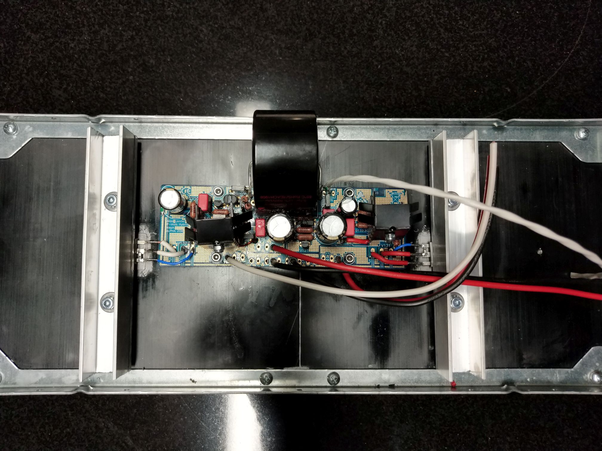

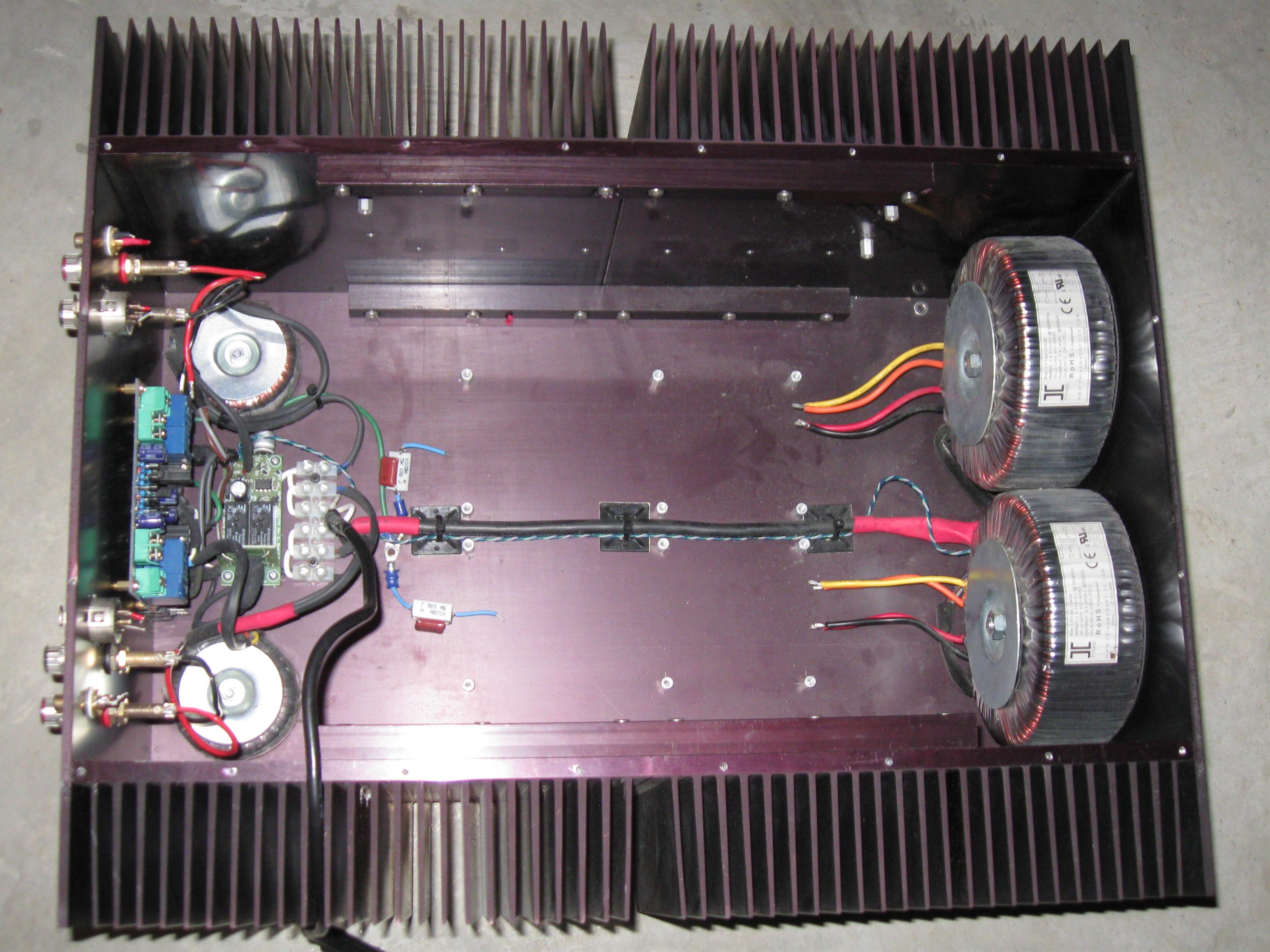

Hi X,
I have an unused chassis available and was wondering if it would be suitable for a stereo ABBB or Nirvana?
The chassis has (4) 8.0625" H * 10.0625"L* 2.875"Thickness (.375" base plate + 2.5" fins). (2) heatsinks per side.
