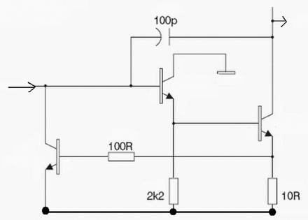

AKSA said:Hi Pooge,
I've found this gives very good sound. I can't argue too much about this, because such debates become interminable and people soon loose interest in the finer academic points, but a larger emitter resistor constitutes degeneration, reduces transconductance, and to my understanding always improves linearity by dwarfing the non-linear b/e junction with ohmic resistance.
There is some controversy on this point, with proponents invoking higher math to prove a point of some conjecture.....
gm doubling is a function of both transistors being on at the same time during crossover, and its effect is to rob very low level detail, the bane of Class AB. It can be reduced by better controlling the output of the voltage amplifier.
Hugh

So since it's improve overall linearity of the amp, it's also reducing crossover distortions and give better small details sound and soundstage sound quality ?
Hummm... I think I'm learning a little bit about how amp design work, but I still need few more hundred years of learning.
Gaetan
