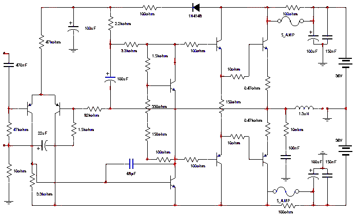

Christer said:, but resistors have been used as approximations of current sources since the early days of electronics
Christer
I think you miss what I am trying to say with my post.
CCS always makes other transistor decrease its current
with same amount as input transistor increase.
While using a resistor it may happen
that
both transistors increase +0.1 mA at input of +1 Volt
this is because the increase across emitter resistor
is 0.2 mA
And to me this is a clear difference, when using constant current source versus resistor.

To the contrary, CMRR is exactly what you are talking about. 😉
CMRR stands for Common Mode Rejection Ratio and tells how well the LTP surpresses a common-mode voltage, that is, a voltage of the type you describe. If you input +1 mV to one input and - 1 mV to the other input, you get a differential voltage of 2 mV, and the voltage at the common emitter node will not change. If you instead input +1 mV to both inputs, you have what is called a common mode voltage, and the common emitter node will also increase by approximately +1 mV. For arbitrary input signals, you can decompose them into a differential mode part and a common mode part. You want to surpress common mode voltages as much as possible, since they cause distorsion, ie. you want a high CMRR.
Pleas note two things.:
1) If you use a resistor, the rejection of common mode voltages, that is how much the tail current changes from common mode voltages, will be better the larger the value of the resistor. That is, it is good to have a high negative rail voltage so you can use a large resistor.
2) Ideal CCSs don't exist in reality. Any implementation of a CCS will have an output impedance, and thus behave approximately like a resistor for AC signals. The advantage of a CCS is that you can simulate a high AC resistance withouth having the correspondingly high rail voltage you would need with a real resistor.

I see your point now, but unfortunately I am afraid you have entirely missed how a diff pair works and why it is used. There is a reason it is called a differential pair; it is used to amplify differential voltagas and reject common mode voltages, as I explained in the previous post. So unfortunately you can't get the effect you wish for. However, diff pairs do have another very nice property. For small differential voltages, they are much more linear than a single BJT is. unfortunately they get heavily non-linear for larger voltages. Adding emitter degenration resistors extends the linear region.

I dont know if this is same as an original AKSA of today.
I would most certainly think it is not.
Some basic things may however be the same.
Here is link to this old AKSA schematic attachment:
What is remarkable is it uses only 8 transistors.
Idea seems to be: Keep it simple as possible!
Do not add an active component (transistor) if you can find another good solution.

Here is the basic schematic, showing reference numbers
This may be helpfull for discussion.
The real AKSA kit is not exactly this way...this is the basic schematic, some values had changed with improovements made, also some condensers were included, and resistors too.
So, this is the basic circuit, a base to development...and this do not sound very impressive...sounds just reasonable.
The parts makes enormous difference, the selection and some added components, and those are protected by copyrigth and customers agreed not to publish or let people copy.
regards,
Carlos

I've never met anyone smart enough to tell me how something will sound by merely looking at the schematic.
What do you can upgrade in this connection ? It is in principle cca 30 years old solution, where is now used modern devices... That's all...I'm sorry, Hugh....and you know it the same as I know...

What is the reason it performs well?
Can it be the use of resistor and not CCS?
I said idea seems to be: Keep it simple as possible!
Note: I did not not say: simple=bad
Because sometimes in my experience, simple=good
If you read into my saying simplicity is bad, it is your subjective opinion.
Not mine.
