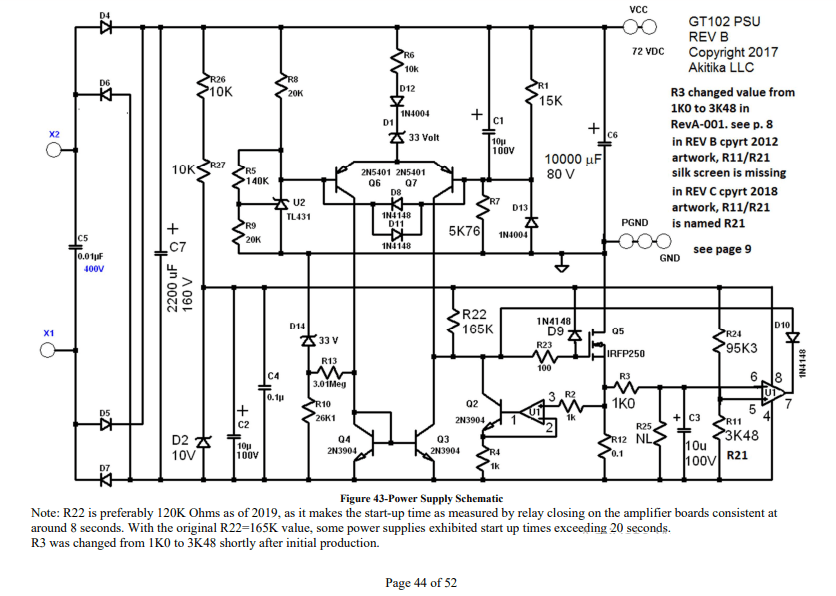

I was taking a look. Indeed, single supply and a tricky regulator (72V).Voltage regulated and single rail supply, cap coupled output. Looks nice.
Edit: notice how they used a small capacitor after the bridge (C7), and how the raw voltage is much larger than the regulated voltage, at idle (it will sag quite a bit under load). This works well, I've tried it. Smaller transformers sound better to me and this sort of regulator is well suited, with the large cap (C6) as close to the output stage as possible.
Active bridges are useful for reducing diode dissipation (and reducing dropout voltage) in Class A amps where current flows are high and continuous. For Class AB amps where quiescent current flows are rather low, the added benefit of lower thermal dissipation is not as important given the added complexity and cost of active bridges.
