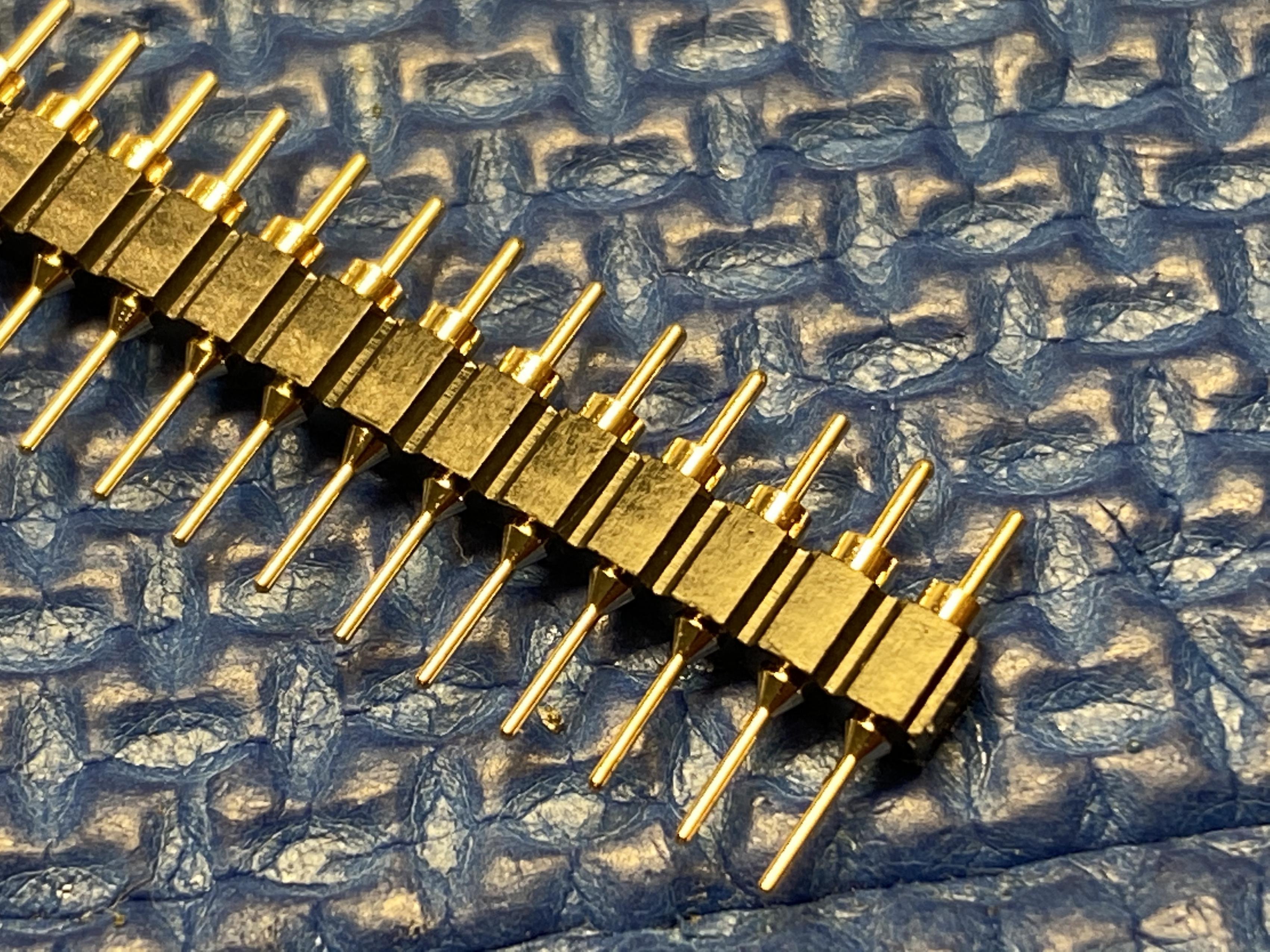

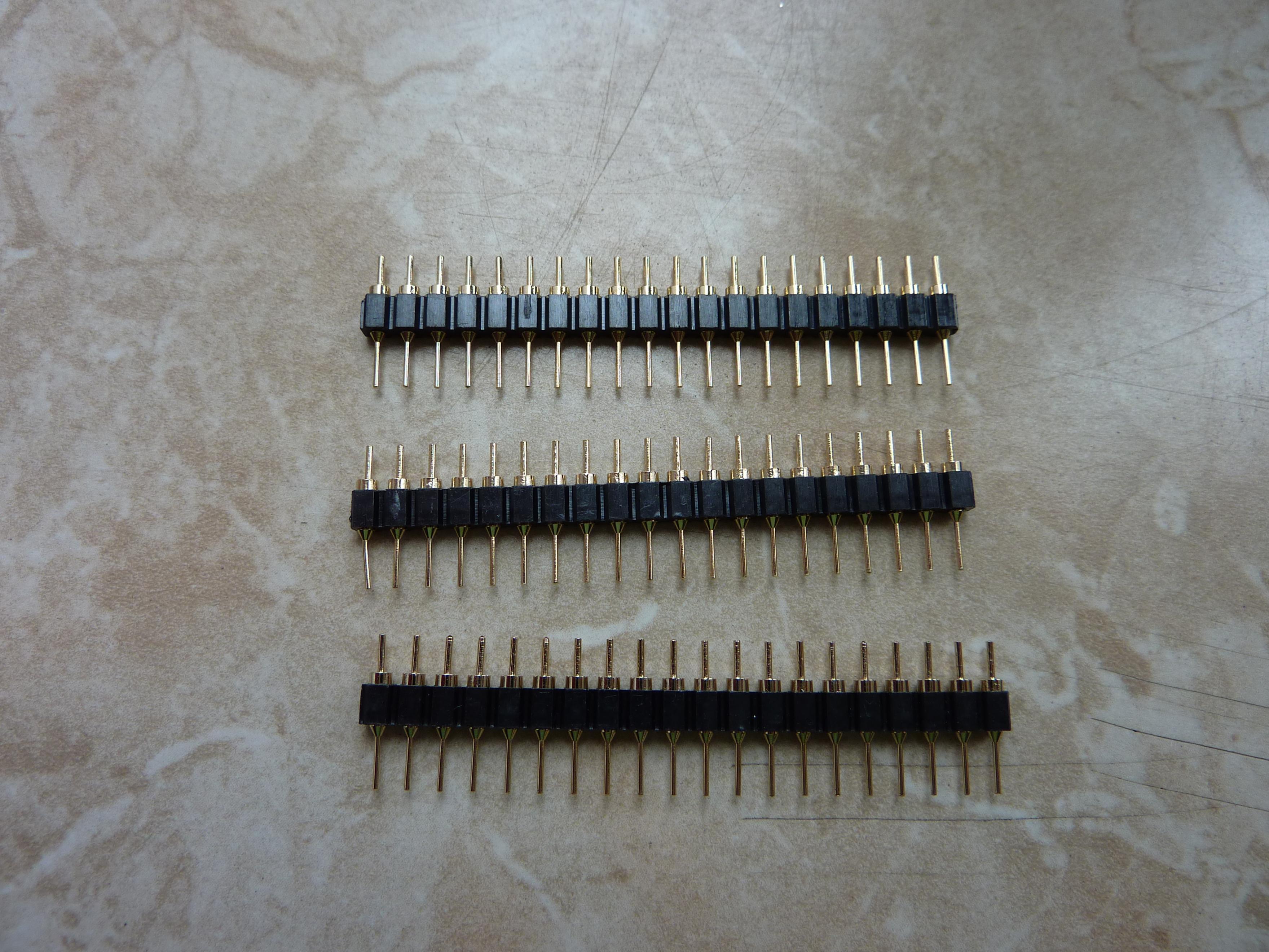

Hi Cardone,
Vitaly was referring to the pins that go into the DIP8 socket, not the adapter pcb.
Look closely at the picture you posted, those are square header pins and are to big to fit into a DIP8 socket. You need machined pins like these:

Hello Vunce,
that I have at home are not suitable ...
Will order the right one ....
Thank you....😉

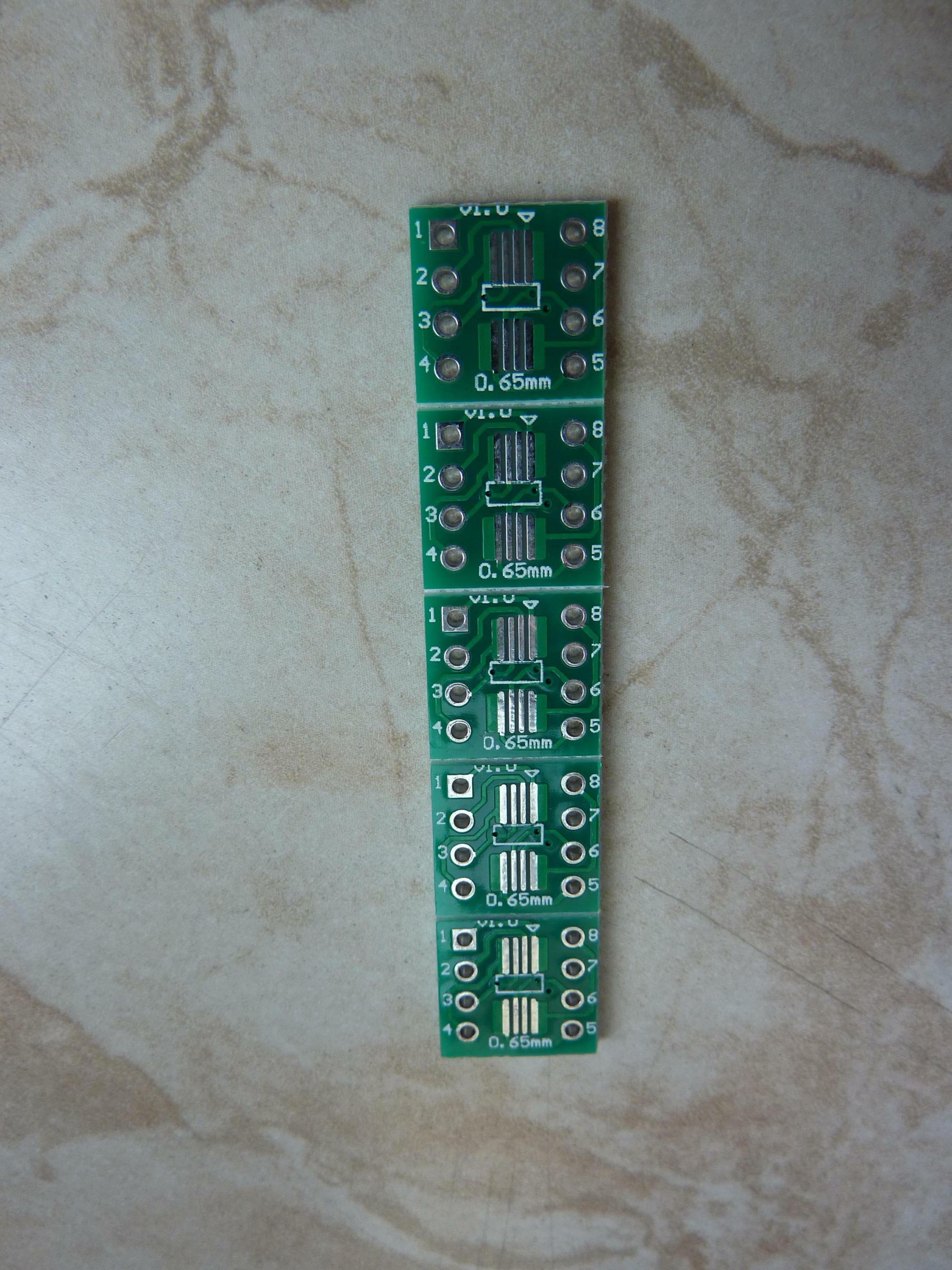

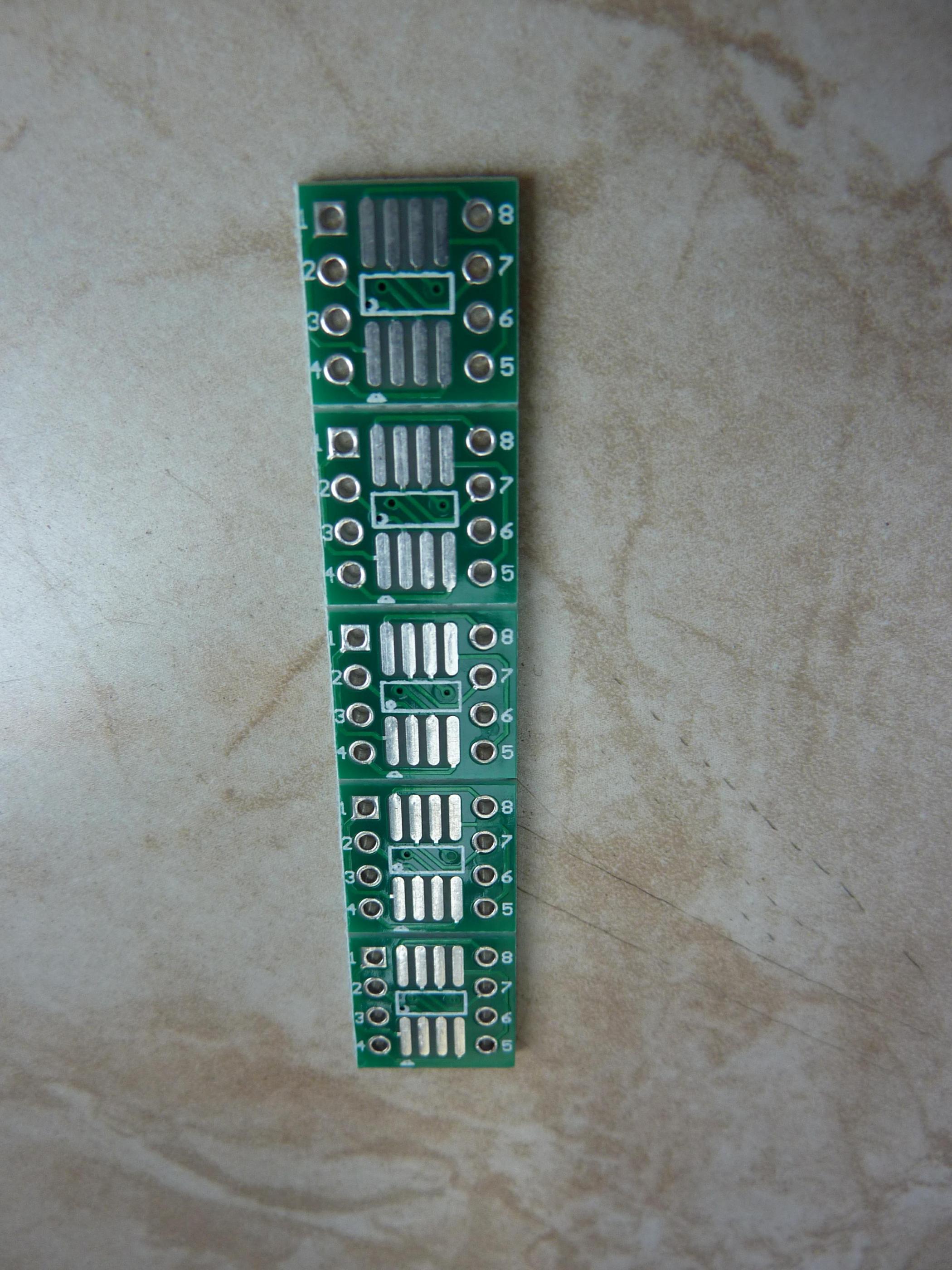

Cardone, did you find a link where you can also buy adapters at a low price and fast shipping?
I too bought adapters for SOIC and smaller opamps and the adapters came with square pins. I bought new DIP sockets that take square pins on ebay
like this

Nerone, yes I found them on Ebay and have already been sent ..
5x Adapterplatine SO8 1,27m SOP8 0,65mm Adapter auf DIP8 RM 2,54mm PCB Arduino | eBay

So the pins have just arrived ....
I exchanged the 627 for the 1656 ...
By swapping it, the bass has become less, but it has a clean treble, middle and bass ... At the moment the 1656 is my favorite ...🙂🙂
All parts are there now and just need to be soldered ...
Now I have time......😀😀
Thanks again to Vitaly and Vunce for pointing out the pins ....😉
