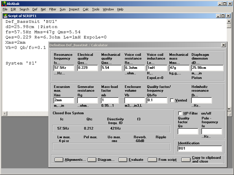

I have been going through this great tutorial and have been frustrated by Akabak's sometimes quirky operation.
Just trying to put in speaker parameters can be frustrating.
This one, for example:
Def_BassUnit 'BU1'
dD=25.98cm |Piston
fs=57.5Hz Mms=47g Qms=5.54
Qes=0.229 Re=6.3ohm Le=1mH ExpoLe=0
Xms=2mm
Vb=0 Qb/fo=0.1
It will not load. If I try to put the values into the wizard it will not accept Mms when I push 'Evaluate'. If I save to clipboard and close it lists Mms as '0'.
These values are for the Beyma 12MI100. I am getting the values from WinISD, which makes sure the values 'work'.
Any ideas what I am doing wrong? 🙁

Just a quick glance of the tutorial.........pg. 55: Mms is defined in Kg, so try inputting 0.047.
GM
GM
It worked.
So, this is a known bug? Every other box seems to work the way it is supposed to, and it says 'g' right under the box in question - why then does it not work?

As a general rule, if a field in a wizard has one or more unit names below it, you need to specify the unit if you want to use other than the default.
For the case in question:
1. Paste epa's def_bassunit into an Akabak script. Leave the cursor in the data.
2. Select Def_BassUnit (Ctrl-B)
3. Note that the "Mechanical Mass Mms..." field has "47g" in it, and the legend underneath says "kg,g,..."

Seeing that it specified 'g' as an alternate unit I did write 'g' after the '47'.
At any rate, I am going to try a couple of other drivers tomorrow and see what it does - but at this point it looks flaky to me.

Thanks for your reply Don. Love your tutorial - is in fact what I am using to learn the program. 🙂
I was sure I was doing something wrong as I said in post #46, but so far no one has been able to show me what that is.
Even now I am sitting here with the wizard populated and when I write in '47g' it does not accept it, and when I write in .047 it does accept it. All other values the same, paying particular attention to write '47g' as stated in the label below the box.
So I am trying a different driver - the Eminence Deltalite II 2512 - and I am getting the same results. Mms is 49g in this driver, and it will not accept '49g', but accepts '.049' just fine.
Really - no one else has this problem? I mean, I'm not going to cry about it if it's the only bug in the program, but it does seem quirky to me, no matter how you slice it.

... I was sure I was doing something wrong as I said in post #46, but so far no one has been able to show me what that is.
Well, I marked and copied the bassunit spec from post #46 and pasted it into a new AkAbak script. I put the cursor in it and pressed Ctrl-B. The wizard came up OK, and pressing "Evaluate" populated the solution boxes at the lower left.
I deleted and typed in "47g" and also tried "0.47". They both evaluated the same. See the attached screenshot and compare it very carefully with your screen.

I've just looked carefully myself. Vb should not be zero. Try specifying the enclosure volume.
I figured. 🙂... Oops, it was late at night, for "0.47" read "0.047".
Stranger and stranger....
Thanks for your investigations Don. I went back and copy/pasted the parameters listed in post 46 into a new script and hit Ctrl-B and sure enough it populated the Bass Unit Wizard with an Mms of "47g", accepting either '47g' or '.047'. Okay.
It is true that I hadn't written a Vb in post 46, however I had been trying it with and without Vb values in trying to get it to work. FYI, I settled on a Vb of 3L for a f3 of 199 Hz. The evaluation problem was there whether or not I entered a Vb.
Strange thing - that value does not work with the script generated in that fashion. With this script, it takes 4L for an f3 of 200 Hz. With a Vb of 3L this script gives an f3 of 214Hz. Also, if I go back to the Def-Bass Unit wizard and enter the values manually, it still will not accept '47g', but does accept '.047'. If I fill the wizard manually, 3L still gives an f3 of 199Hz - with all values appearing the same.
I am considering two possibilities at this point; Perhaps there is something wrong with my installation. Perhaps at some point when I was first playing with the program I screwed up some setting somewhere that is playing havoc with parameter entry. Or, perhaps there is something wrong with these numbers. Even though I got the numbers from WinISD, which is also famously finicky when entering T/S data, there is something about the numbers it just doesn't like, and is able to interpret the numbers somewhat differently depending on how they are entered.
Really though, I have no idea. 😱
OK, I tried it "manually" and saw the problem. It appears to want the Vas instead of the Mms value. I'll play with it some more in my "copious free time" (ha, ha). It is probably sensitive to the order in which the parameters are entered. It only occurs on manual entry, I found that if I do a def_driver and then do a def_bassunit with the cursor in the driver parameters it also works OK.
I doubt it will ever be fixed, it'll just have to be worked around. I suspect I haven't seen the problem because I try to work in one parameter space or the other - either all Thiele-Small or all electro-mechanical.
