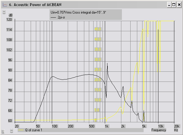

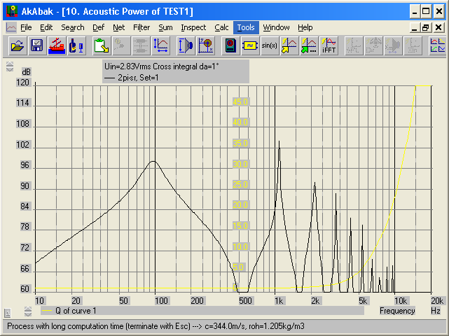

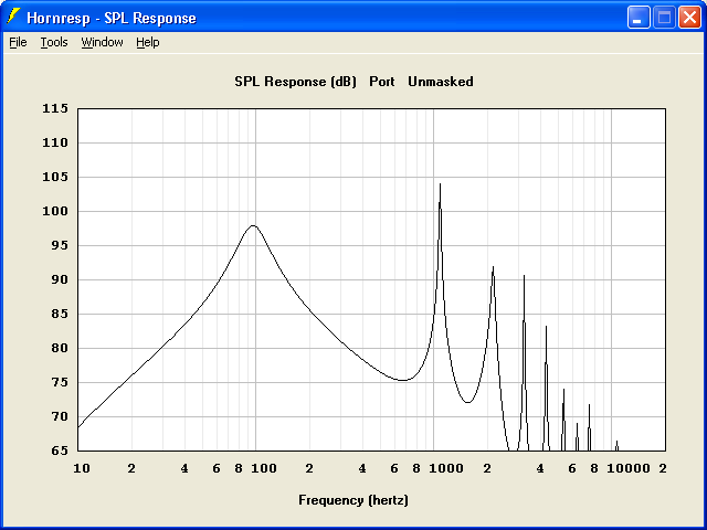

Hi Don,
I have been experimenting with the AkAbak enclosure element, but cannot get the same result for port output power as I get when using a duct plus inner end corrrection.
1. Hornresp_port.png shows the Hornresp result.
2. AkAbak-port1.png shows the AkAbak result using Hornresp exported data but with an inner end corrrection manually added to the AkAbak port duct element length.
3. AkAbak_port2.png shows the AkAbak result using an enclosure element.
4. Test1.txt shows the script I am using to generate AkAbak_port2.png.
I am hoping that you might be able to see where I am going wrong 🙂.
Thanks and kind regards,
David
Hi David,
Well, that is odd... I opened AkAbak, new script, pasted in the script you provided, and got the attached result. It does not look like your second image.
I'll see if I can work out what's happening.
(EDIT) Port power, not combined power. Hmmm...
(EDIT 2) OK, my mistake. I was viewing the sum power, not just that of the port. Selecting just the enclosure label to plot (or setting "NoRad" on the Radiator) gives the same result as yours. Now I am "on the same page", I'll get back to your original question.

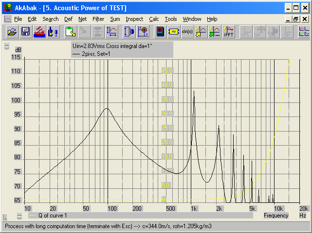

OK, I see the reason.
For the Enclosure element, you need to specify the keyword "Long".
For a normal vented enclosure, AkAbak assumes that the driver and port are mounted on the same surface with no distance between them, and that the Enclosure Length parameter refers to the distance between the driver and the back wall of the enclosure. (Imagine the vent being mounted coaxially, coming through the centre of the driver.)
Specifying "Long" puts (Enclosure Length) distance between the vent and the driver. This is illustrated on page 171 of the AkAbak manual, figs 93 and 94.
This shows up a problem when simulating a vented enclosure using an Enclosure -> Duct -> Radiator. Specifying "Long" does not work, the parameter is ignored. Your method of using two Ducts allows the "length" of the enclosure to be included.
In real life, we're probably worrying too much. The simulation differences show up at frequencies where the one-dimensional model breaks down - where the wavelengths are no longer long compared to the element dimensions. Nevertheless, it reinforces the requirement to model as accurately as the bandwidth requires. I now see why you don't intend to change the AkAbak export model. 🙂

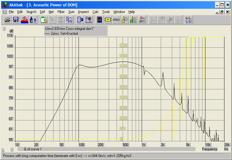

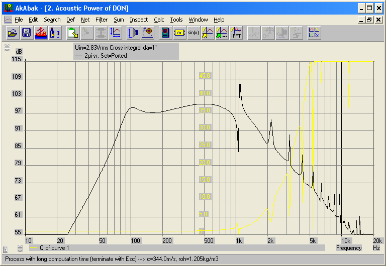

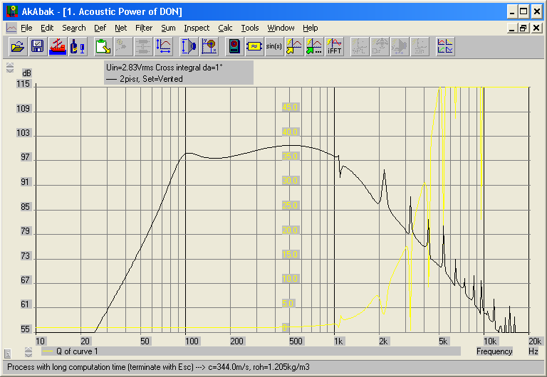

For reference, here is the model I used. It contains 3 systems:
1: The model you posted.
2: The same model with the vent modelled by a Duct instead of as part of the Enclosure.
3: Your original model as currently exported by Hornresp.
Select labels 1, 11, and 21 in Sum -> Acoustic Power...

Hi Don,
I tried that earlier myself, but for some reason it didn't make any difference - I must have put it in the wrong place initially 🙂.
Many thanks for clearing up the mystery for me!

Hi Don,
Correct.
By including the inner unflanged end correction in the exported script, the Hornresp and AkAbak power response results become the same. I think that I will probably now make this change in Hornresp, for the sake of consistency.
The specified port length actually includes an inner end correction of 2.191 cm.
In the "Vented" system model where an enclosure element is used, the total port length (including inner and outer end corrections) is calculated based on the given Helmholtz resonance frequency. The specified value of Lpt is not considered.
In the "Ducted" system model where two ducts are used, the value of Lpt includes the necessary inner end correction (4 cm + 2.191 cm). The outer end correction comes from the port tube radiator element.
In the "Ported" system model where a closed enclosure (no fb value specified) and separate duct both share a common driving diaphragm, the results are different, as expected. The "Long" keyword is not applicable with this configuration because the enclosure is closed.
Kind regards,

Hi David,
I'm often in the same situation, having to make adjustments in interfaces between programs that were not originally designed to work together.
Ah, another "Doh!" moment. I missed that. (Although, when specifying a vented Enclosure in AkAbak, it will accept either the port length or the enclosure Helmholtz frequency.)
I still feel I'm missing something. It can't be my marbles, every morning I look in my toybox and there they are... I'll think about it some more.
... By including the inner unflanged end correction in the exported script, the Hornresp and AkAbak power response results become the same. I think that I will probably now make this change in Hornresp, for the sake of consistency. ...
... In the "Vented" system model where an enclosure element is used, the total port length (including inner and outer end corrections) is calculated based on the given Helmholtz resonance frequency. The specified value of Lpt is not considered. ...
Hi Don,
When the port length is specified, no automatic end-correction takes place - it has to be manually added to the physical length by the user, similar to a Duct.
