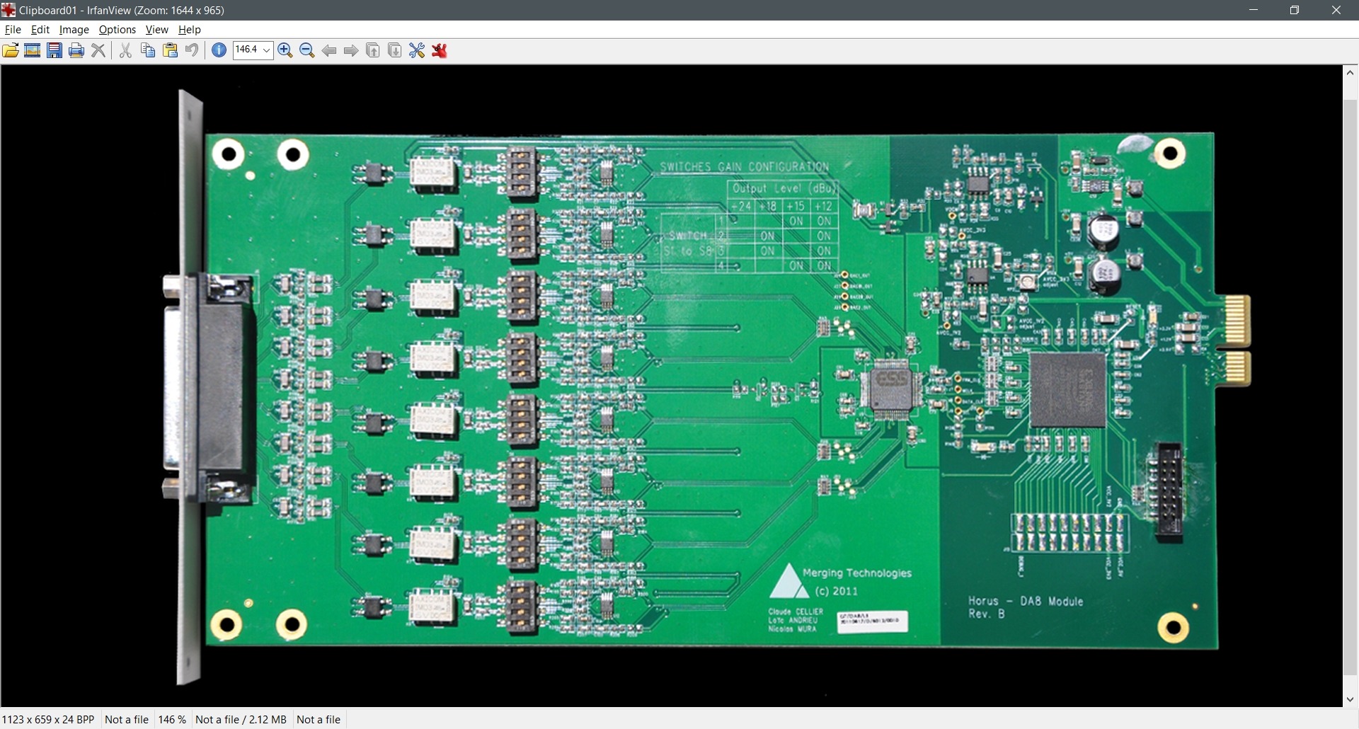

Another interesting ESS implementation is the DAC board that can be seen at: https://www.merging.com/products/interfaces/option-cards
Seems to me both OktoDAC and the Horus dac board share something in common: The output stage opamps are more far away from the dac chip than most designs I have seen 🙂
A expanded pic of the Horus board attached.
I know about Horus, but it is outside my budget.

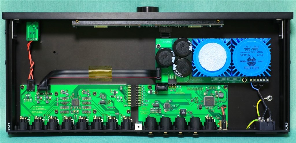

Below the internals of OktoDAC. Not sure whether this is the latest version, probably latest version has two caps instead of three. It has the ES9028PRO DAC chip and uses opamps on output (OP1612 or so, I do not remember). Not sure about the clock solution used, perhaps it falls a bit short on this. I care about very low jitter. OktoDAC is still available, though only in small batches from time to time. It was still orderable a few weeks ago...

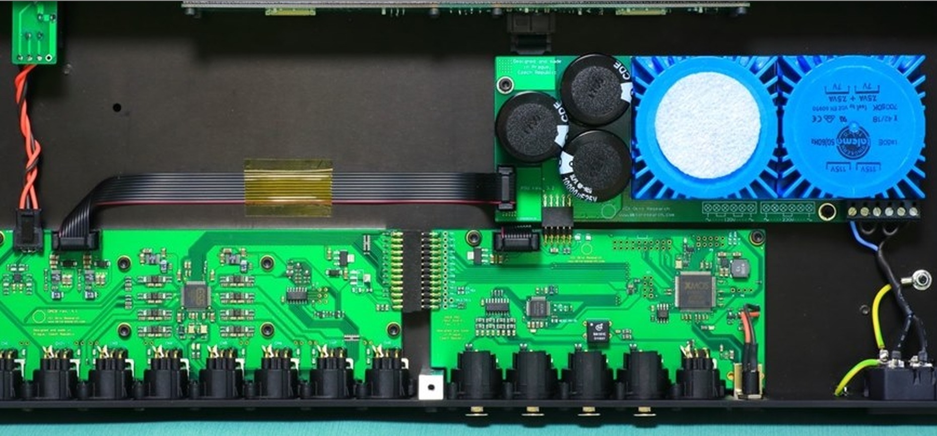

Good. Not quite as I remembered, but helpful to have. A slightly blown up version of the same pic below.
Looks like it has USB in, and what looks like they might be some AES inputs. Hard to tell from the pic but looks like they might be using two NDK SDA clocks? Otherwise the output stage kinda looks pretty straightforward with only I/V conversion and no other active filtering (unless something is hidden under the XLR connectors). Does anyone know for sure the exact architecture and or have a high res pic?
Anyway, if something like this would suit your needs (not sure if you need AES inputs), then it doesn't look too complex.

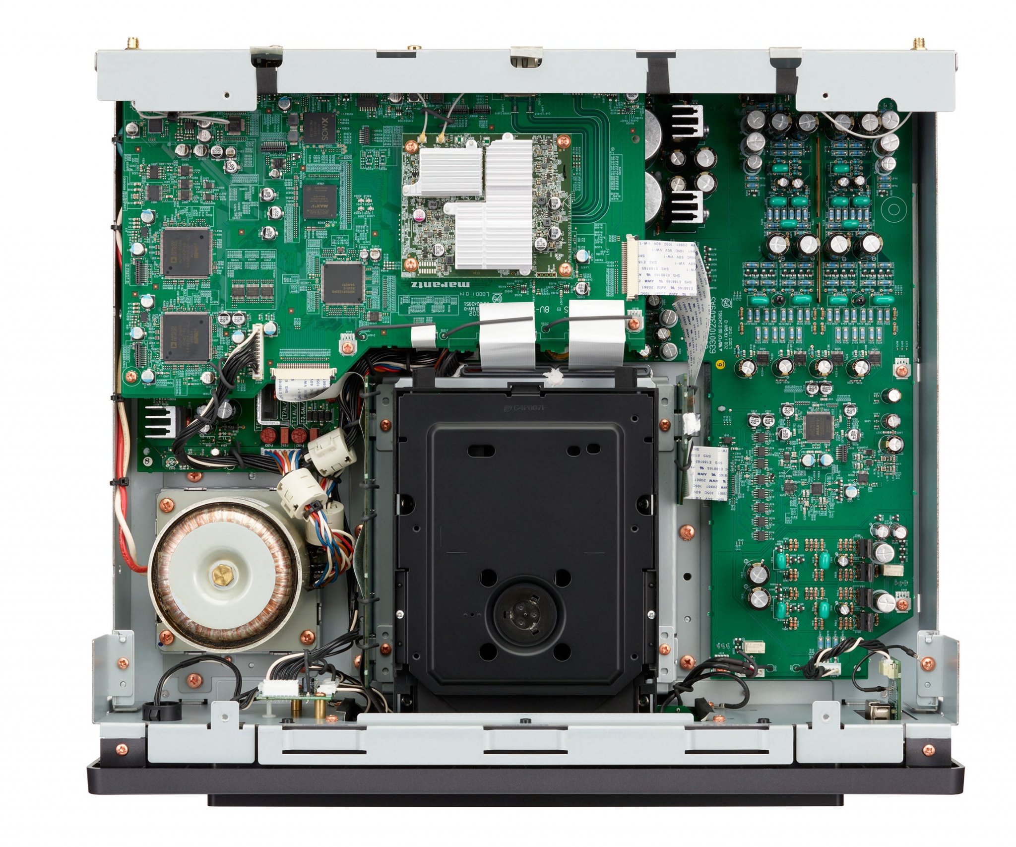

this DAC SACD player is something I really want to hear.
made by engineers of Marantz who used to be Marantz Phillips and who also know analog super well.
im pretty much almost done with DAC companies who don’t know analog well.
