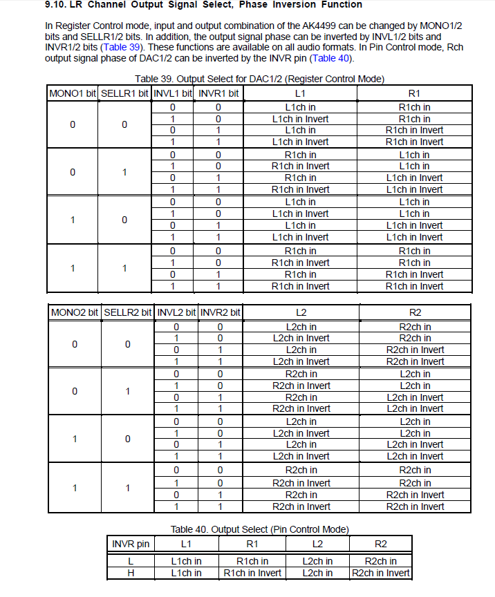

Just in the process of laying out a prototype board for the AK4499 & trying to decide how to configure the outputs.
AKM only show two options.
DAC registry’s configured for mono & all four channels wired in parallel after the I/V stages.
Or with two left & 2 right channel output stages.
I only want to use it in stereo with 2 channel output so what do you think would be the best way to do it?
1. Just use one DAC section leaving the other one unconnected?
2. Use the whole DAC & combine the 2 left & 2 right.
If using option 2 I guess I just parallel the 2 x L & 2 x R after the I/V stages - sound ok?
I was thinking of a third option by possible passively combining each pair of outputs &
then a common I/V stage - a few small value series output resistors to help current sharing.
Anyway just wanted to bounce it of you guys & see what you think.

I would build the reference schematic of Fig. 83 of the datasheet, splitting it in half so that the top two outputs get combined into one channel and the lower two channels get combined into the second channel. Then I'd set (in software) the top two channels as Left and the bottom two as Right channel.
Thanks Dimdim - sounds like a good plan.
So you think there will definitely be options in the registry to set those channel combining options?

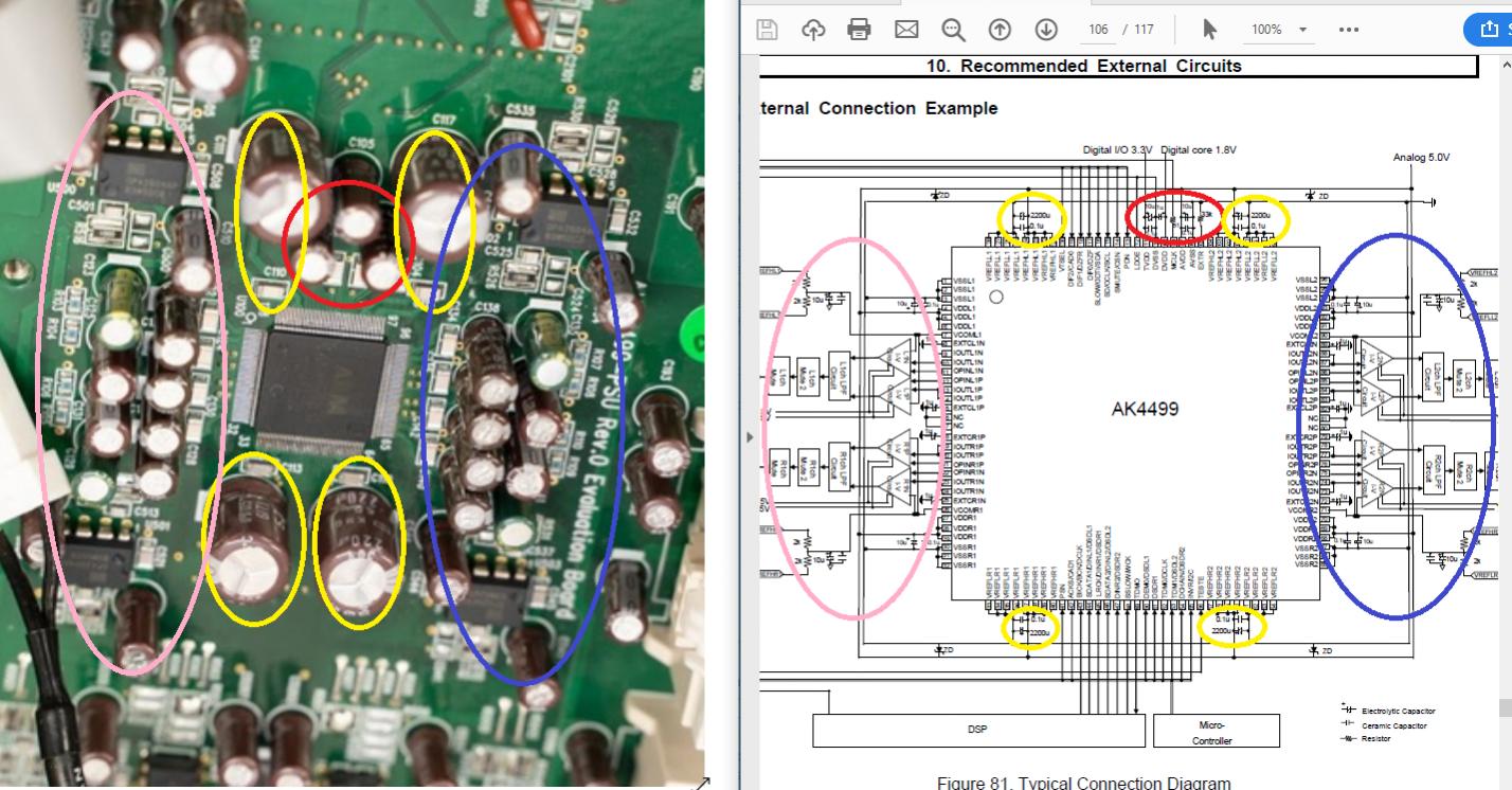

It is interesting that in the data sheet they show 2200uf for the VREF cap but on the Eval board schematic it shows 2 x 220uf & in the photo of the Eval board it looks like a single 470uf is used. It is obviously a critical area & they tried various options. Also on the Eval board schematic there are 10 ohm resistors is series with the VREF pins on the chip. Any ideas on those?
There's a bit about it on page 108 of:
https://www.akm.com/file.jsp?id=600977
from gentlevoice's post 55 above (Thanks!), section '10.3. Reference Voltage'. Not sure if that entirely answers your question, but it does look like it was an issue that caused them some grief.
