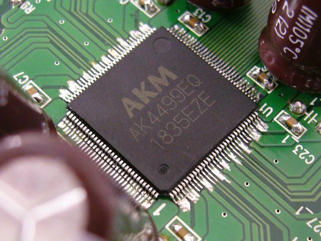

Did you see the power supply they built & the decoupling around that AK4499?
Have a look (attached), and then add a third "blah" to your comment. Post it so that everyone can see.
Indeed. That was a nice article. It's very interesting to see what the reference designs actually look like.
It's looking like they are using 8 individual power supplies. It's making my 8 power supply dual 4490 look "normal".

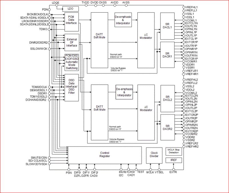

from the datasheet
>SR DAC Convert multi bit output of ΔΣ Modulator into analog signal. This block consists
of a switched resistor DAC
4499 output is not current source... So what is the IREF for? may be for calibrating full scale output current, like sabre, rough chip to chip full scale level tolerance?

Hi all,
This looks interesting .. to this end: Has any of you found out/sorted out whether the output is low or high impedance (and if so what is the output impedance)?

Not sure the real datasheet is out yet. Probably will be just like the ESS - low for a current source.
Hi ...
I actually think there is a real "preliminary" datasheet out by now but I don't know how publicly available it is supposed to be. Anyway I have asked the Danish distributor if he may help with e.g. the output impedance value and hope that he will get back in not too long.

Jesper,
I think those details are already available.
Each DAC OP = 64 ohms. The analog supplies are 5V, so needless to say, there's a lot of current swing to deal with. 🙂
