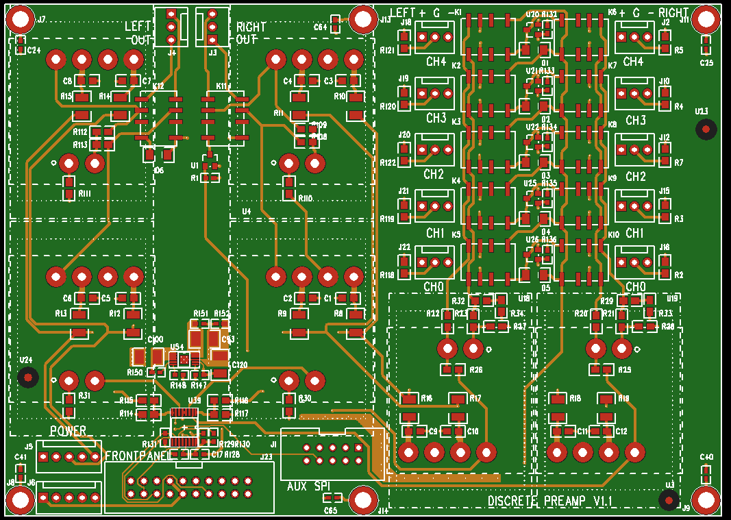

Preamp V1.1 Board for gain modules ready.
Looking forward to see what comes of this project.
