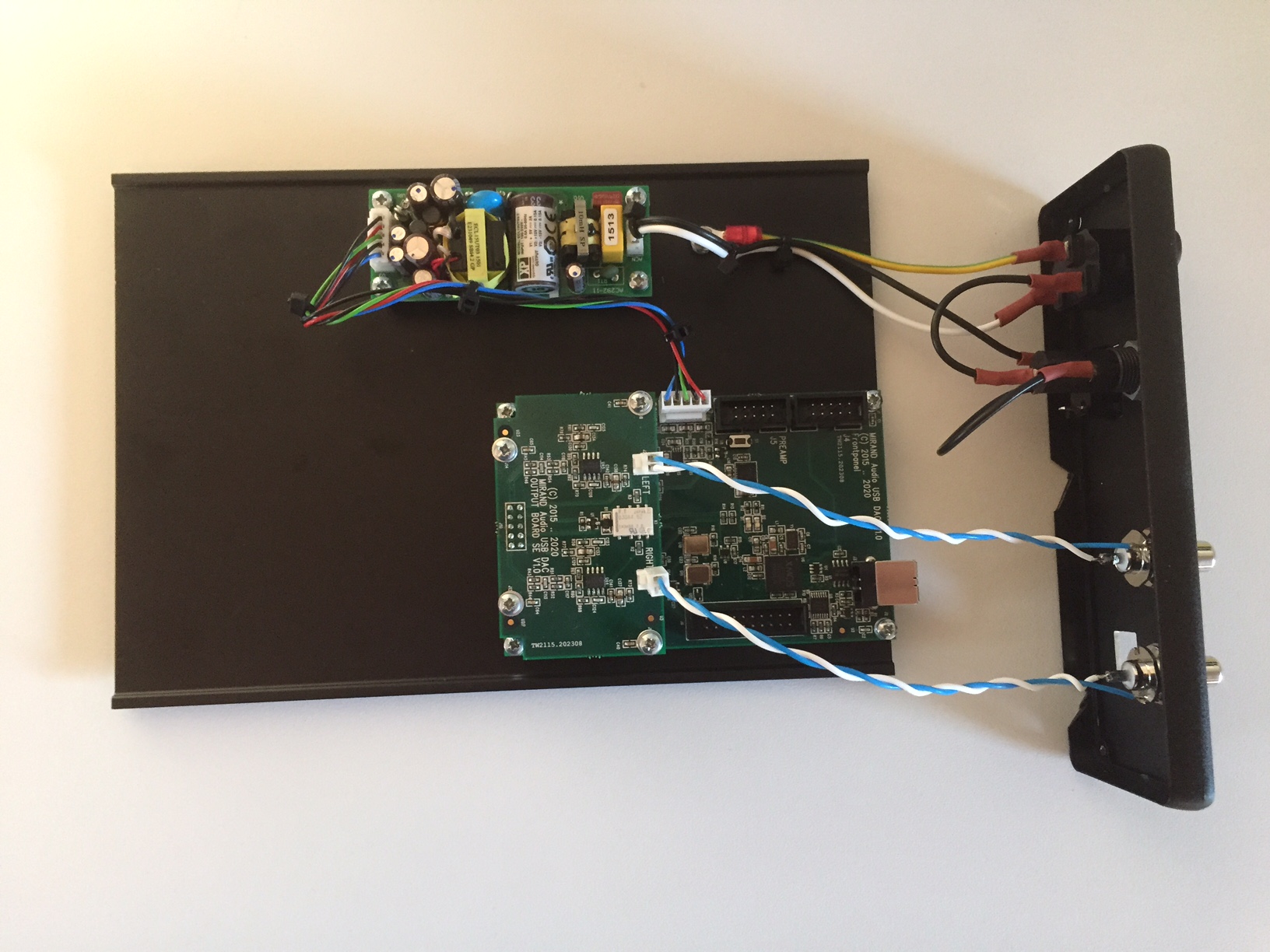

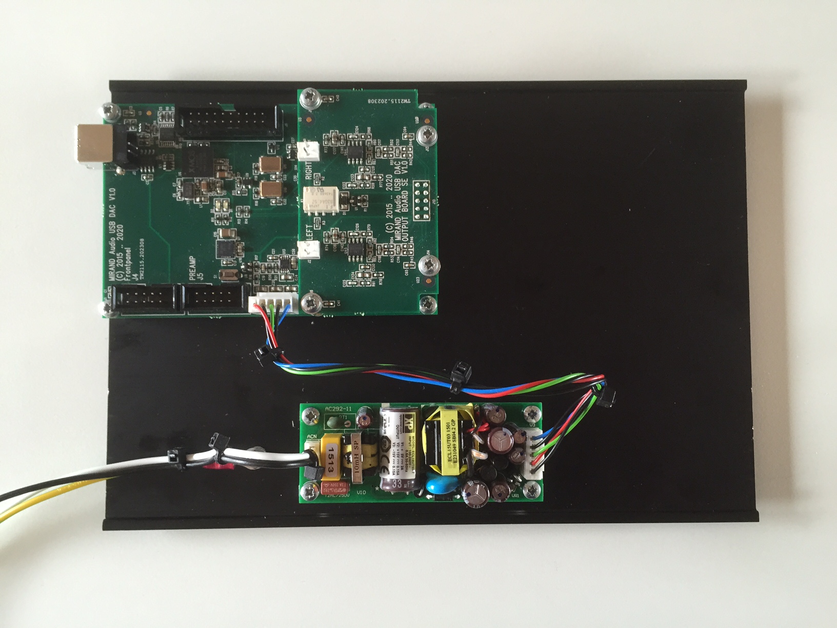

Hi Sonny, Looks really neat I am eagerly looking forward to hearing it (that's was huge understatement! Very grateful to you for assembling it for me when I couldn't do it myself due to health. THANKS a lot and all the best, PerHi, Pdb has purchased an assembled variant of the DAC from me.
I have attached a picture series how it could be done.
BR
Sonny
