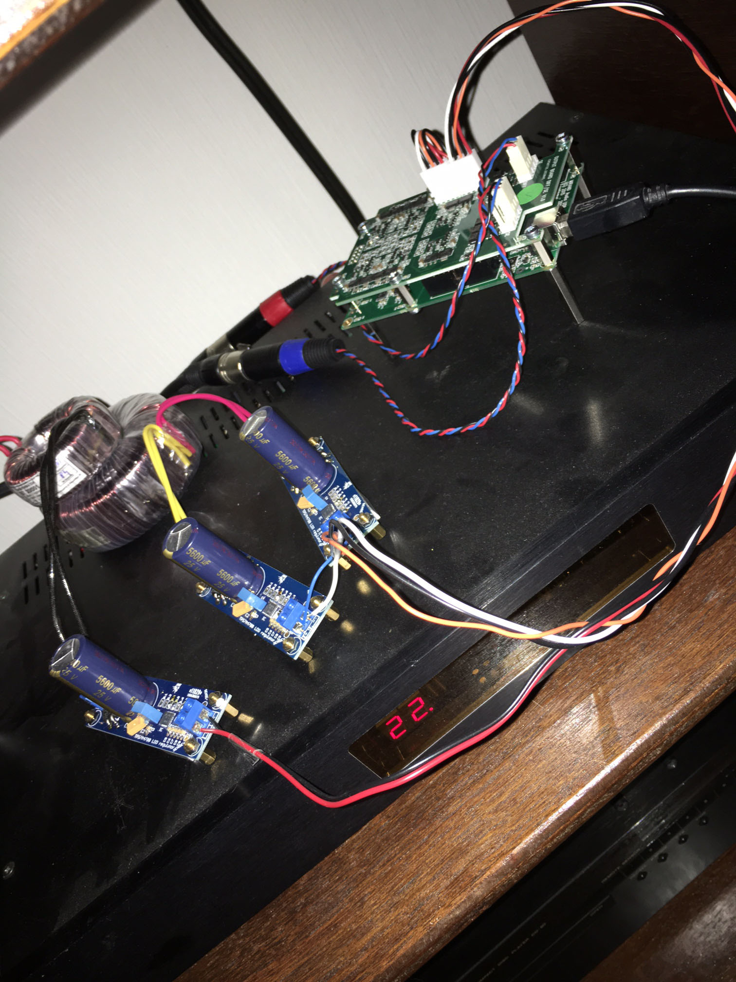

Hi, do the DAC need some sort of USB power from the PC or it's completely stand alone??
