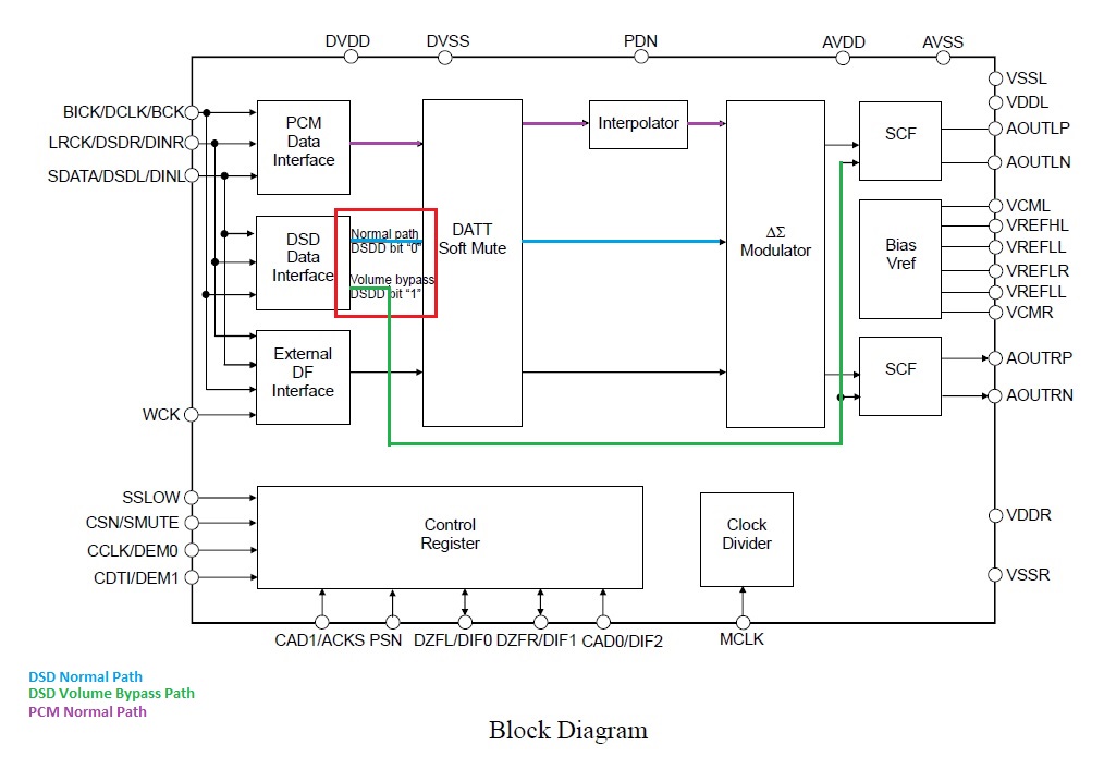

...we bypass as much as possible in the DSD mode. (It is not possible to bypass Volume control in PCM in the AK4490)
Does this mean that PCM playback suffers or is lacking compared to DSD playback? 😕 In an earlier post you also showed THD - but only with a DSD signal. For many though, it will still mostly be PCM material playing through the dac I think - also in the years to come. 🙂 BTW will it be possible to attenuate the PCM signal in the digital domain when playing 16 or 24 bit (out of 32 bit)?
In reality, yes PCM lacks in performance compared to the DSD.
PCM Data path goes through Digital attenuator, Interpolator, Delta sigma modulator and Switched capacitor filter.
DSD normal path goes through Digital attenuator, Delta sigma modulator and Switched capacitor filter.
DSD volume bypass path goes only through Switched capacitor filter.
I am working on a firmware where the mixer is enabled. This way when you change a setting in windows software (example: Jriver), MAC OS/X (Volume up and down you can set with the keyboard) and also Volumio it will set the value in the digital attenuator.
Besides of that i will shortly release a Shield where the USB interface controls an MAS6116 in balanced configuration. This shield will have single ended output as well as balanced output. I am working on it today.
You will see the same distortion for PCM as well.
But take a look at my post below.
It does not perform worse at all. Gain is set to 0dB meaning the digital attenuator is transparant. I have put a lot of Work into use of good isolation of the voltageregulators that ultra low noise and ultra high psrr.
