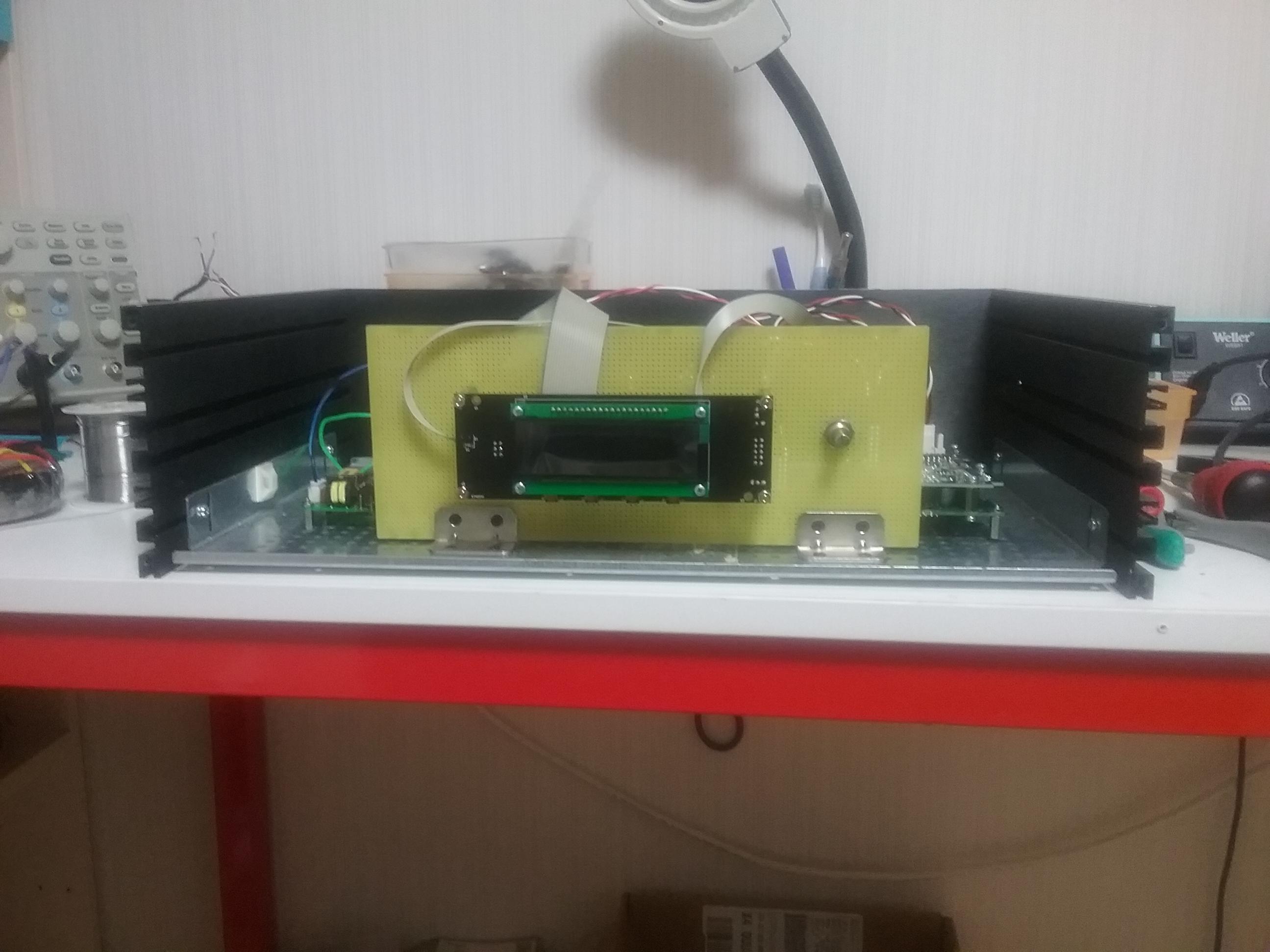

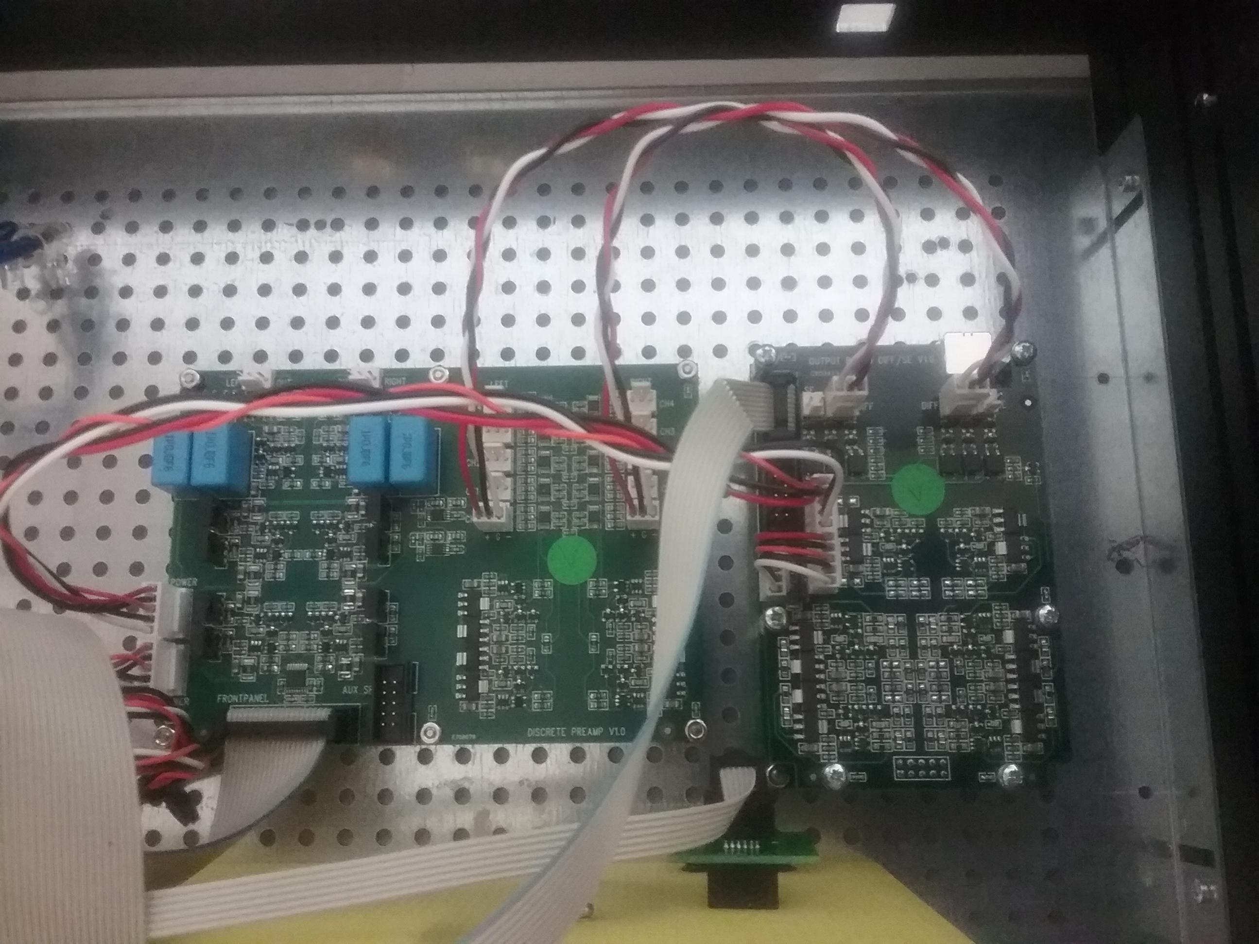

Hi Sonny,
finally I can the package today. I just completed to assemble the boards with the SMPS.
I can't get the display light up. If I understand correctly the schematic the J6 is not required when the flat cable is connected to the dac.
Any advise? Attached are the pictures of the arrangement that is as per the picture that you post some time ago using the cables that was in the box...
Thanks for your help and Regards,
Enrico

Forget to mention that I measured the +5V and the +/- 15V at the connectors up to dac abd to the J6 in the fronpanel as well

Hello Enrico.
Disconnect the DAC from the frontpanel and try again.
But could you please email me at mail at mirand-audio.dk?
Then i would happily help you solving the problem.
BR
Sonny
