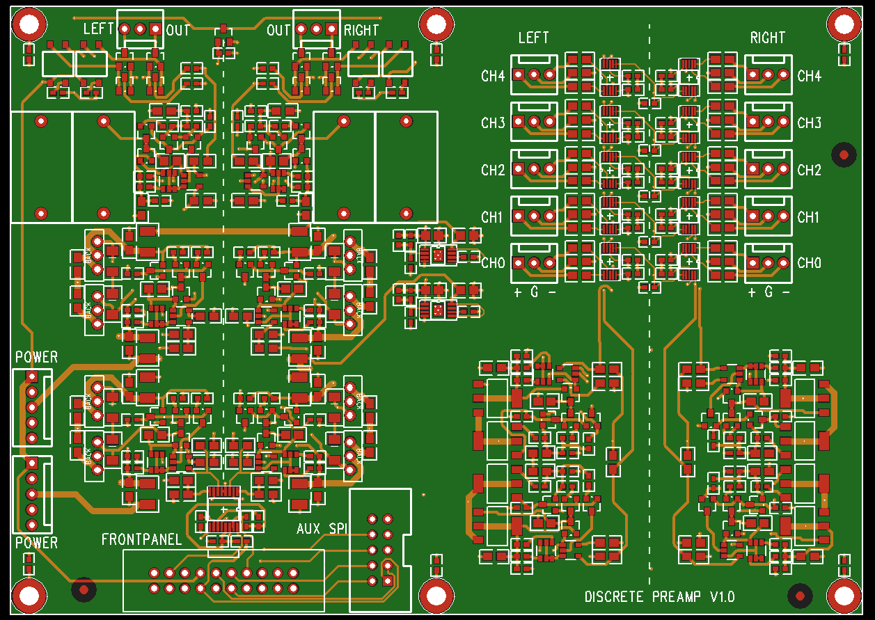

Discrete Preamp to be used with DAC and Frontpanel.
Just to give you all an teaser. I will of course make an seperate thread for the Discrete preamp but here is an picture of the PCB.
The board has servo but also in this case we have decided to use an discrete approach. The servo can pull the output with +/-20mV. It is mainly the JFET vgs mismatch that sets the limit here.
The price for this board is 389€. To get it functioning it needs the frontpanel and +5.5V,+15V and -15V supply
- Discrete Servo
- JFET input discrete opamps
- R2R DAC 16 bit.
- +12dB Gain
- 5 channel DIFF/SE input
- Balanced output.
- No relays, only MOSFET switches.
- All stages runs in class A.
- Small size : 140x100mm

I may have made some misleading here.
The Preamp has build in volume control. It is based on an R2R DAC. The R2R attenuator is based on the DAC8812 from TI using discrete opamps.
It is in the same manner as for example Mark Levison has done it.
The Preamp board can be used with the frontpanel only and with the AK4490 USB DAC where the frontpanel can select 1 of 4 different digital filters.
I hope it clarifies some points here.
