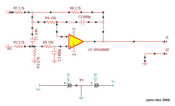

I don't know anything about the EMU 0404 USB. But I really do not like the idea of connectiong the computer to the stereo. Computers are a noise-nightmare.
If you do connect, galvanic isolation would be wanted. But almost any USB DAC/Soundcare do not have this feature, and will result in noise entering the stereo. This could very well lead to the symptoms that you mention.
About the 2 different schematics in the AKM datasheet. No, the 2nd one is not better. I just gives you balanced output to. But it is still an op-amp, follow by another op-amp. Not that good.
You could get OK results from trying different op-amps. But it's still an op-amp and sounds just like it.
I would go for a discrete analog stage using NO negative feedback.
If you do choose an op-amp, my suggestion is the old fashion NE5534. If you can get the "A" version it's even better.
I have seen many people change from NE5534 (5532) to newer and "better" devices, only because of the better specifications in the datasheet. People who actually run a blind-listening-test, tend to go for the NE5534. For an op-amp it's not that bad, and sonically it will run down most of these new "racing-op-amps".
I have to disagree totally. The newer National chip improvement is stunning. Granted, some drop in without checking compensation, power supply etc. so the results are worse. I mention this because I am not a fan of making chips designed to drive a buffer try and drive cables. The "softer" sound is your high end falling off a cliff. The OP is looking for a diff-output. Might I suggest a simple THAT driver rather than an op-amp?

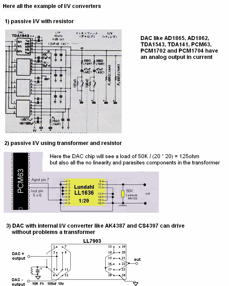

Another idea is to use a pair of transformers. Jensen maybe.
Some sound cards have a TOSLINK output. This eliminates any fear that some magic is traveling through a USB to the output. Mine has a PCM coax as well. If not, one can convert USB to fiber at the PC with an external box. Same result. Never seen a ground loop get past fiber!
The LM4562 is nothing so stunning. There's better around: LME49720HA (notice the HA bit), and, even better, the OPA1612.I have to disagree totally. The newer National chip improvement is stunning.
The LM4562NA was a mediocre sounding opamp for me. I prefer the cheaper LME49723.
For the AK4396 specifically, BTW, the LT1357 would be a really nice match. My bet.
Otherwise, the LT1028ACN8 would be a great match as well. My bet.

Hey all, I'm pretty new at this so bear with me here.
Wanted to share my little success story connecting a pair of ll1684's to my sound card that uses the ak4396 dac (b-enspirer), and replacing some of the caps in the process. Sounds fantastic! On par with my transporter, which I plan on moving the transformers to.
I do have a few questions and was hoping someone could help me out a bit.
The diagram kevin@k&k sent me called for a 40k resistor in parallel at the outputs, which I have not installed. Nor have I grouned the transformer or rca's , as I couldn't located the ground on the board.
Any potential pitfalls I may run into by not connecting the resistor or ground?
In case anyone else is interested, here's how I've got it hooked up.
