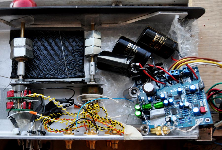

hi Scot,
thanks for your contributions. i run a heavy modded AK4396 kit from eBay with ne5532 as output stage. the signal goes RCA via a stepped 20k shunt attenuator to the 100k-imp SS power amp.
i did this simple test using 2uf 400v Audycap mpk. the 3d was excellent to be on the pair Aureus! but no dynamic and bass!
is there any better "direct out" configuration that you run? with the - output legs as well?
best regards

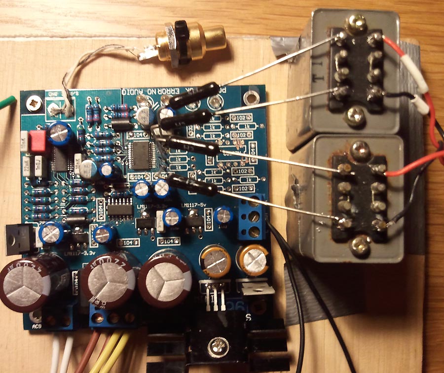

i'm tying to put together my dac kit and a pair of TAM output transformer from eBay. but i got a terrible noise as well!
i checked everything including direct sound from the chip. it is healthy.
could some of the masters tell me please what can be wrong?

Hi Nosian,
Did you find why it doesn't work ?
the reason I guess as photos show there is plenty of rust around the terminals on the top of both transformers. have they been in a balcony somehow under the tropical rain? or in a watery basement? so the water has damaged the core and/or winding of transformers?
I sent it back to the seller and got the money back. good boy!
best regards

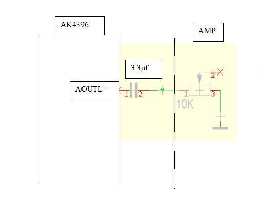

Direct, the mood I finally made it!
My first try to get Ak4396 kit work in direct mood was a failure. But I keep trying by working on the volume control as Sandller advice. It is a shunt attenuator with 10k shunt resistor parallel. I replaced it with a 2.4k carbon foil same value from AK4396 datasheet. And it made the trix.

Ah that seems like a tube guy into DACs 😉 Please keep stuff small in a DAC and either use shielded wire or twist both wires as you created nice antennas now. Keeping it tidy and small might make a better investment than material choice/parts choice.
http://www.diyaudio.com/forums/chip-amps/16988-wires-twist.html
thank you jean-paul. it's only my second project! and i put this dac-board into my passive pre-amp. the twisting thread made me more twisted! would you point out what is exactly wrong in this case and what should be done? thanx in advance.
Get the last missing components... fire up and ...only some noises !
These TAMradio transfos from Ebay are dead !

#203:
Nosian: you have to connect mid point of the primary tranformer's part to the 2.5V!
You'll need two equal resistors (to the ground and to +5V), 2.4...2.7K. And capacitor to the ground.
Secondary wire of transformer: black wire -> to the ground.

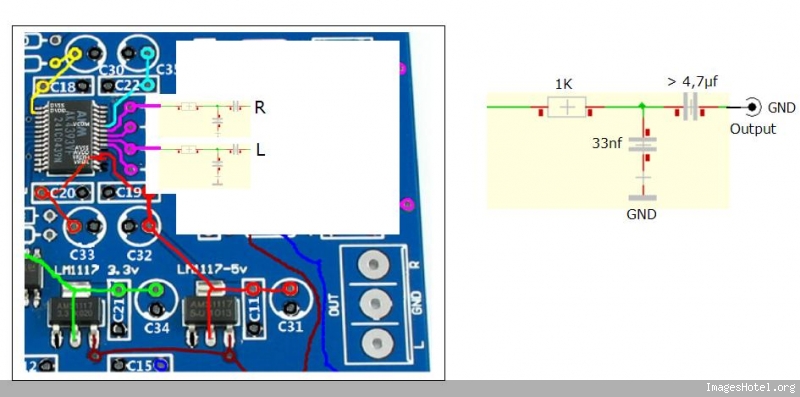

You can see on the picture the circuit .
Do we need to put a resistor between the AK output and the capacitor ?
Is there a solution for a discret output stage ?
Serge
Only one that I have seen that uses the balanced output of the DAC to get the full CMMR needed to meet the DAC chip specs is from Ray's Audio:
Passive output stage ( see the picture )
There is a mistake on the picture it's not 33nf but 3.3nf
The passive output stage is a good solution but FOR ME not for the bass .
So i did follow the passive stage with a OPA1641 !!!
and i added a bass boost < 100hz .......
Serge
