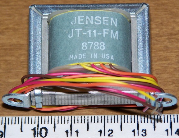

Jensen JT-11 FMCF
I had some Sowter multi tapped transformers on my AK4395 chips in the past and found that I liked the Dayton foil caps better but have been convinced to try transformers again so I bought some Jensen JT-11-FMCF. I will use these direct out with the DEQ2496 running the 4395 and I also ordered a big dac board with DIR9001/CS43122 to join in the chip comparing fun. Jensen doesn't seem to have a spec sheet for the 80% nickel FMCF but the distortion should be closer to the larger 80% EMCF than the FLCF which is the same size but wound on a 50% core to get the price down to $35.
http://www.jensen-transformers.com/datashts/11emcf.pdf
http://www.jensen-transformers.com/datashts/11flcf.pdf

I got my Jensen JT-11 FMCF transformers installed in my modified DEQ2496. The primaries are wired up balanced to the direct outputs of the AK4395 through 20 ohms of my favorite Yageo metal film resistors per leg. I would have used something smaller but that was the lowest value I had on hand of the metal film resisters. No additional load or filters. The AK4395 V out is already well filtered and doesn't need it. The resistors are connected to the same wires at the input of the caps with the trannies mounted outside of the case with their own output connectors wired up single ended with the orange wire grounded inside at the pin 1 that the caps are using. My cables take signal from pin 2 with pin 3 left open even though both legs are available through the caps if wanted for my balanced/ bridged 3875 amps. I currently use my modified Sure 2X100 amps which are single ended and when running a minimal output coil and big SMPS offer by far the best sound I have ever had home.
These are very good transformers. Loss seems to be about only .5-1db compared to the caps. They sound much better than the Sowter multi-tapped volume control transformers that I had tried a few years ago. The Jensens are very close to a good cap. When using the demanding load of my 4k series/ switched shunt stepped attenuators on the inputs of the amps, the balanced in transformers offer a nice full bodied and plump bass compared to a single leg of the dac output through 3uf stacks of Dayton foil caps. The caps sounding a little tighter and lower in level. With the attenuators gone leaving a 20k termination at the amps and using only -.5db digital volume control for the caps, -6.0db for the transformers to match the levels, The advantage in the bass is reduced to a non issue. Still different but more of a toss up of preference between a full bodied plump sound versus the tighter, quicker bass of the caps. From the midbass up the Dayton foil caps really shine. They present with a blacker background with less overhang. On Tattoo from the Janis Ian live cd, the steel guitar at 1:50 is placed much deeper in a blacker sound stage with the caps. The vocals are nicely fleshed out and lacking of additional sibilance with the transformers but the excellent large drums sound slightly filtered. The caps reveal the striking attack and sense of a vibrating membrane much better. The cap's advantage in micro dynamics is even more noticeable on San Andreas fault live where The transformers tend to sound a bit muffled in comparison with more overhang smearing up the presentation slightly. The power and accuracy of Natalie Merchant's voice and attack of the instruments are more engaging through the caps and the crowd sounds go back much deeper and cleaner. On Babylon Sisters, the faint noodling of the left guitar is easy to hear through the transformers but the backing vocals at 1:14 are more separate and distinct with the caps. You get the idea. I like the caps. For the mids and highs of a DCX, a $2 Dayton foil cap is a no brainer compared to spending a fortune on multiple channels of transformers. When increasing the value of the caps to get enough for the bass channel, the price advantage is less, especially if you need balanced which raises the required caps to $24. For full range in a dac with the AK4395/96 the caps will sound more dynamic and revealing.
Next up will be the CS43122 on a big dac board which may need a filter and the extra 6db so I will try the transformers again on that one.
