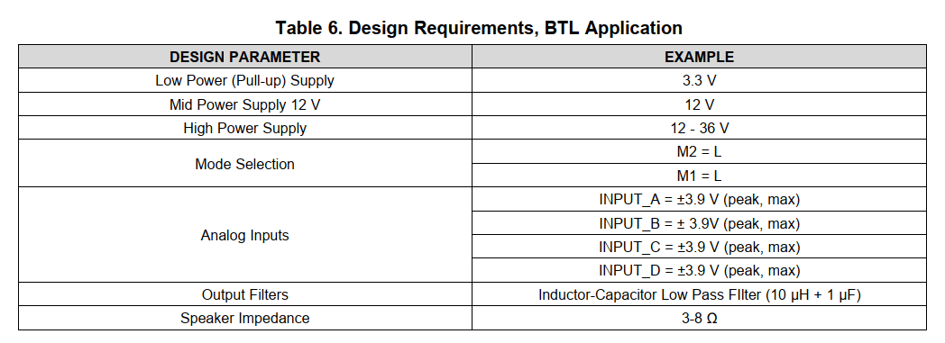

Input volume limit is +-3.9V, so 12V (+-6) power rail is enoughI didn't read all previous pages, but I think no one mentioned a really crucial point with the 04. The opamps are originally fed with an 78M12 voltage stab IC, where the supply voltage (12V) is then halved by a divider, so the IC is actually fed with +/- 6V DC supply voltage.
Most opamps perform miserably with such low voltages, so I hooked an LM317LZ at the input of the M12 to feed the Opamps with a somewhat higher voltage. In my case it is set to 22V (incoming supply voltage for the amp is 28 V) This way the Opamps "see" a +/- 11V supply voltage.
Be aware that the TPA 3251 must be fed with 12V (not higher!) at pin 1, 2, and 22, so preserve the PCB rail from the output os 78M12 to the 3251, but cut the foil leading to the Opamps supply pins and the divider, and hook it up to the output of the 317LZ so the Opamps recieve the elevated voltage. Big improvement, instantly audible increase in dynamics and lower distortion. The Vref filter cap (for the divider) must also be replaced with a higher voltage type.

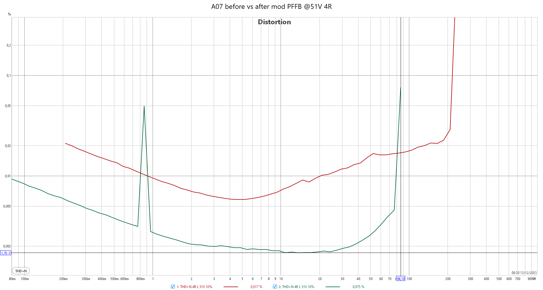

I has measured A07 before and after added PFFBIs anyone doing any before and after measurements of the modifications, or are all claimed improvements heard by ear only? 🙂

Adding PFFB is something that I understand should do a real difference yes, but I'm more curious about this mods where people change capacitors, op-amps etc. Does it make an measurable and audible difference or is it just placebo doing it's usual thing?I has measured A07 before and after added PFFBView attachment 1246020
Btw, you got a nice lowered distortion, but way less power, why is that? 🙂

PFFB... we didn't go for it... why?
Well, because - as you probably read in this thread - we went the trouble at one point to modify the output filter to tailorise it to the impedance curve of the main LS we were using, Quite some different values, big step on the paper. We hence expected big things to happen at least in the treble. Well, at the end, the result was quite negligeable.
I understand PFFB works indeed in a different way, enabling constant adaptation to the load - infinite changes and not a single change / adaptation. But the big single change we did didn't really bring a lot of benefits, while being a quite wide range mod for our LS impedance curve, so at the end we didn't expect PFFB to really bring some benefits in our specific case.
Admittely, we didn't try it, so we can't comment on that more than what I just did re single experiment with the output flter. And more importantly, our LS aren't very twisted when it comes to the complex impedance load they present to the amp. It is possible that more "complicated" LS regarding impedance variations vs frequency benefit more from PFFB, usualy in the treble extension if so I would say - but who knows perhaps 'elsewhere' aswell? You to try!
What I want to say is that IMHO, and that's just IMHO and not IME this time, PFFB is likely to perhaps shine on some "complicated" LS drives, while perhaps being far less significant on more benign loads. Its benefits are LS dependant, and perhaps for most users it could be overrated. But then implementing it shouldn't (again, just a guess, we didn't go for it!) bring any real negatives... or isn't it so?
