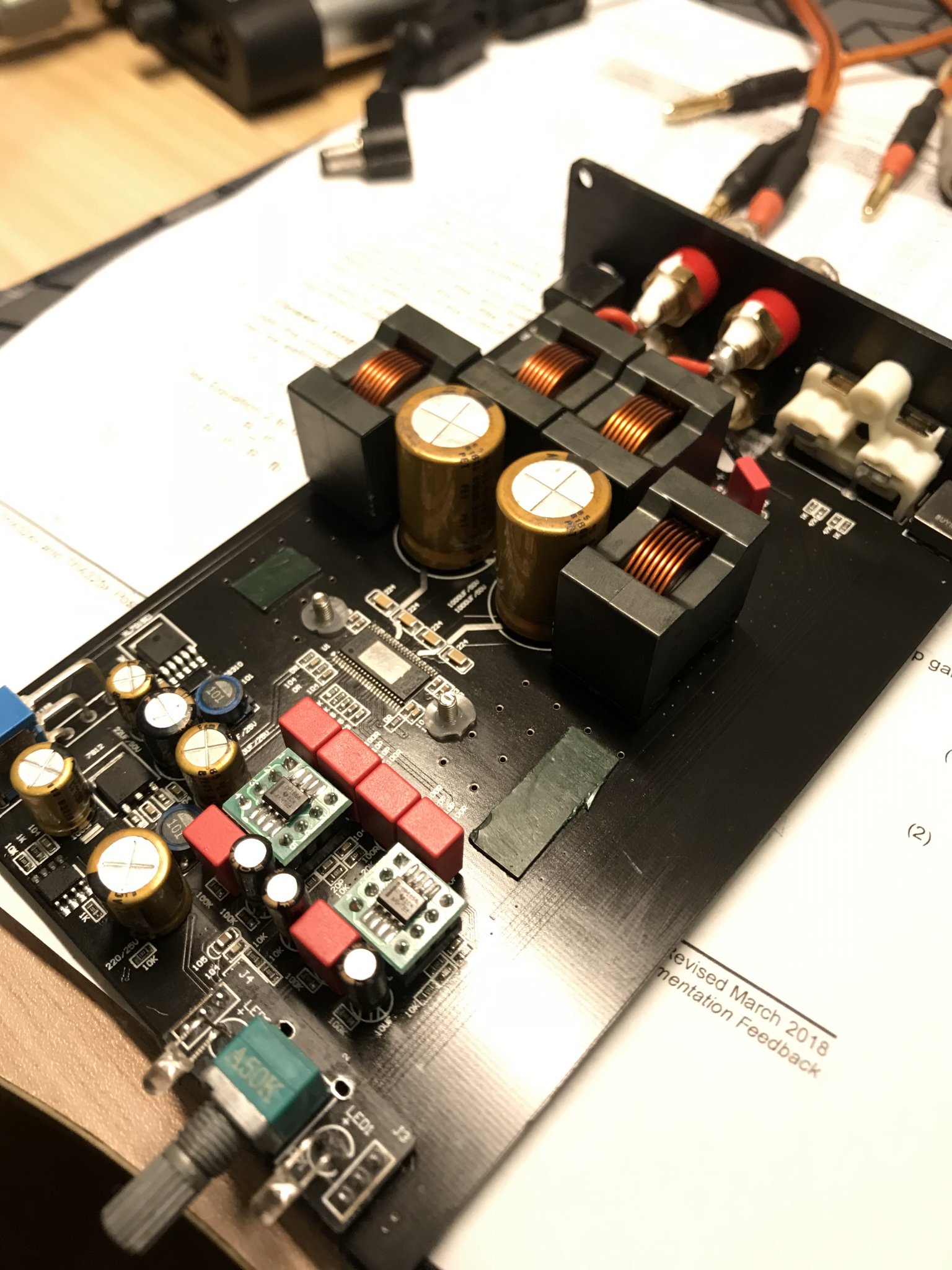

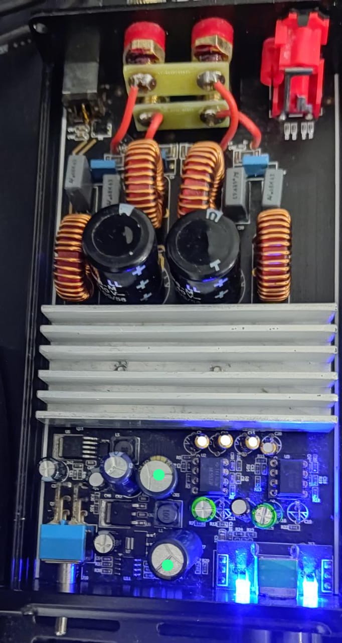

Just want to contribute something after reading all this mods in aiyima A04 in this forum
I think Aiyima place wrong value in 12v op-amp capacitor, 470uf (2 cap with green dot) is storage to much energy for anti pop to react if the amp is shut down, so i decide to replace them with 220uf Pana FC (you can use any brand) and the pop is gone! I'm only hear a fainth noise if you shutdown the amp without music in the background (if you play with music there is no pop out at all!). Well, It bother me since i bought this amp and i hope this help other people that have same problem with this amp. Sorry for my bad english, its not my main language.....
In aiyima a04 and a07, the power supply circuit for 2 opamps ic still works even if main switch is off, remaining 12v is supplied to VDD pin and GVDD will be closed through main switch. The capacitors you marked are the decoupling capacitors that feed the ic opamps as well as the VDD and GVDD pinsJust want to contribute something after reading all this mods in aiyima A04 in this forum

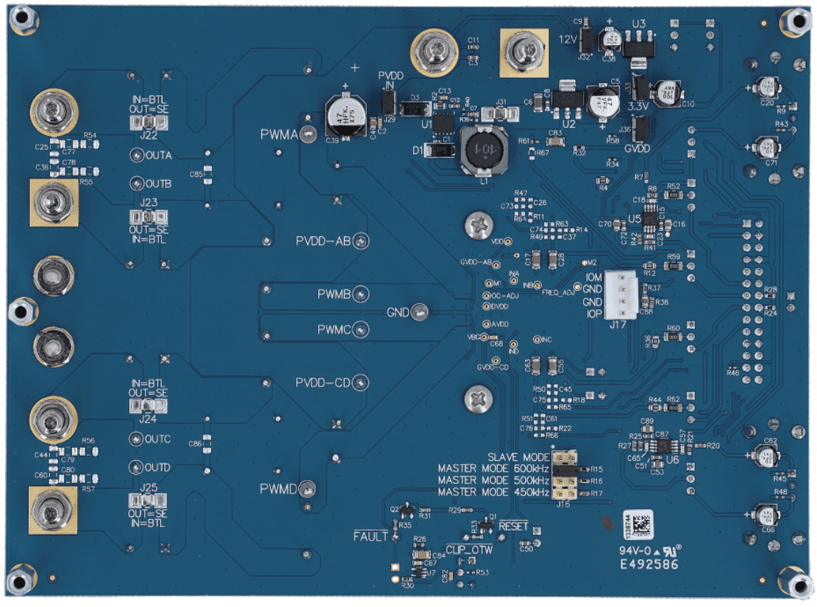

That got me to thinking. Why don't folks buy TI's eval board instead of the boards from China with cheaper/counterfeit components? Yes quite a bit more expensive, but you get XLR + RCA inputs, and direct signal into amp, no cheap "preamp" circuitry in the signal path.
I think I should have probably done that. And I wonder why ASR doesn't test those boards? One had to figure TI would know how to get the most out of their own chip?
All valid points. The board seems to be designed very well - not surprisingly... The only thing that would prevent me from buying would be having to spend time and effort to place it in a nice case, plus the power supply. Also, it is not FCC-approved for resale... this probably means very little to potential manufacturers... but still, it could be a problem. Anyway, the board does look very nice and provides many options... as you have already identified. With a very nice power supply, the whole package (inside the case) could cost in excess of $500... not counting the time spent to get everything over the finish line.
Of course, if you are a DIY-er with time on your hands... things are somewhat different. 🙂
I believe the Meanwell 36v 9.6 amp smps is < $70. TI spec sheet for the eval board specifically touts the sound quality... I would not care about a case but was thinking I might try to fit it into my ClassDAudio case and perhaps even use the linear power supply that came with that amp. That amp's board is somewhat obsolete now, but linear supply not so much...
I'm tempted to return unopened the second A07 arriving tomorrow (or just give it away) and just go for the eval board.

Hi guys,
A few points, quite quickly, as this has been posted more or less in the past...
First off, as per title this is a 04 specific thread: if related to 07 could you please keep it that way? There are already existing 07 threads...
Regarding eval boards a few general points, whatever boards (amps, DACs etc.) :
Can't comment on 07, but regarding 04, the main burden here as already posted is the price as when getting a 04 amp you get efectively a working TI evalk board. Indeed, the 04 we worked on where copy-paste of the eval boards regarding the (core / sound path" schematic (all the workin rest having been conviniently sorted), with some minor variations regarding the initial non balanced OPA gain stage. Apparently that changed somewhat during production... and may have changed as who knows how the 04 evolved it its production.
In short, when purchasing a 04 you effectively get a non expensive (if majour problem just buy another one!) DIYer friendly TI eval board.... at least regarding the schematic, let's go into details. But it is very cost effective... it works... and sounds good!
Details are the following:
Let's of course not forget safety regarding casing etc, conviniently done when going the 04 route
Dare I say a tuned 04, used with reasonable power limits, sounds as good or even better than an eval board?
That's probably the case, you to find out, let us know!
All IMHO
Claude

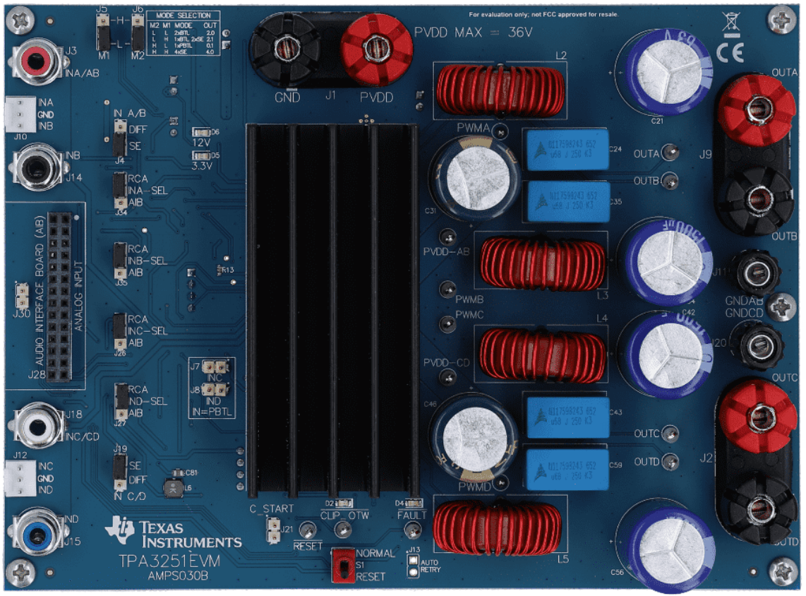

My apologies for being in the wrong thread (kind of the story of my life if I may say).
The TI A07 Eval board looks beautifully engineered and manufactured, please see pics in previous posting.

No problem 🙂
Yes, the TI eval boards looks well engineered indeed, and their documentation on what choices to make, on what they went for and why and on what could be further done is also very useful... I wish all manufacturers would do as much...
Pity it is that expensive

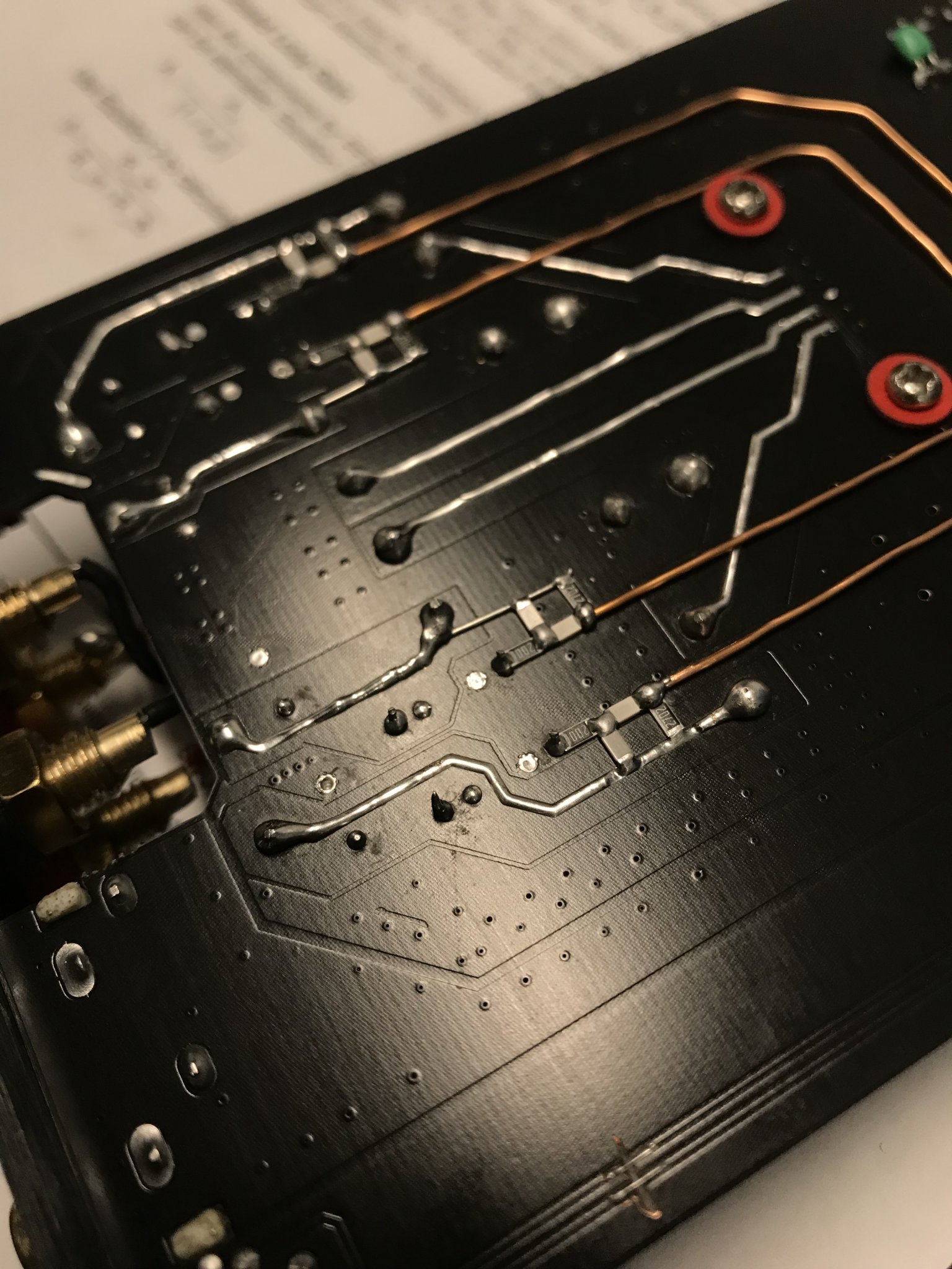

I haven't read all 41 pages in this thread, but I wonder if someone did a schematic including all the changes in capacitors, resistors and inductors that are recommended to be made.
There's one above by trunddtmc that includes isolated copper wire used as solid tracks, and some bypassing on the input ICs that would be useful to know where they are placed, and have some schematic of the solid wires.
