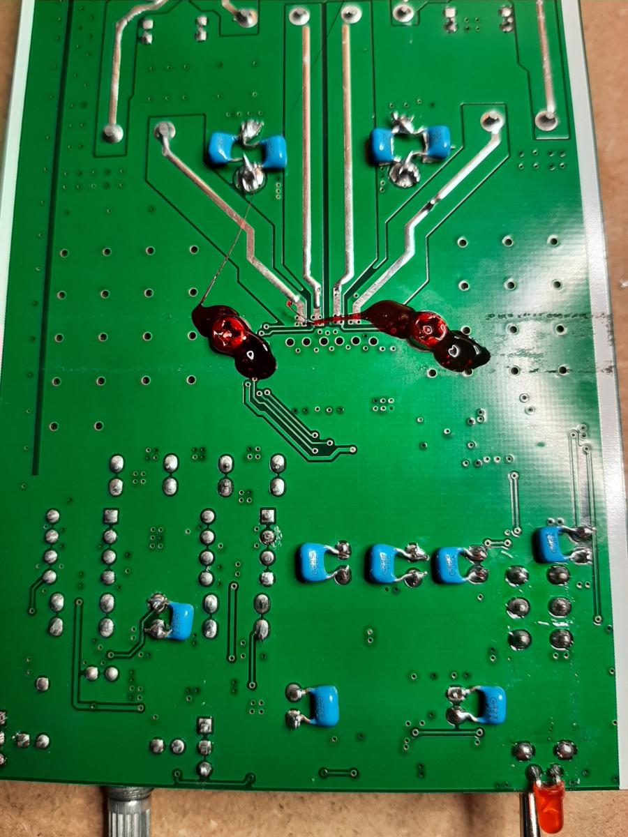

Hi Claude and Gilles! Thank you so much for your research! I read your experiences as a detective novel. Do you have plans to test the sound effects of the feedback loop from the amplifier output?
So we carry on with our evaluation, wich is part of mod "E". We jumped the electrolytic entry caps, 1 per channel, but please read the previous posts on that topic because we COULD do that due to other bits.
This is quite interesting as eventhough we love to play with all these time consuming caps bits and flavours, it gives you though an idea of the maximum magnitude to hope for. Indeed, no cap is best cap (except for adjusting flavour perhaps).
Caps mods can just bring a certain mod score/gain... but all that knowledge might help us at the end also to chose the final colour balance of the amp.The Class D I listened to seem to need some adjustment/help regarding a relative coldness, bass nuances, flow/naturalness and 3D soundstage, but I would love to be proven wrong... They do score though regulary in bass control/speed and details/ low noise
So here we go, 1 cap par channel out, and no down side whatsoever. Reported gains are:
- more transparency, +1
- More precision on mids and treble without turning analytical, +1
- No perceived improvement in bass (so the OEM did a good job there)
- More depth in the soundstage, some music now appearing (hourra!) behind the LS
Overall a very small gain of +1 though. That means minor mod.
OK, we still have 2 similar caps to address, so overall we might end up perhaps somewhere around +2 or +3 (to be confirmed!), which is not too bad considering what we are doing. But it also outlines that it is useless to spend much time or money on DC coupling caps for that unit. Read expensive PPP & Co. It doesn't respond that well to it, but it does somewhat and of course we can still adjust flavours with caps... at the end, if not entirely happy.

ClaudeG: very interesting🙂.
Do you have a picture of which capacitor you have removed ?
Did you remove it by force , letting the legs be in place and soldering it together, or did you unsolder the cap entirely ?

Hi Audientid14,
Sadly Gilles hasn't yet tried his hands on desoldering, but if we are locked down longer he might well need to if we want to progress or if he is bored (he is reading us LOL). He just ordered some parts to do so, but the main ones are still at mine and we still hope I will do all that.
So, to answer your question, he did it the dirty but very safe way and I might have to cure that, be it for cosmetic reasons. He simply connected the legs (see pix in previous posts) without desoldering anything! Pure shunt... I don't like to have the cap still there somewhere acting, but a good and safe way to test quick and dirty.
Now how would I do that when we meet again? Well, with a desoldering machine, something that heats and pumps at the same time, cost a fortune but the best way to desolder components without damaging them or the tiny signal tracks on the board. Hopefully. That is sucking all the solder away in a continuous manner while heating and parts come alone then or by very gentle pulling. Very quick, very efficient. TBH, it seemed to Gilles they could possibly come with a hand pump (5$) and gentle pulling, but then you have to make sure the hole is clean of solder. That means sometimes fiddling for 10 minutes, not overcooking it.
Last but not least, please bare in mind that shunt is only OK if you are 100% sure to have no DC at the input!!! We secured that by fitting PPP entry caps, I know most sources don't produce DC or have DC blocking caps, but having some safety at each single units input is good practice.

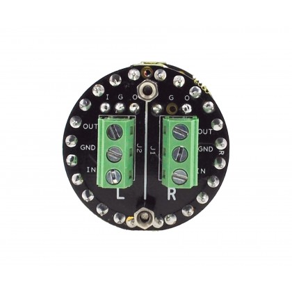

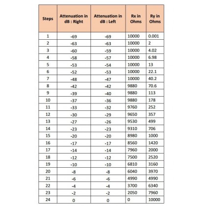

Thank you ClaudeG.
Allo has this volume control if you want a ”high end” piece. I dont know if it fits though.
ALLO Step ladder 24 positions 4 poles O6mm Flat Axis 10K - Audiophonics
There are so many solutions regarding volume control... but you will find that the space is VERY limited inside the unit! That's the main issue and rules out all my beloved solutions retaining a physical knob (I played recently with that in my B1 Korg built).
Not that we bother: as reported we fitted an external volume control, so space is no more restricted in our case. We had to anyway, as going bi-amping with 2 Aiyima and Gilles wanted a remote controled volume.
I will try to take the existing pot / volume board out and as usual we will report on sonic gains. As posted months ago, the tiny average pot is likely to rob a lot of music, but we will have to assess that feeling correctly.
The unit you are proposing is huge in comparison to the existing space inside the unit. Should you want to pack it there, it won't fit.
Measure and if you find something that fits, just go for it and let us know your findings 🙂

Idea for the "starving student"...
This is still ongoing, but for those not confident with the soldering iron, not wanting to desolder anything, just playing with thin add-ons easy to do and undo, and keeping the casing, safety, functions etc. It is somethig I am considering for our 3rd amp, in hope to bring it to a satisfactory sonic level.
Total mod material cost is at Mouser's 19E WITH TAX...
Meaning the cost of a modded Aiyima with its PS is less than 85E!
The bypass caps used are all tiny Murata that all fit underboard and can be soldered either way (no polarity), either 10uF/25V or 2.2uF/50V "X7R type", or Murata 0.1uF/50V "C0G type". Links at Mouser below:
https://www.mouser.fr/ProductDetail/Murata-Electronics/RCER71E106K3A2H03B?qs=Zt%252BKPUOg4ofsQVPTPVDJLw%3D%3D
RCE5C1H823J2A2H03B Murata Electronics | Mouser France
RCER71H225K2A2H03B Murata Electronics | Mouser France
The recommended Op amp to fit is TI's excellent dual OPA1656:
https://www.mouser.fr/ProductDetail/Texas-Instruments/OPA1656IDR?qs=vLWxofP3U2ztlJVp%2BbIcnQ==
Mods are the following:
1) Resolder properly the output wiring to LS terminals
=> Cost 0, gain TBD
2) Replace the 2 removable OP amps with 2 x OPA1656 (these have to be soldered on adapters by you or any decent student)
=> Op amp cost 5.5E, gain +5
3) Big PS caps bypass, with each 2x 2,2uF (so 4 in total)
=> Cost 3.4E, gain +2
NOTE: for the same price you could go 4,7uF X7R + 0.1uF C0G, anyone wanting to give that combo a try?
4) Bypass all 9 electrolytic caps around the op amps with 0.1uF
=> Cost 3.8E, gain under evaluation
NOTE: bypassing the middle one only gives already +1
5) Bypass the 3 470uF caps with each one 2.2uF cap, and the 100uF and 22uF ones with each one 0.1uF cap
=> Cost 3.4E, gain +1... you to decide if worth doing "while at it"...
6) Op amp PS, bypass each of the 2 op amp PS with 10uF and 0.1uF
=> 3.2E, gain under evaluation
Some mod rankings are under evaluation, but whatever you do you will end up with a sonic upgrade that is at least twice the step the widely acclaimed and massively perceived sonic step OPA1656 represents => Say a modded unit that works significantly better for 19$ material cost.
That process will be refined once all is comletely finalised... But guys, this is dead easy and cheap, so why don't give it a go and report on YOUR findings?
I hope this is of interest

Hi Rob,
A while ago you asked about replacement potentiometer options... haven't fogotten that one, but it is not easy indeed.
We have yet to take the existing pot out to assess how good / bad it is - indeed, it doesn't look to good. Of course we went the easy way, read external pot, solves all the size issues...
Having said that, I had a look and if someone would have to retain an internal pot (convenient) the best bet is probably the very similar sized (and coloured) Alps. In fact it might be already an Alps pot inside the unit, or more probably... a fake/copy. That doesn't mean it is far worst though...
Would a genuine one, that as the same form factor, bring a benefit? Or a hand wired small Panasonic pot? I don't know, these aren't the best pot in the world and I wouldn't expect them to be a match to what is a benchmark for affordable pots, read Alps RK27 aka "Blue". And that one is no match by far to the Alps Black Beauty I own since decades, nor the Tocos I purchased recently, both competing indeed with VG stepped attenuators.
Now, thinking attenuators, there might be an option... Thanks to SMD and Chinese low cost, I found this 'DACT Type SMD stepped attenuator"
DACT Type SMD 21 Stepped Attenuator/Volume Control Potentiometer 10/20/100/250K | eBay
Of course it is a copy, but most people seem happy with it and the price is a steal. I don't even expect it to run on a par with the best potentiometers, but let's face it: if it turns out it is a match to an Alps blue than it is already a nice solution, provided you can live with 21 steps to adjust volume (it is not continuous and these are few steps).
NOW the biggest issue: SIZE.
My understanding is this part can't fit easily, but as you are a pro when it comes to making things fit with your experiments...
I would say the board needs to get out of the way, the pot needs to be fitted sideways (connectors to L or R) and the hole needs to be drilled to offset thevolume button to the top, to get a chance to have the right clearance. It is 21mm in diameter without connections and you can't of course run the risk to touch the SMD resistors underneath it. Better wrap the pot in case the screw gets lose.
Would that attenuator fit with all these adjustments? Not even sure, only trying can tell. For myself I don't know anything as qualitative in such a small foot print.
I hope this helps
Claude
