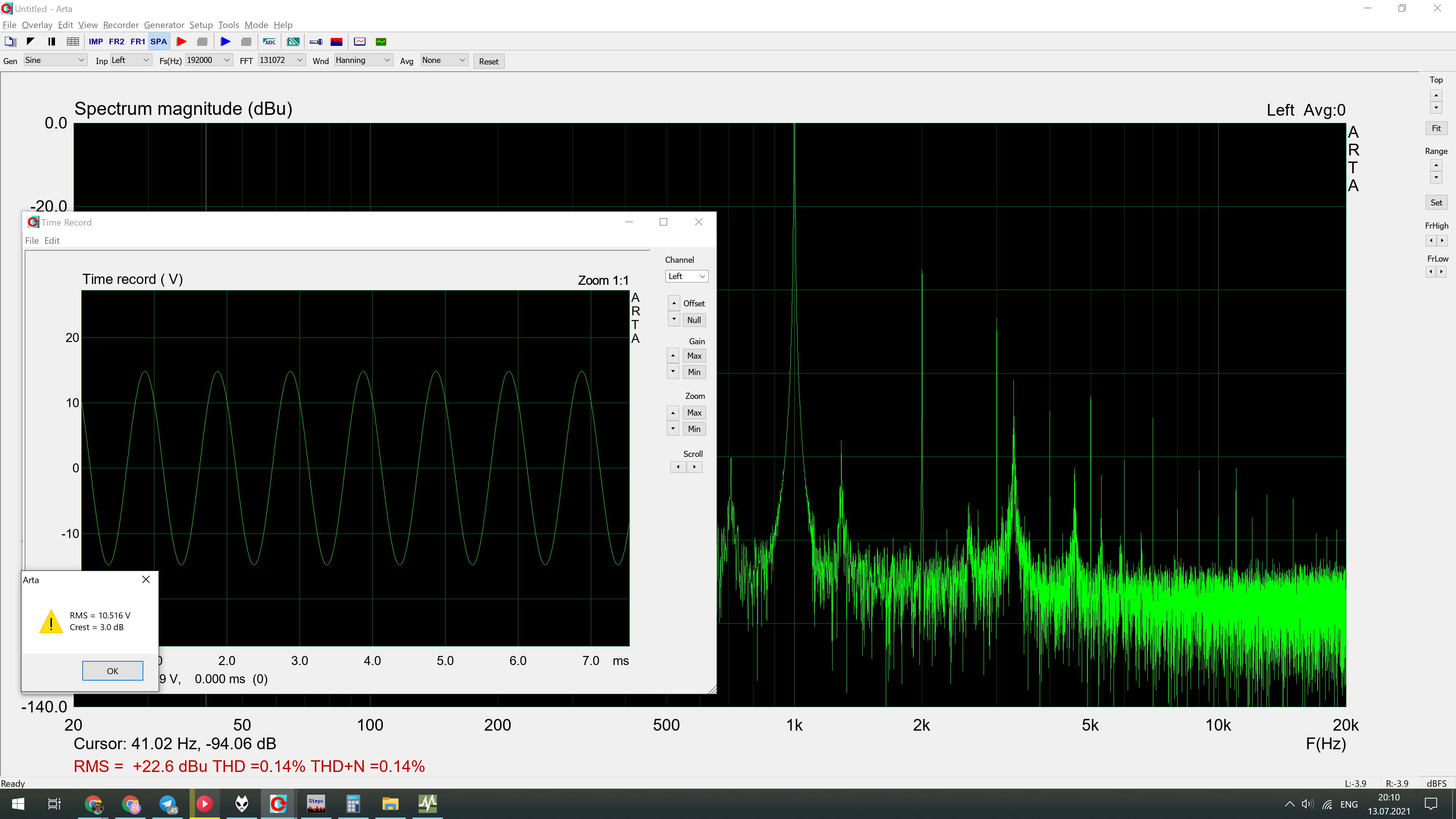

Poor measurements compared to ICEpower50ASX2SE
Got not very good results today with my Aiyima A04

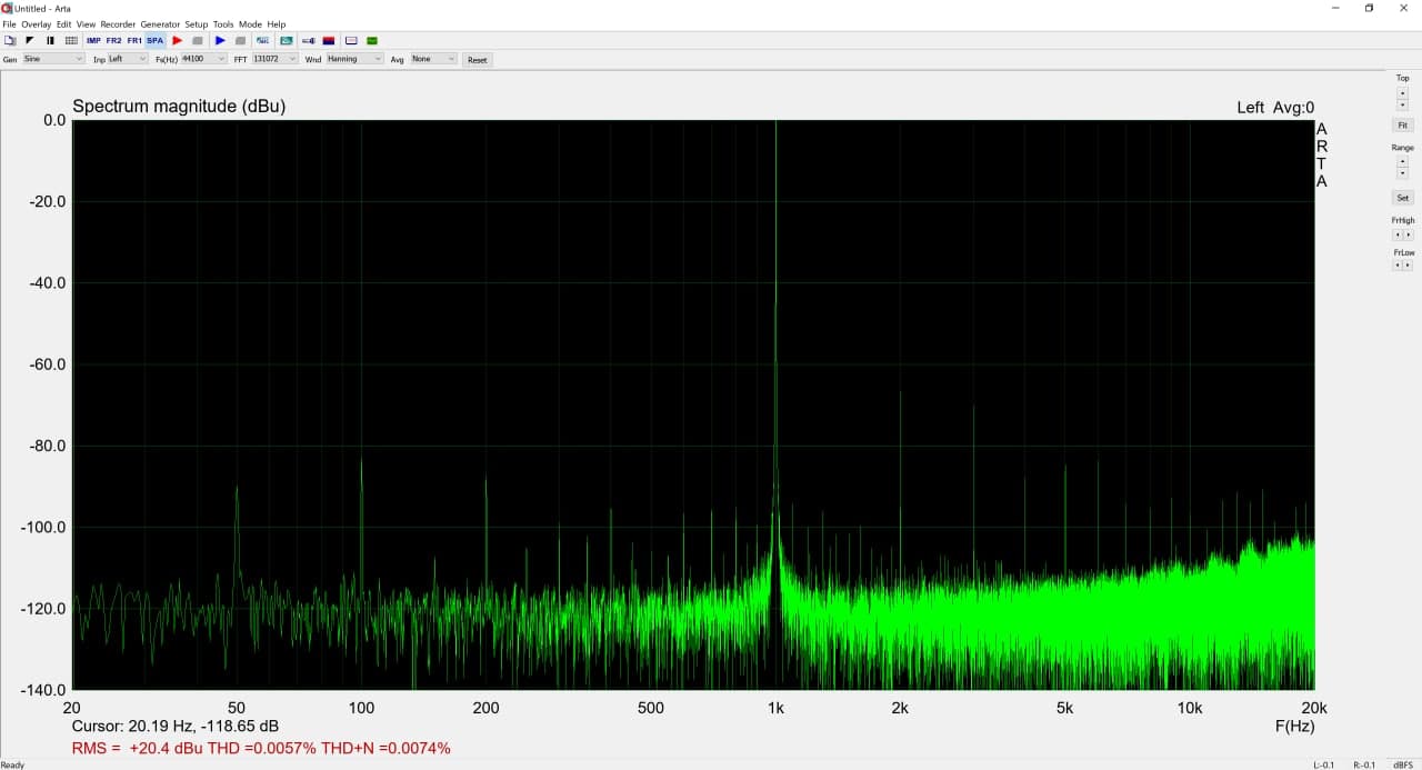

On the Motu M4, even with 192khZ sampling, I do not see anything criminal in the waveform. Probably, still need an oscilloscope to figure out where the legs are growing: from a power source, LC-strapping TPA3251 or the wrong operating mode OPA1656 (which is most likely in unity gain judging by the very low gain)

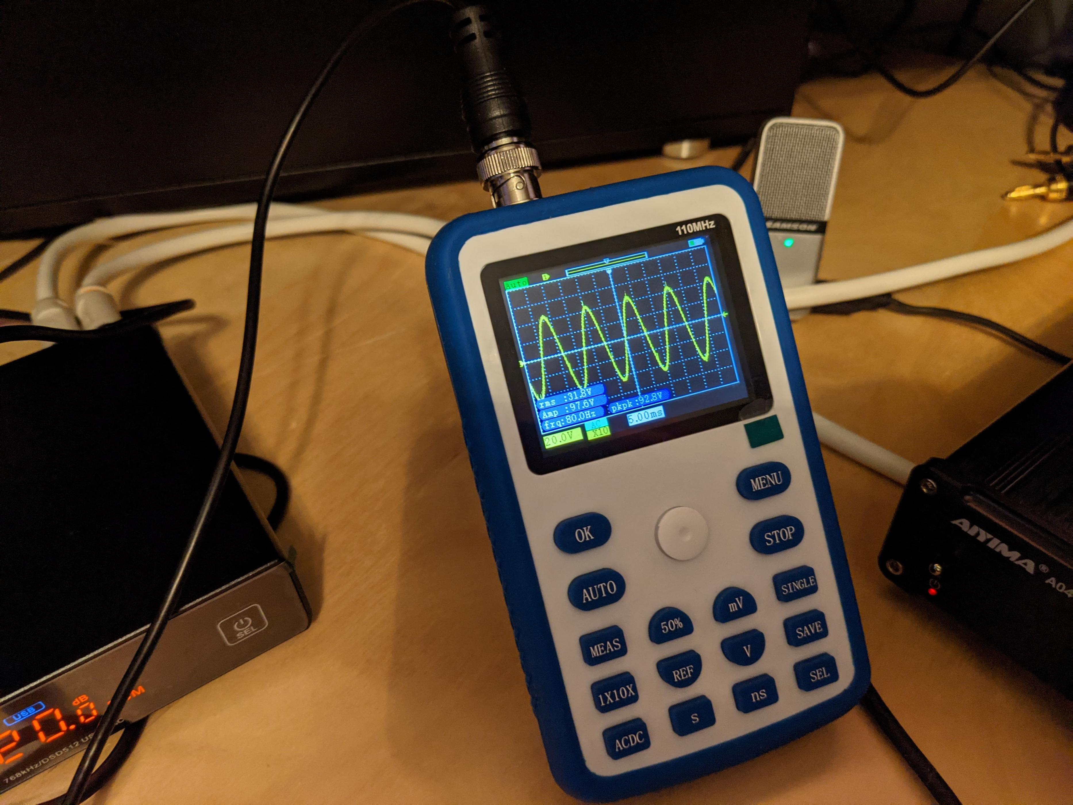

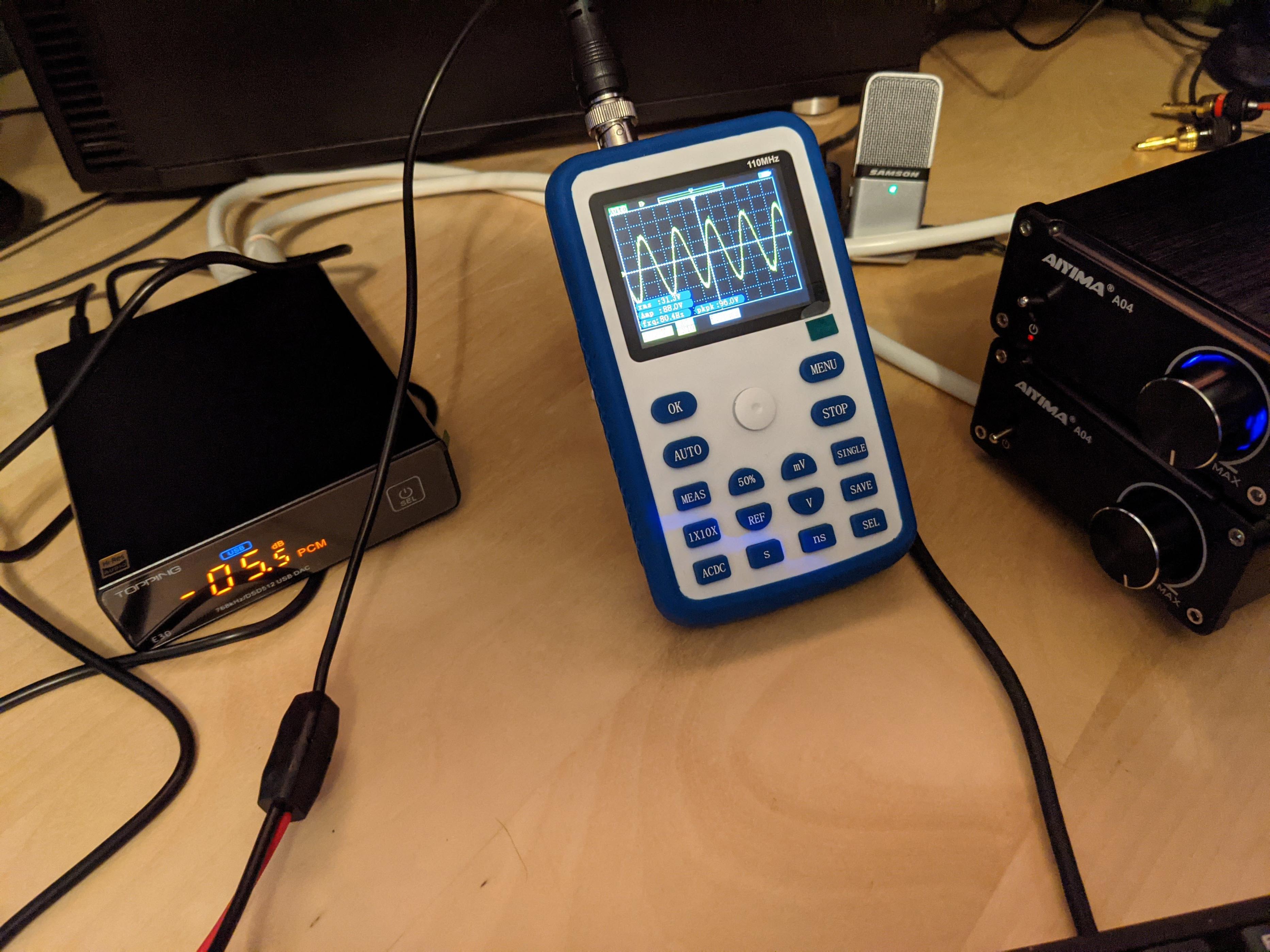

i purchased an A04 sometime back in 5/2020, received the tilear rev 2.1 board
recently purchased two A04s, HDX325X rev 3.1, and there is a massive power decrease
tests i just ran to demonstrate
and 'close' pics showing the detail
tilear A04 rev 2.1 (good) = 31.9Vrms with the above settings
new A04 rev 3.1 (bad) = 6.82Vrms with the identical settings!!!
the new A04 (bad) had to have the E30 attenuation set to -5.5dB to match ~31.2Vrms, 14.5dB difference

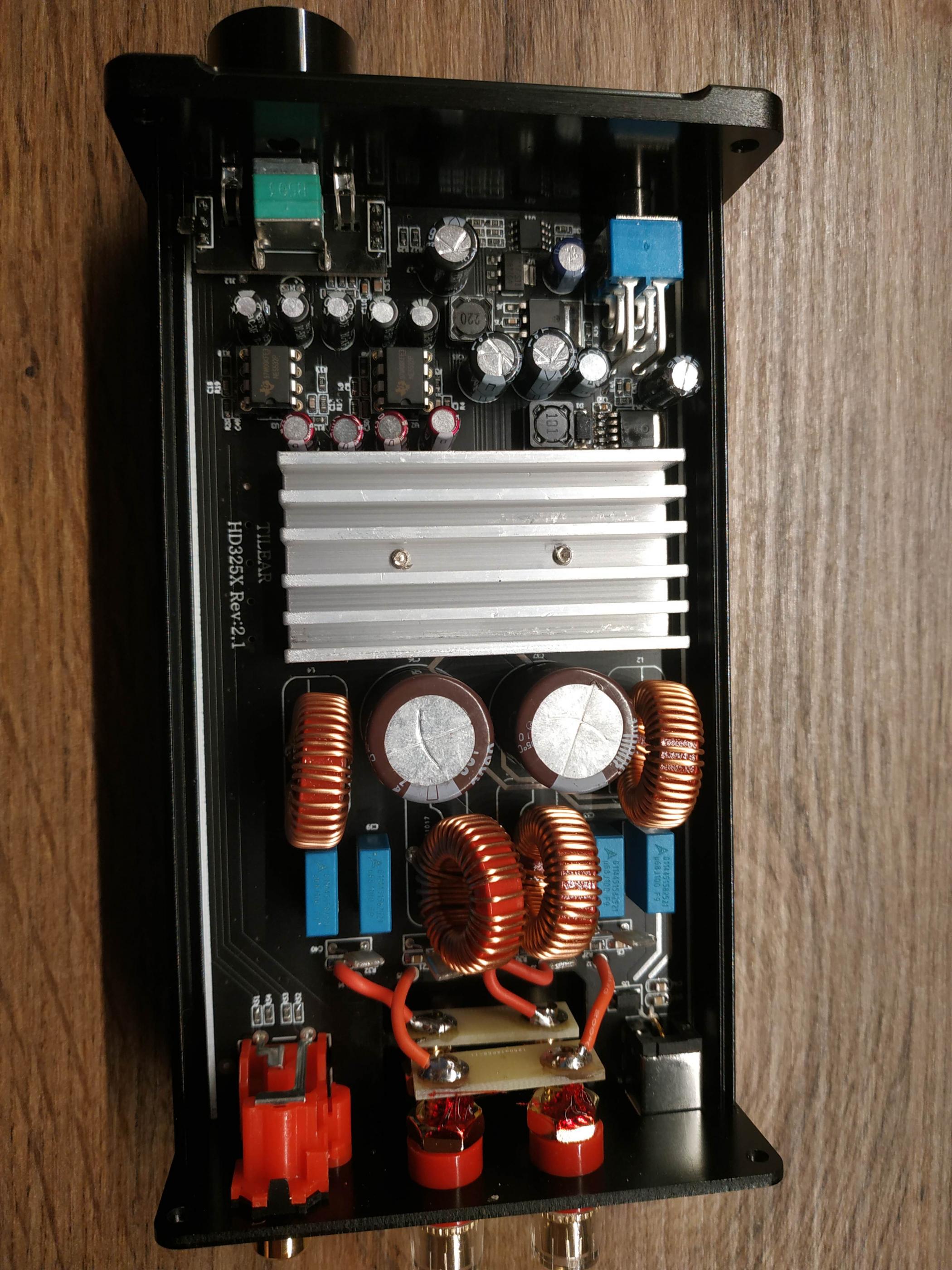

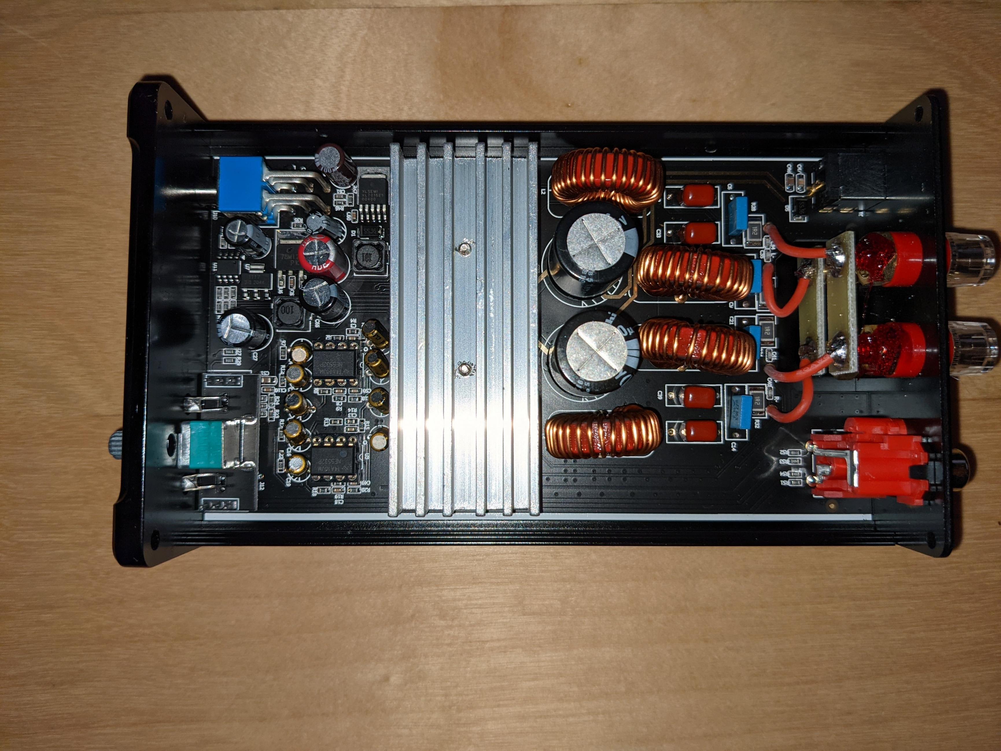

anyone have any ideas what could possibly have led to this massive decrease in output? change in caps? inductors? i was able to disassemble it but the two screws holding down the heat sink have some red glue/epoxy over them. will need a heat gun from a friend before i can attempt to get those off to see if they even are still using the tpa3251 chip or they bait and switched
i've attached some pics of the scope readings, and a pic from ASR of the 2.1 board, and a pic from me of the new rev 3.1 board

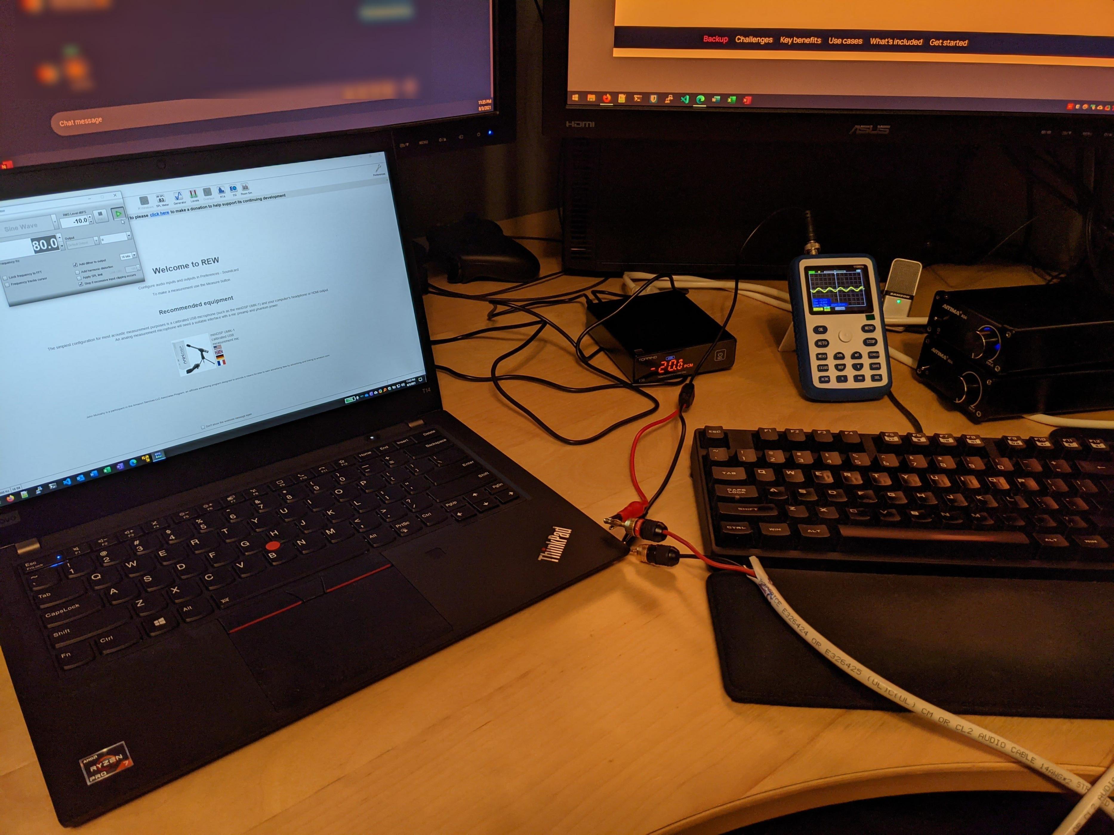

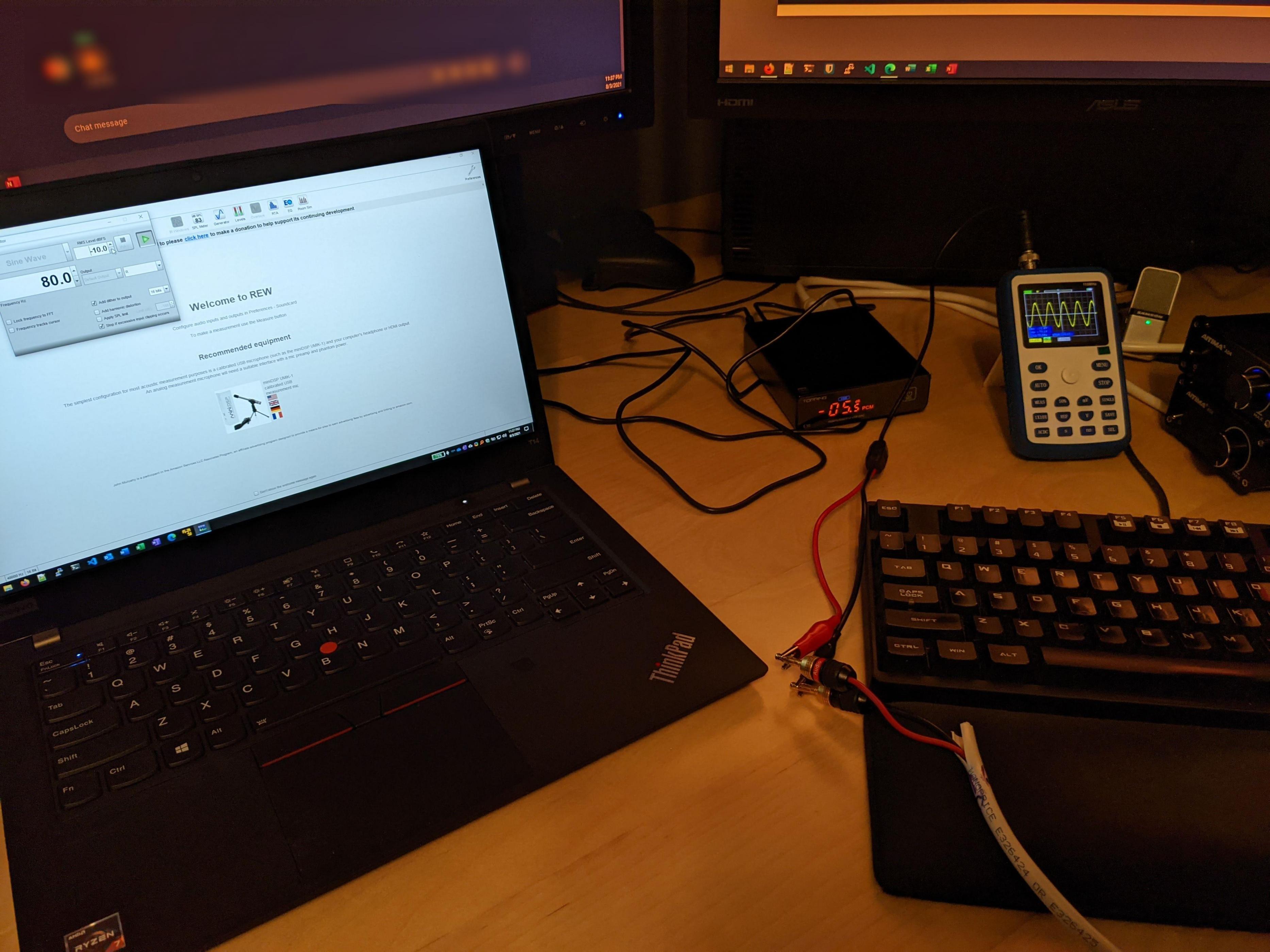

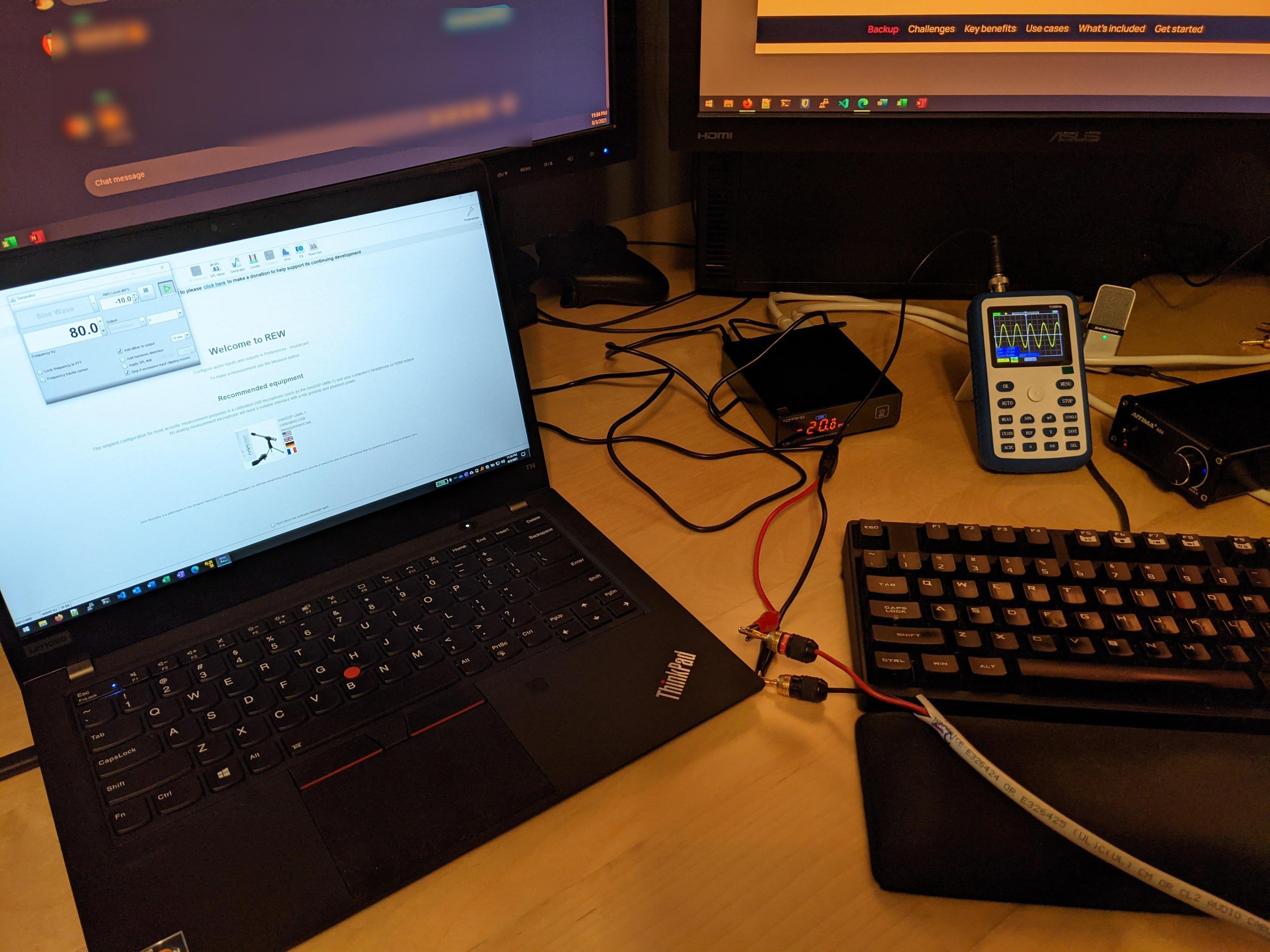

- REW signal generator for 80hz @ -10dBFS
- E30 set to -20dB
- Right channel observed directly to scope, no load (can provide with a speaker load if needed)
- Volume knob on both units set to max, 14AWG ofc wire for testing

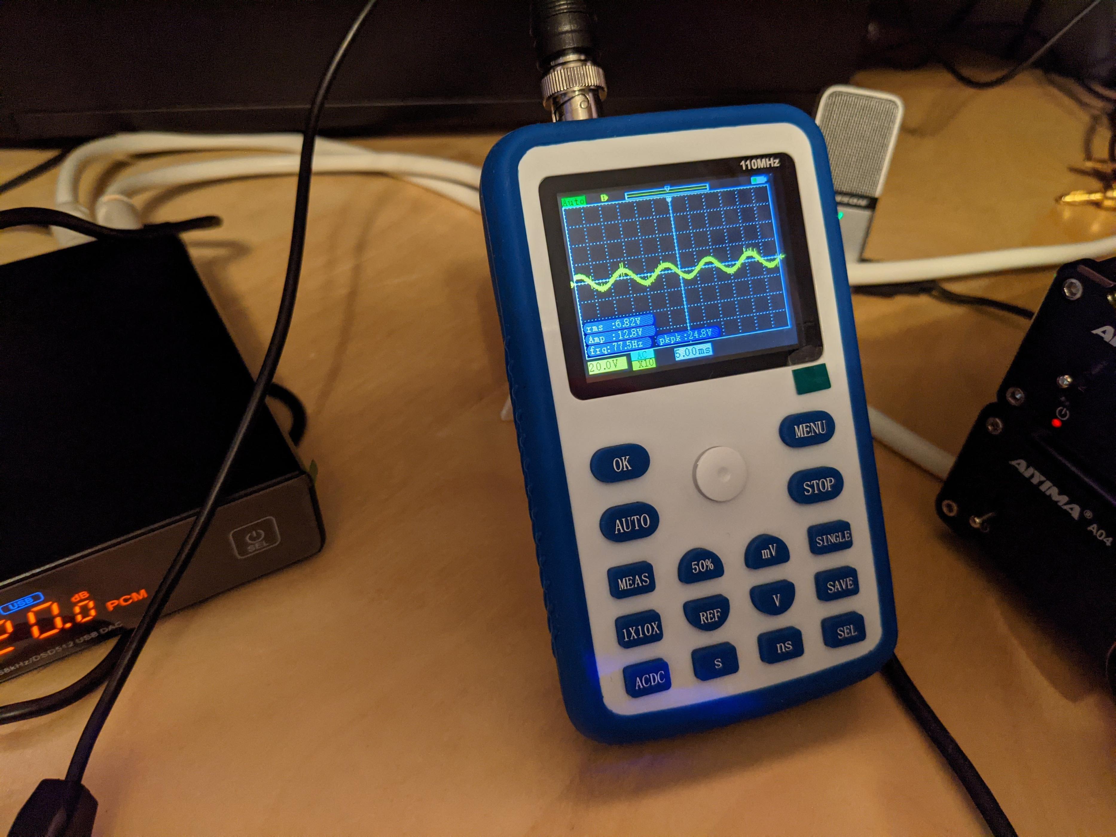

Recently, we also found that after adding the feedback circuit, the power has been reduced. After re-adjusting our project, the input voltage has been re-adjusted to meet the previous requirements for power recovery and the feedback circuit has also been added. The sound obtained now will sound better under low-power speakers. Does not affect the use of high power
To increase the level of the input signal, you can also reach the previous value.
i've provided 'far' pics showing the test setup
- E30 set to -20dB

i had the 10x selector on my scope by accident
here are the accurate measurements, also noted in another post
