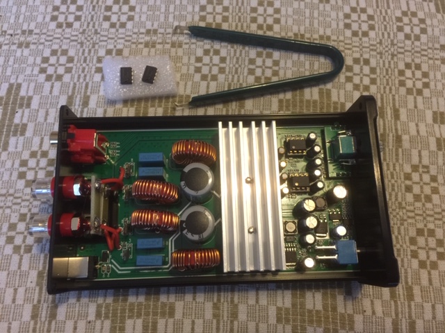

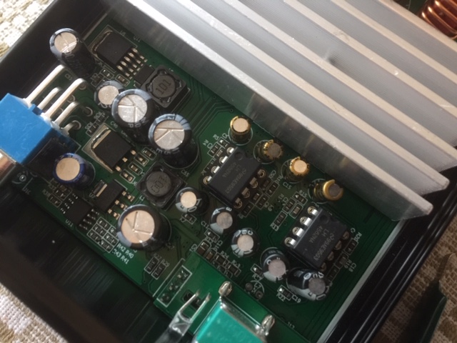

I have replaced the ne5532 with lm4562 and I think some irritating issues in the sound completely dissapeard from 4 kHz -10 KHz . More clean and more dynamic sound with lm4562.

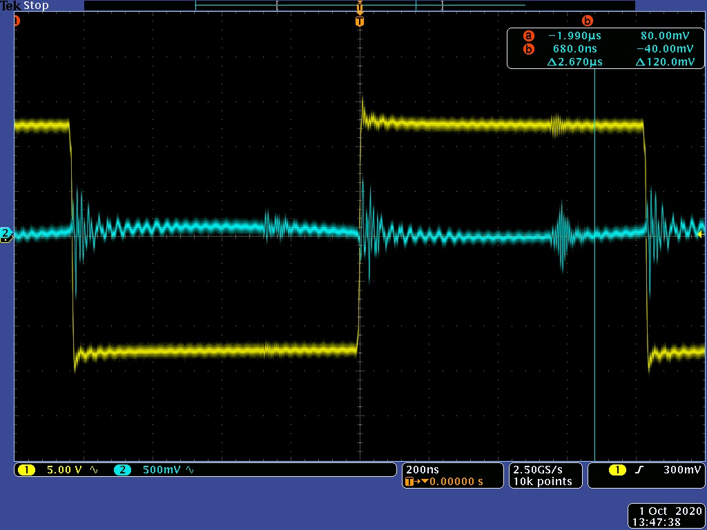

I took a quick look at the output filter, and it looks good. No oscillation problems as I see it. The small spikes on the output seen 'between flanks' are from the switching on the other channel.
The 10V output gets a bit ugly, maybe because of mild saturation of the output inductors, or possibly it could need some extra cap on the supply?
The 6+7kHz test is something I started doing recently, and it seems pretty revealing of IMD. I have only measured one 'homebrew' AB amp in this way, and it gave similar results. Does not look too nice in my eyes, but as I said, I have very little reference.

The way you describe the sound from the unmodified Aiyima a04 is exactly the way I would describe the sound with the stock ne5532. All of those issues dissapeared when I changed IC to a lm4562.
You should try it🙂.

I measured distortion comparing the delivered 5532 vs genuine 5532 vs 4562, there is basically no difference. I could se a few dB's difference on some harmonics low down, and that is within measurement tolerance I would say. I used one channel as reference with the delivered OP-amp, and swapped op-amps on the other channel.
Tested with a regulated 24V bench supply, and it does seem that lowering the voltage from 24V while watching the FFT raises the distortion a bit (more difference than changing op-amps).
I also changed it's original 5532 to 4562, using my 19V notebook power. That's lots of difference in my sense of hearing. I would suspect my 5532 shipped with it are not genuine, or it's possibly affected by low power voltage ?
* my A04 is green board version
I agree on the OP-amp, I even measured directly on the output from the op-amp, and could not see any difference in distortion between the supplied one and the genuine.
I did try listening too, and to my ears there seems to be some difference with the 4562. Not much, but something in the mid/treble sounds a little bit different. However, in bass it still sounds the same. I would prefer some more control in the bass. This time I used a 10000uF cap on the supply from the 19,5V laptop brick.

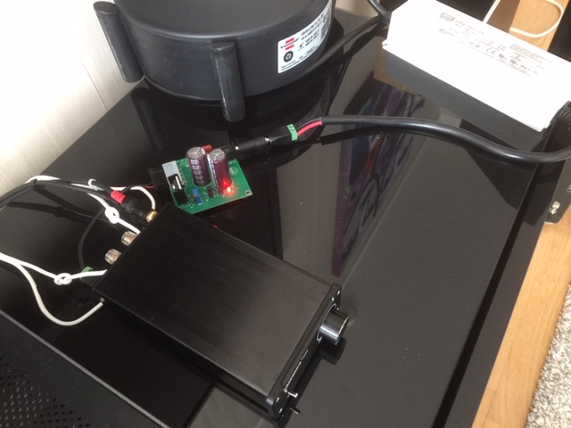

I use a capacitance multiplier from Allo. Its the same as having 1000000 uF .
Everything in the sound becomes slightly better with the capacitance multiplier, especially in the bass.
It only costs 17 dollars from Allo as stand alone. I can recomend it.
Iˋm using a mean well 24 v 6,3 A switch mode supply.
