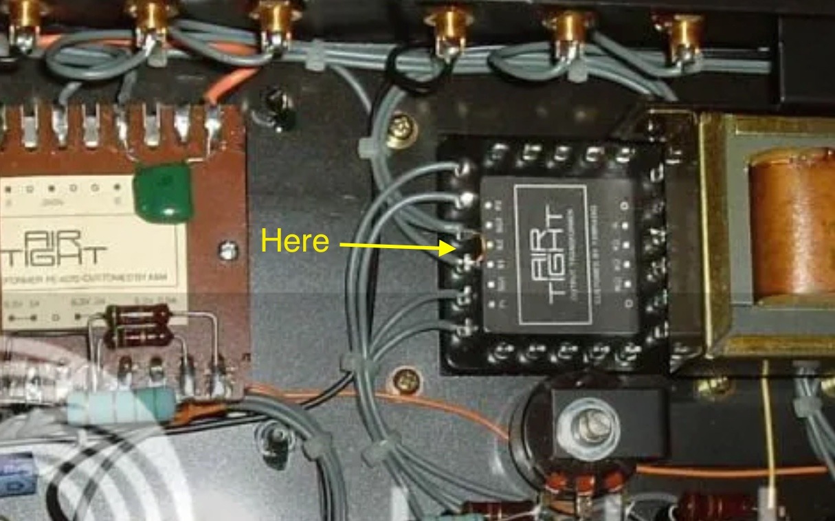

I do not understand the instructions to set bias because I don’t know what is the “copper Link Tap on Output Transformer” that has to be 3 volts below the anode voltage (pin 3).
Careful! You have to observe the intended design current through the tube, among other things to ensure you are within the dissipation ratings of the tube. Earlier in the thread a plate current of 45-50 ma was mentioned as the specified value. With a HV supply of 480V as @iWozza ’s you better be below 52 ma, because then the plate is dissipating the maximum 25 watts.
Hi Francois,
I don't understand the reasons behind my instructions.
The "Copper tab" was a bare wire link between taps on the output transformer.
Perhaps centre tap...? Looking at photos on here, think its between terminals 3 and 4 on the left side of the left output x-former from beneath.
Thank you.
OK, I see, the physical copper tab appears to be the “Test point” on the schematic, that is the B+ end of each primary winding. So, the objective of the instructions is to equalize the DC voltages across each side of the primary winding. This implies that the resistance of each side of the winding is exactly equal. You may test that sometime (with the power off).
