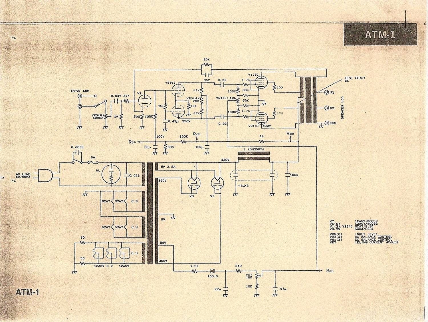

AirTight ATM-1 Schematic

Any advice on Step 7?
I am quite reluctant to start soldering and poking around in this piece of japanese art.
Its a push-pull El34 amp with 12ax7 input and 12ua7 long tail pair phase splitter. Nothing original here. I would consider a CCS in the tail of the phase splitter... 😉
It seems though that soldering will become inevitable at some point as my psu electrolytics (Nichicon Audio Professor) are drying out.
Fresh new electrolytics work wonders. Just don't go for "NOS' electrolytics. By-pass with a small, high quality film cap if you feel the need.
btw, here is a nicer looking schematic:
wow, that filter choke is only 1.25H ? go figure...

So it seems I was advised to do 2 things:
1) Set DC Balance VR 1, (2)
2) Set Idle Current VR 7 via the -40V bias???

I guess I was advised against altering the VR 3, (4) AC Balance as he mentioned using a scope for distortion.
I have 2 questions;
1) Can I adjust AC Balance with a voltmeter on AC or is that not right?
2) How easy is the CSS mod in the tail of the phase splitter and what is that all about? Had a quick google about it.
If you have not touched VR 3 (4) then its probably best to leave it as is. I assume the technician in the shop has gone over the unit, so it should have been set to a reasonable position.
If you have no experience and don't understand circuits well, then don't bother with the CCS mod.
I personally don't like the idea of adjusting bias of the EL34's by measuring voltage drop across the primary windings of the output transformer. These are quite high DC voltages that are LETHAL. I hope your multimeter is a good quality one as noted already in previous posts. I hope you take the time to read posts on how to safely do this...
The old school method is to permanently insert some small value cathode resistor for each EL34 (i.e 10 ohms metal film, half watt or higher) so you can measure voltage drop and calculate individual current of each EL34 at a safe voltage. I would consider this modification, although some purists might find some reason or other against it. This I leave up to you.
Keep in mind that adjusting VR1(2) will move the current of one EL34 UP and the other EL34 DOWN simultaneously. It is like moving the fulcrum on a teeter-totter (or set of scales). So you need to measure back and forth to find the point where they match. This is not so nice to be doing over the high voltages of the output transformer primary windings.

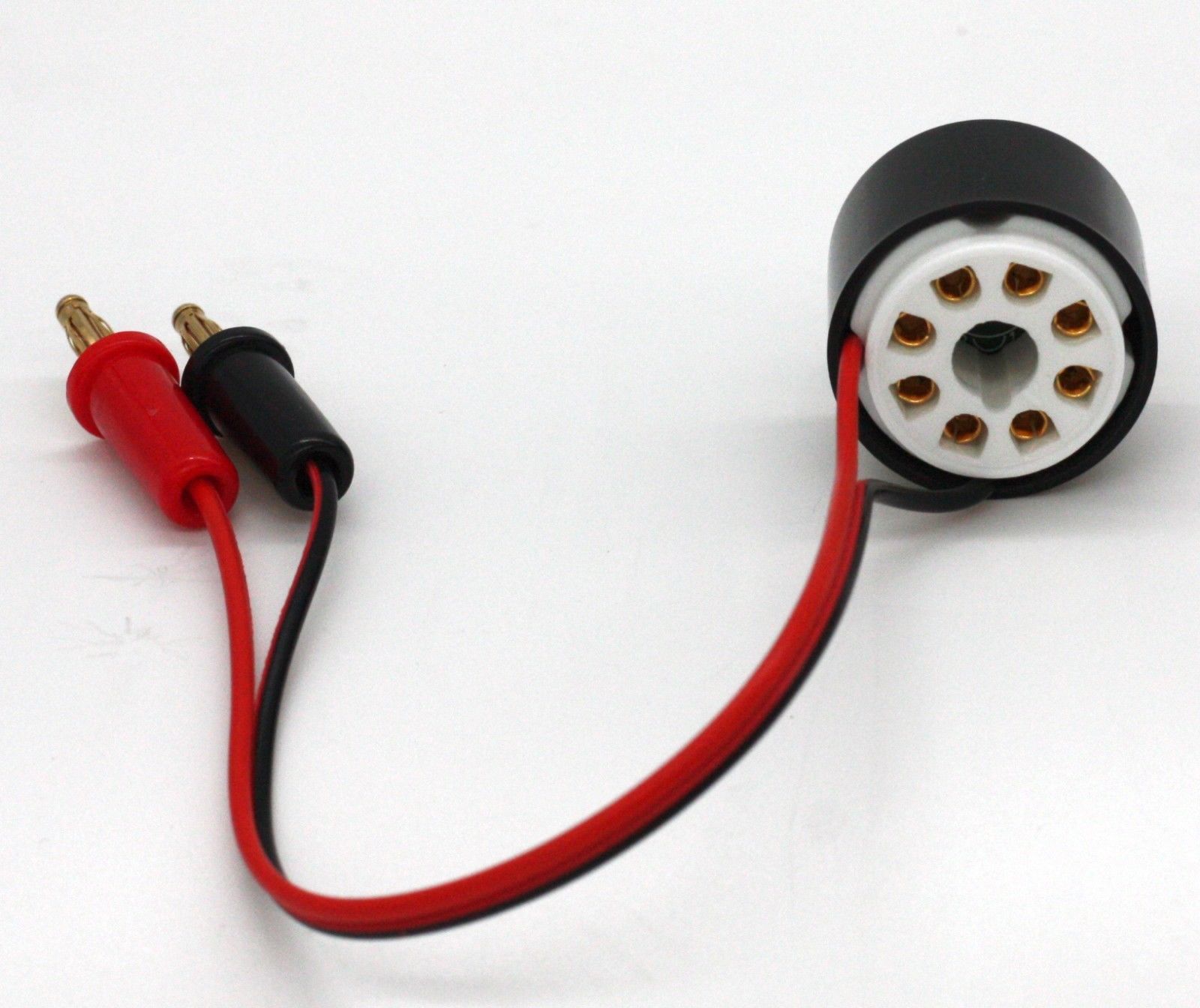

Just get a tube current test socket/adapter.
You just plug the tube in through these and use your meter to measure the cathode current directly. No re-wiring needed. No opening the amplifier even, if the bias trimpot has an access hole.

Hi Smokingamp
These adapters may work well with individual tubes/valves, but for this amlifier, when you adjust the bias UP on one, it goes DOWN on the other.
So indeed it is not a bias adjustment, but a balance adjustment.
I suppose if you had two of these it could be used. I had one of these given to me from a friend. I never used it, so don’t know what the leads are even.
If one is the plate, then the ‘careful with high voltages’ rule is still there.

The octal tube socket current test/adapters are only like $13 on Ebay. They break the cathode connection and bring those out as leads for a current meter. (black wire from plug end pin 8 and red wire from socket end pin 8, connect black to - on meter, connect red to + on meter) There is no HV on them. Just use two of them and two meters (mA current setting) for the balancing/bias type amplifier. Way safer than messing with HV B+.
Could probably build a set of them for $10. An octal plug and an octal socket for each. Wire all pins directly thru except pin 8 which comes out as the two test leads. Black wire from the plug pin 8 and red wire from the socket pin 8. Every service shop should have these. So simple to use on any amplifier (with 6L6, EL34, KT88 etc octal basing).
There are even adapter current test models on Ebay for TV Sweep tube basing too (Compactron, pin 2 cathode). Also 9 pin Noval ones for EL84/6BQ5 (pin 3 cathode).

Revised ATM-1 Schematic
Had a go at redrawing the schematic in Inkscape due to the original being a bit lo-fi.
I had a problem when 2 "NOS" Russian GZ34 started arcing then blew the fuse after about 2 weeks use. Google found many similar happenings on guitar amp forums.
I feared there was something wrong with my amp and mentioned it to Jacmusic. He informed me the Rectifiers were rigged up wrong and that arcing happens mostly with bad circuit design.
Turns out my rectifiers are actually wired up right but the schematic is drawn wrong!
They are drawn the right way on that hand drawn schematic below.
However, my HV voltages measured quite different.
Heaters good at 6.3V and 5V so the power transformer must be 240V (badly scrawled in biro).
HV Transformer is 370V instead of 360V
HV rectified is 480V instead of the 430V on schematic.
I also discovered my Output Transformers were wired for 8-16Ω instead of the 8-4Ω taps.
My feeling was although the amp had an insightful mid range it lacked bass weight and could be a bit peircy on the top end. I conjected it maybe for tiny Tokyo aparments that didn't want to blast neighbours with heavy bass 😀.
Little did I know my speakers were connected to 16Ω all along....
Soldering iron out - Moved speaker outs to the correct taps...
Put the old USA Golden Lion rectifiers in and Bingo Wins!!
1) The amp sounds Fat, Gorgeous and no longer Piercy
2) No Arcing whatsoever on the old rectifiers....
So the ATM-1 adventure is born again :worship:
