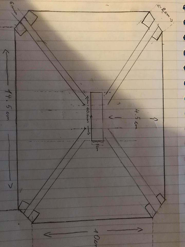

AMT layout in Archicad
Here are some pictures with the layout structure of my design of AMT which I still could not simulate it to see if the 25x5x5mm N42 magnets in between the steel plates will be enough to ensure an even magnetic field for a diaphragm of around 140mm high and 40mm wide.
Of course, is missing the fake bottom where I`ll put the hardware for the digital filters and also the top part.
All the parts will be laser cut and the walls where I`ll insert the magnets and steel plates is made of clear acrylic and I plan to use some silicon-based adhesive to ensure are no vibrations.
What do you think?
What do you think?
What do you think?

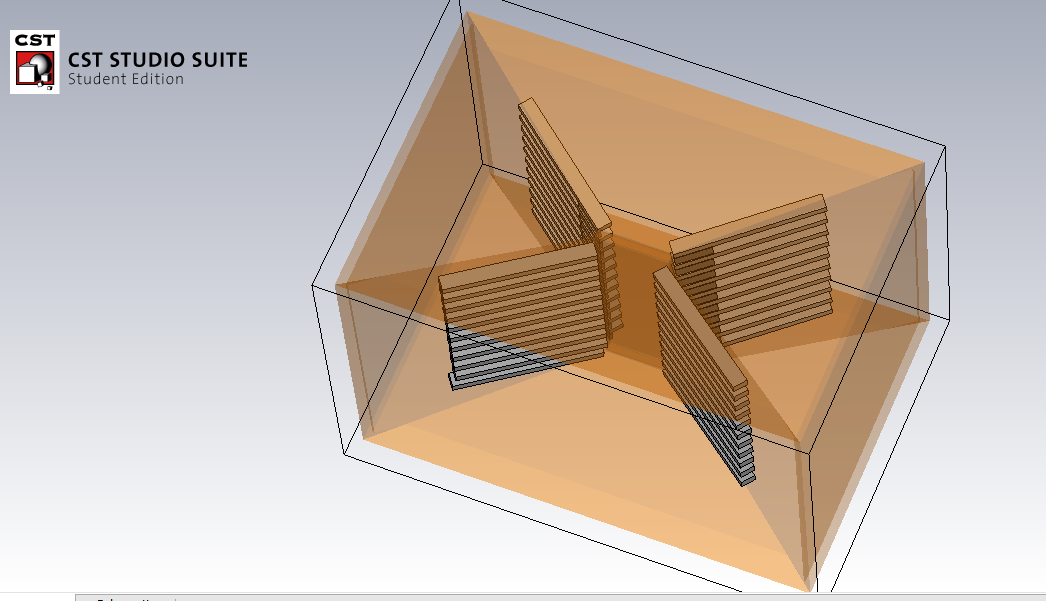

I made the structure in CST EM studio which is a 3D simulator but I`m still waiting for a teacher from university to show me how to get a simulation successfully.

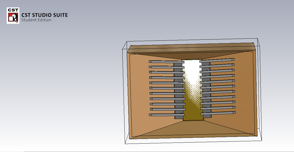

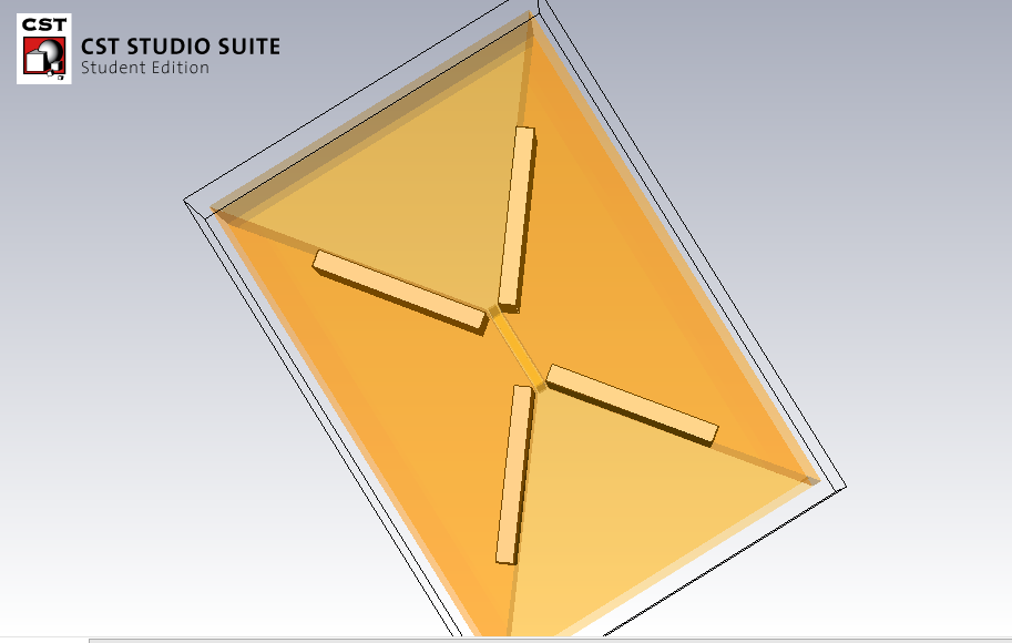

Ok, so this might be another view of it?
the 4 walls where the structure sits have an angle but I tried the way you show above and it doesn`t look good at all.
I might have to add or change the location of the magnets closer to the membrane or even to change the whole design if I can`t get enough flux
I`ll try different angles more appropriate with my design to see if gets any better...

3d simulation
I tried to simulate 3D but I have a problem because the magnet doesn`t interact with the iron in the simulation, thus it doesn`t guide the flux towards the membrane.
I`m still trying with this design since I done the whole envelope and measurements.
I was thinking to place the magnets with the long face towards the membrane if that was the problem but I don`t know yet.
Also, the design made in post 16 uses a huge block of ceramic magnets which i don`t have. I already spend most of my project budget on the Neodymium magnets.
I also did a simulation on a magnet surrounded by iron to show how in a correct simulation the Iron interacts with the magnets and guide the flux.
I`ll update the thread once I figure out how I`ll fix this problem
