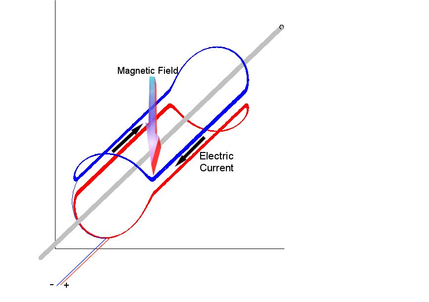

jneutron said:
Cube?
Ahh, I see the difference.. In my work, we consider the field falloff radial to the dipole. It is 1/R, with uniform field inside. For quads, it is 1/R squared, with 1/R in the middle. For sextupoles, it is 1/R cubed, with internal field 1/R squared.
You are speaking of a solenoid..
1/R? What structure did you calculate? It musn't be a finite coil in 3 dimension, because it have an infinite energy!
A monopole have an 1/R^2 field (at least in 3D). A dipole must fall faster! A dipole can be assumpted by 2 monopoles (+ and -). If monopoles are in (0,0,1) and (0,0,-1), then direction of force in (R,0,0) is (0,0,1), and magnitude is H=2/(1+R^2)*1/sqrt(1+R^2). If R>>1, then this is appoximately: H=2/R^3.
You can calculate it relative easily on a single turn wire frame too, but please let me not to do it!
Alas, it is but a simple confusion of terms.
To me, a dipole is a bending magnet for a particle beam. Not to be confused with a dipole such as is created by a solenoid.
http://en.wikipedia.org/wiki/Dipole_magnet
While this depicts a room temp magnet, I work with magnets where the current density of the cylinder is of the cosine (N*theta) variety...for dipole, n=1, quad n=2, etc.. This is of most use with superconductors.
While the topology of an accelerator dipole is that of a solenoid, we worry about the field off to the side of the dipole.
Heres a depiction of a simple dipole..the grey line is the direction of the particle beam. Within the structure, the field is uniform, outside it falls off as 1/R.
As you note, if it truly fell off as 1/R for infinity, there would be infinite energy. The 1/R relation is good for R <Length of magnet.
Cheers, John
Thank you for the explanation! I ment dipole in general meaning.
Indeed, your coil have 1/R field, if length>>R>>diameter.
And I realized that although a solenoid have 1/R^3 field in radial, but 1/R^2 in axial direction, so 1/R^2 is valid here. Your advice of rotating the coil 90 degrees off is a good idea.
