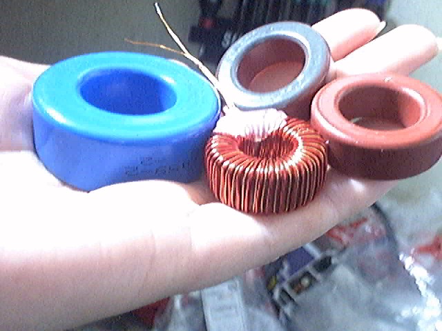

Now seriously speaking: Ready made inductors won't use cores suitable for class D (capable of cool operation under a strong AC flux), so consider buying some T106-2 and T130-2 cores (and maybe some of MPP on the same sizes) from online stores and building your own inductors. I have recently published a post with links to online stores that accept paypal.
Nah, the hand does not look soo good because I have been doing too much prototyping, I have a couple of broken nails
EDIT: The blue one is Arnold A-087059-2, it's 26u MPP. I use these for high voltage class D, they can handle 600 gauss at 50Khz without problem (and required inductance is achieved without too many turns).

It's risky to generalize about cores, but what I've found in that frequency range is that MPP cores are quite good, but if you want the absolute lowest losses for a given volume, you're better off gapping a high perm ferrite. The desired gap is usually quite small, .003" to .020", and I use a round piece of brass shim on a small motor, and a mix of carborundum powder and water (valve grinding compound). This will cut through one side of a toroid in a few minutes. A diamond saw is better, but very thin ones aren't usually available.

It's true that core losses of gapped ferrite are ridiculous but this comes at the expense of finging flux, eddy currents and extra losses in magnet wire. I did the first high voltage class D prototypes with gapped ferrites and even 120*.1mm litz wire was getting hot when idle with just 10Ap-p and 2.9A rms ripple (100uH 30A inductors on E42/21/20). Multiple strands of .71mm magnet wire were idling at 100ºC or so I got rid of all these problems with MPP.

It was 48Khz, 350V DC bus voltage, half bridge switched (+/-175) on two 100uH inductors in series, each one made with E42/21/20 ferrite with 6.4mm internal gap and 32 turns. With 3.2mm gap on all legs it ran cooler but at the expense of high stray field. The center gap version was quite "clean" as expected. The large gap was required to achieve 30A saturation.
The solution is MPP, and fortunately now there are companies other than Arnold producing it.

IMO, it comes down to one single question- what's the loss (1/Q) at your operating frequency and power level. Cores behave very differently over different frequency ranges, so you have to look at the data sheets. The MPP cores are available in several types, so just knowing it's an MPP core isn't sufficient- look at the curves. My experience was that near your frequency I could do better with the small gap in the ferrite, though the MPP was still very good. With a small gap, fringing isn't much of an issue. Are there data sheets for the core used with your new parts? For commercial products you either have to wind your own parts, or work very closely with suppliers so you know what the exact core is. I've never been very happy with the data provided with off the shelf inductors.
