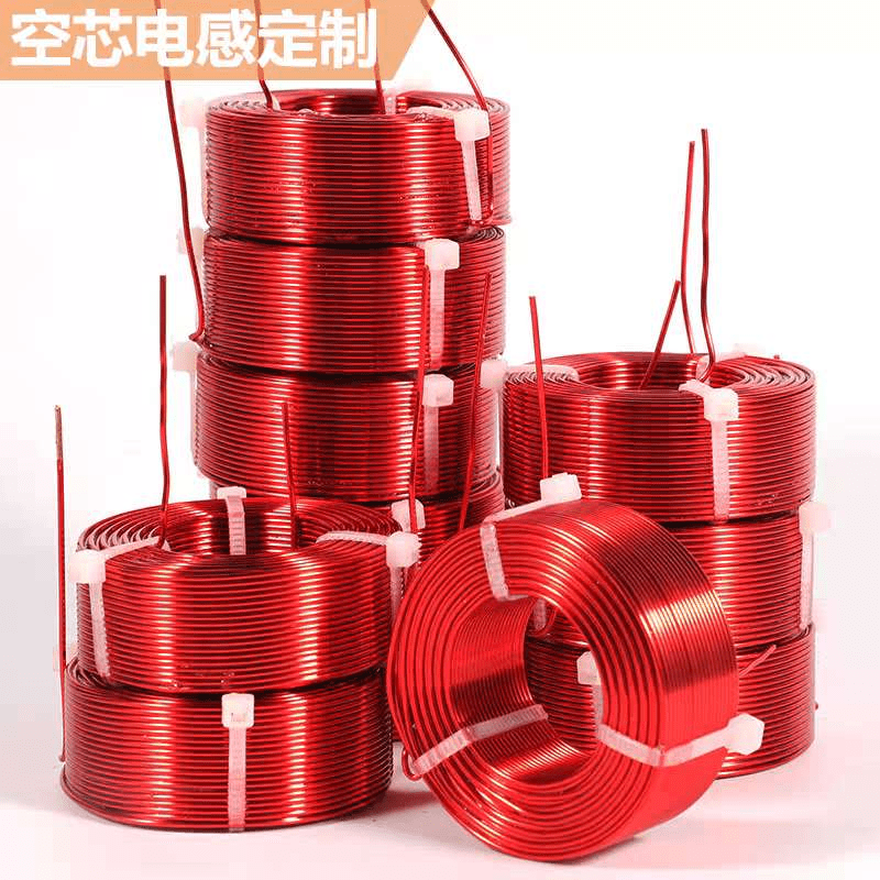

I found a company in China is able to custom made air coil inductor with vary DCR. I want to use this air coil type to replace the iron coil in the crossover. Any comments?
Assuming the copper quality is good and the DCR isn't drastically different, in my experience the air core chokes have been an upgrade over iron core in passive crossovers, especially in the mid and upper frequencies.

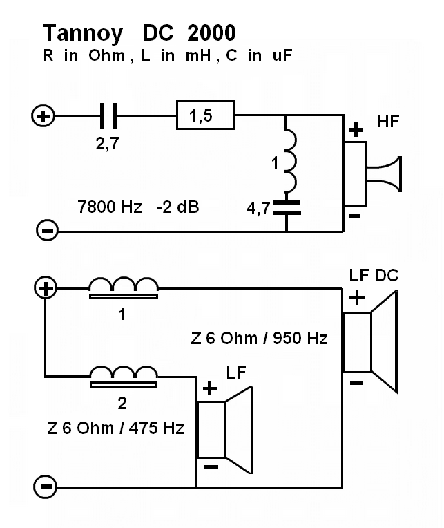

The OP is seeking to upgrade his 1 mH iron cored coil with an air cored one.
@Tubenstein:The DC resistance of the Chinese custom made air core coil should be as low as that of the iron core coil (typically around 0.2 ohm) in order not to alter the crossover function.
Would that be obtainable? You haven't given a link to the custom manufacturer so I can't see the specifications on offer.
Nor do we have we any information about your loudspeaker and its crossover circuit.
The Q of the air cored one will be different from that of the iron cored one. Benefit of the iron core is less DCR due to less wire required. It's a toss-up. An iron cored inductor can saturate when the iron is completely magnetized; the air core one will not saturate. Burn it out? Maybe. Saturate it? No.
I know, thank you. Just compare 3.3mH / 0.13R vs. 0.33mH / 0.15R you see on my picture posted above : DCR is similar, but L value is simply X10 for the Iron-Core... A 1mH Iron-Core inductance of " typically around 0.2 ohm" as you wrote is a poor one, as this is nearly what DCR you can expect from an Air-Core one of fair quality.
Assuming the Iron-Core is used for the Woofer, changing for an Air-Core that have nearly the same DCR will show no "upgrade". Only a lower DCR Iron-Core would bring a significant improvement on damping and transients.
Yes. And if it is for a Bass speaker, which usually requires higher L values, the advantage turns to the Iron-Core : the lower DCR is then the "upgrade" for a Woofer section, not switching to Air-Core... Unless you accept to put inside your speaker cabinet a flower pot-sized coil !

It may be helpful to know that the OP would appear to have undertaken an unspecified 'upgrade' of the 2 mH iron core in the bass section of a 3-way speaker. In that case, the 1 mH iron core he now appears to want to 'upgrade' could belong elsewhere in the crossover
P.S. I wonder why he hasn't supplied any further information about his loudspeaker and its crossover in order that members have something concrete to work on?
The point is that we don't know what is the DCR of the actual 1mH cored coil. Many mfg use a cored coil instead of an air core one simply for cost saving purpose. Sometimes they choose wisely, sometimes not (the chosen coil will saturate or distort easily). If for peace of mind the OP wants to remove this possibility, my advice is to replace the actual cored coil with one that has a similar DCR (*), and with a 1mH coil this should be pretty easy.
Just as an example compare 1mH air core and iron core coils from Jantzen Audio:
a 0.7mm wire cored has a DCR of around 0.4 Ohm, replace with 1.2mm wire air core (60g vs 250g)
a 1mm wire cored has a DCR of around 0.25 Ohm, replace with 1.6mm wire air core (100g vs 500g)
(*) The point is that changing significantly the DCR of a woofer coil will change the SPL of the whole woofer section, and this can be perceived easily.
