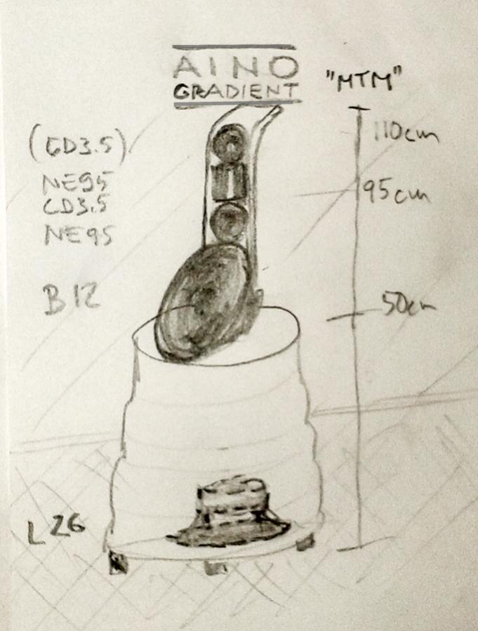

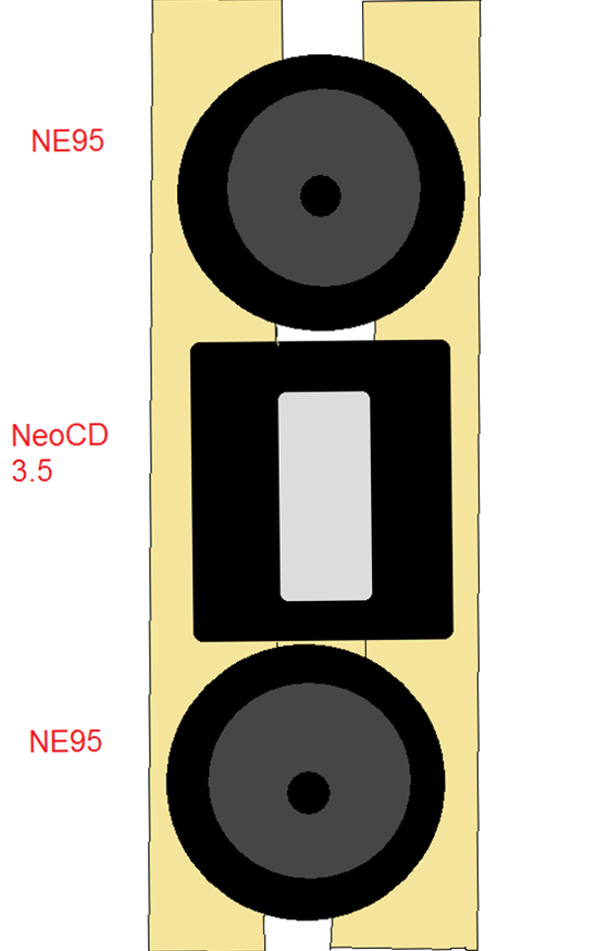

One more idea for the AINO tower before I go to bed,
a MTM Tower
two Vifa NE95s cost a bit more than one SS10F
The width of the frame has a minimum of 110mm
The body of NE95 is 95mm
The body of NeoCD3.5 is 98mm wide and 110mm high
The dipole peak is determined by the width of the system mainly (in Edge simulation)
MTM would give more vertical directivity than a single 4" driver
Looks like a saxophone 🙂
Yes, actually it does! My eldest son plays alto!

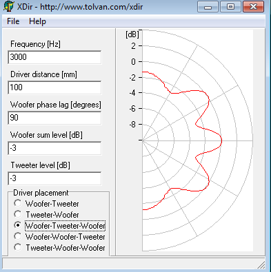

A MTM dipole section is familiar from NaO II of JohnK, but the frame is actually too wide for dipole function above 1500Hz
Here are Xdir vertical polar plots of a MT and a MTM with 100mm distance (center to center I guess) at 3000Hz

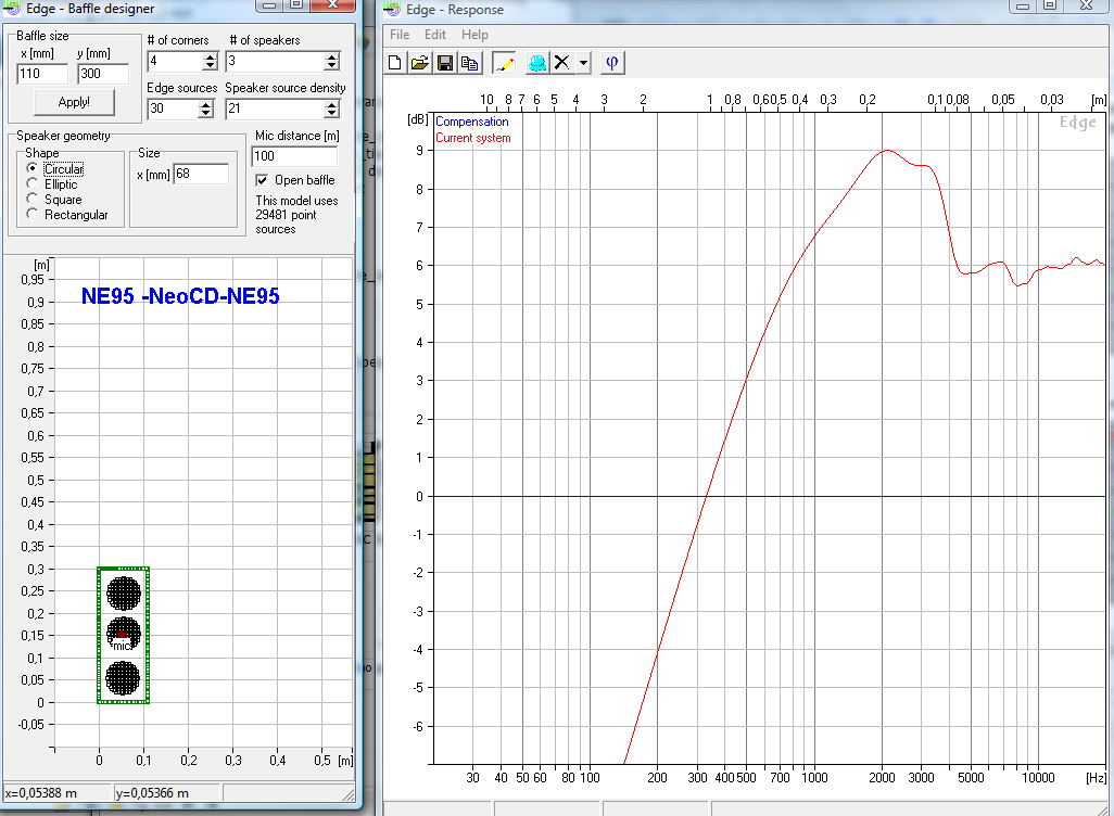

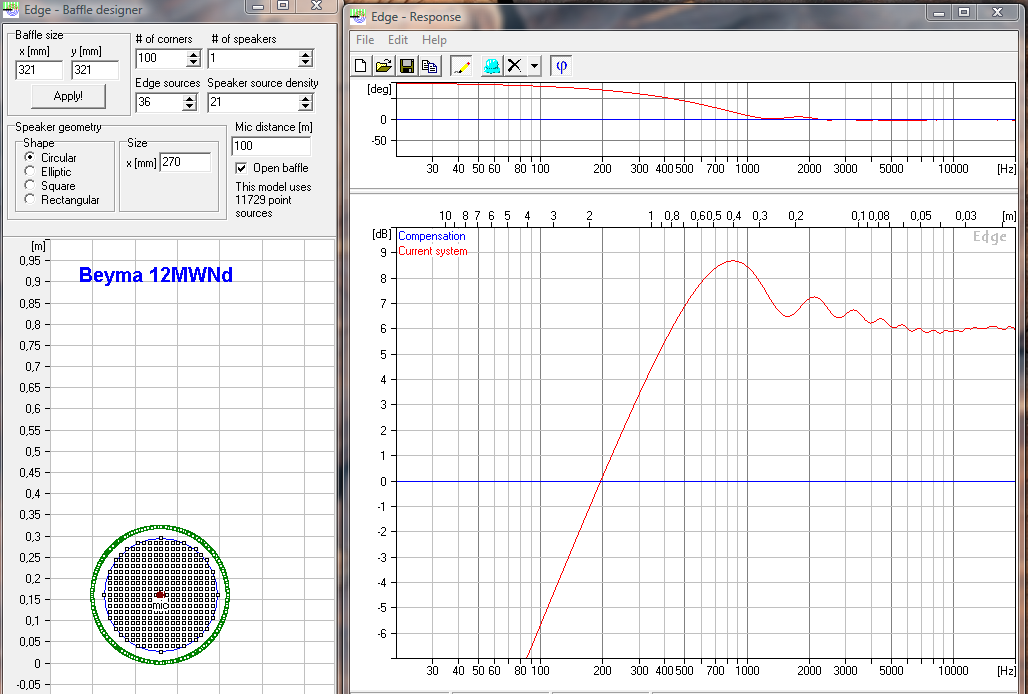

Here are on-axis Edge plots of possible low- and upper mid elements
LM = Beyma 12MWNd (own frame 321mm circular)
HM = 2xVifa NE95 in MTM with Fountek NeoCD3.5 (frame 110x300mm rectangular)
How would these match?

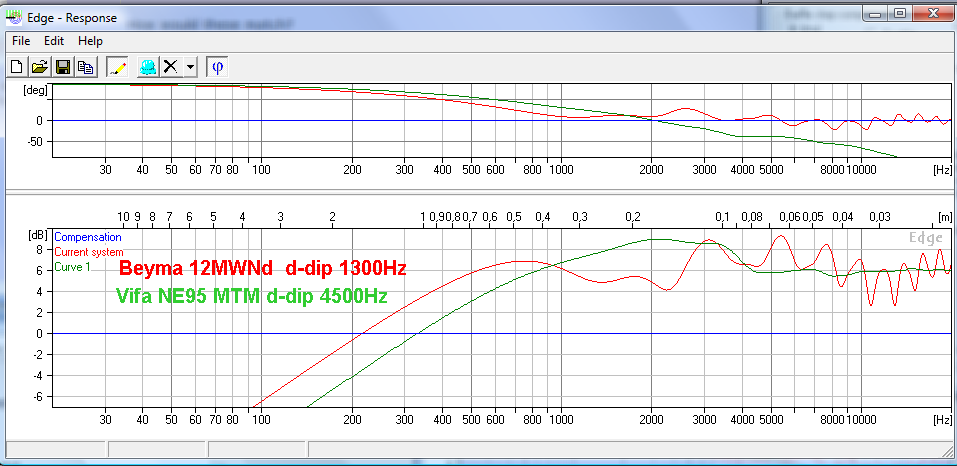

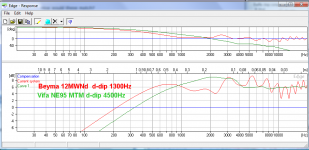

Here is an overlay from Edge of both Beyma and 2xNE95 in a more conventional scale.
Sorry sondek12 and Rudolf, I am a slow reader. The learnig continues..
Loooking good however, if I understand!

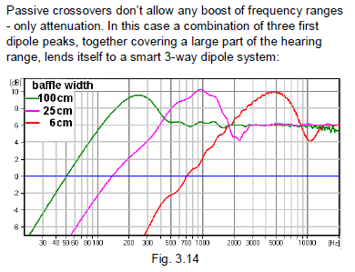

I've been thinking of xo points and slopes lately. John K's NaO Note II RS pages are a treasure for me. John has ended with using mainly LR4 slopes with miniDSP. I have been thinking of doing BW3 however. My selected drivers don't have nasty peaks. The dipole arrangement makes it's own slopes that can (and should) be used as adjuvants.
The xo solution has to be set taking into account thse issues
- axial measured spl-curves in my real system
- the dipole typical spl dip and loss
- the horizontal dispersion of the drivers at xo frequency
- driver cone excursion limits
- driver distortion/Fq behavior
- etc.
