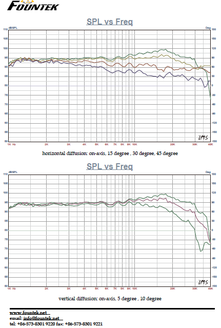

This new NeoCD3,5 is even better, and the price is less than 100€ per unit.
The dispersion graphs are promising and there is a built-in impedance correction!

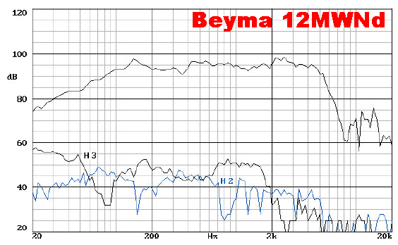

For the mid, seems that alla Beyma woofers of 15" have rather high distortion and ragged response.
This neodymium 12" might be the choice http://profesional.beyma.com/pdf/12MW%20NdE.pdf

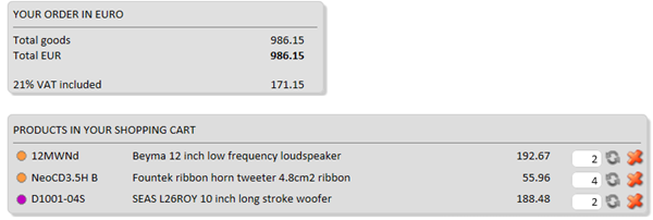

Driver choices of tonight seem to settle down to this (pic)
- bass SEAS L26ROY or Peerless XXLS12" (Daytons are not in stock in Europe)
- mid Beyma 12MWNd
- tweet Fountek NeoCD3.5 pair
I think that I will order the parts soon, but I'll wait a couple of more days.
The minidsp is under investigation too
The amplifier solution is open
I'll make a test mockup first. The bass cabinet is difficult to make, perhaps glassfiber, concrete or some delicate woodwork. The mid is the most critical component of Aino gradient. The spl (no breakup!) and distortion of 12MWNd are the best I have seen so far - and it looks very sexy too!

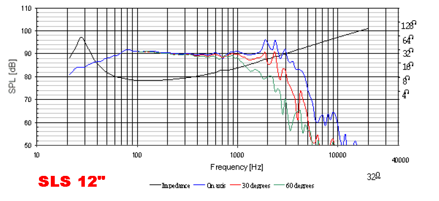

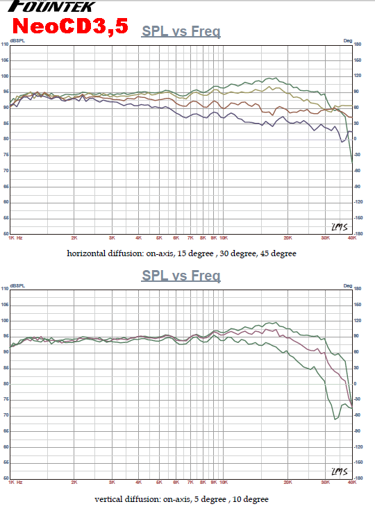

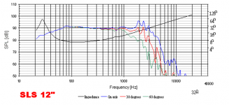

Can someone show here, what kind of low end response can be expected from a 12'" driver without a baffle?
The bass sound is not localized <200Hz in normal size rooms. I am aiming to set W/M xo at 200-250Hz with something like LR2 acoustic slopes. It would be nice if the natural roll-off would help.
The M/T xo must be set so that directivity match is optimal. With 12" and Neo3,5 that means something between 1500 and 2500Hz. The other tweeter shoots upwars, making a source for roof reflections and thus "spaciousness" to the sound.
Here are directivity graphs of a 12" (SLS12) and Neo3,5

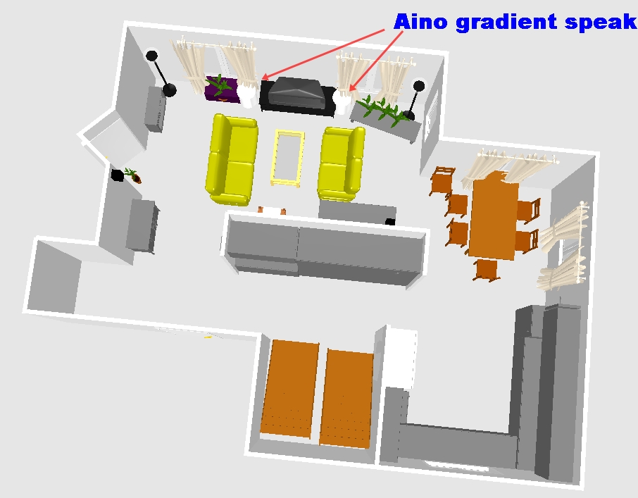

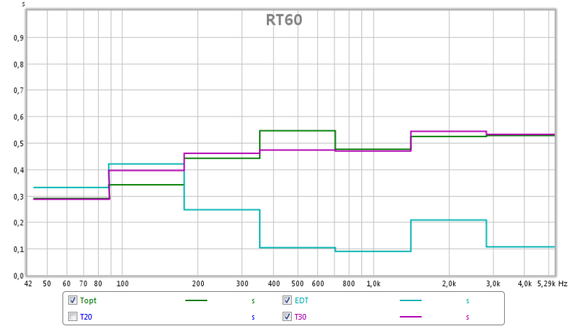

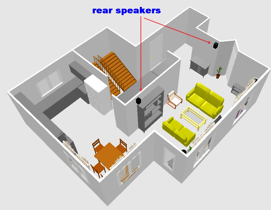

Here are views of the room where Aino gradients will be placed (not all of the 1st floor shown). The shape is basically rectangular but has many openings. The roof is tilted, higher towards the midline of the house. The dimensions of the rectangular area are w 5,8m d 3,6m (21m2) the height is 2,6 to 3,8m. The floor is concrete with wood laminate. Walls are plasterboard with insulation. Outer walls are 40cm and inside walls 12cm thick. The ceiling is wood.
RT and EDT are in the graph.
