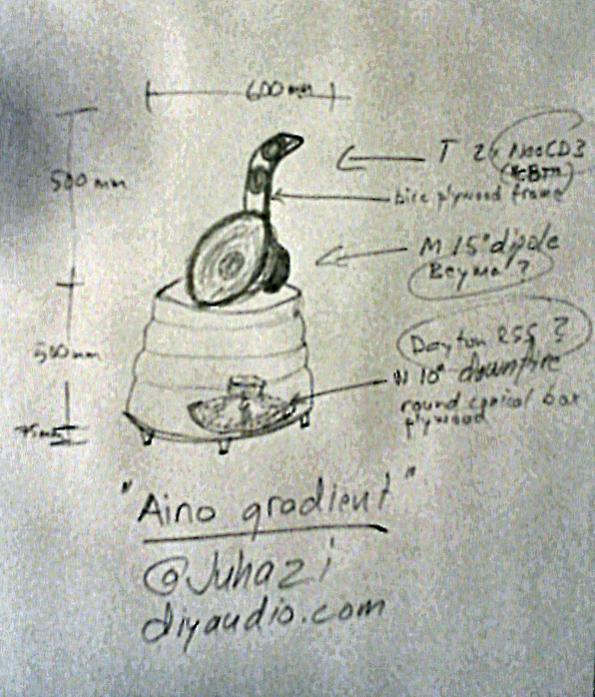

Ok, and now some concretia..
Using a minidsp give us more possibitities of usable drivers and we can also use passive components too.
The bass bin could be a closed box of some 30L and the driver Dayton RSS315HF-8 Dayton Audio RSS315HFA-8 12" Reference HF Subwoofer 8 Ohm - Subwoofers - Loudspeaker Drivers By Type - Loudspeaker Components. The lowest end should be pushed up in the xo (minidsp) The original was a br box but I like the closed better for impulse and phase behaviour. The boost might be minimal due to floor gain
The dipole mid should be a 15" which has clean midrange, minimal breakups and a light cone. Cone flexing at high frequencies is an advantage here! Perhaps some JBL pro or Beyma 15LW30 http://profesional.beyma.com/ingles/pdf/15LW30.pdf
The tweeter line of the grandmother has four 2" -2,5" paper cones, but perhaps it is wiser to make a 4-way using a supertweeter? four 2,5" cones with a cascaded LP and OW1? Peerless has many options Full Range | Tymphany
The xo frequencies and filter types give the grain of salt here. Matching the real acoustic properties and transition zones between the segments is the key to good sound. There is some theoretical and practical info but experiments and listening tests are of crucial importance here.
I say - take a big Pro coaxial, put it bare on the floor, tilt it towards listener, if You like it more this way, then equalize, and BABAM! - this is it 😀
or at least very likely it may be 🙂

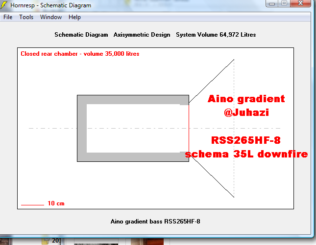

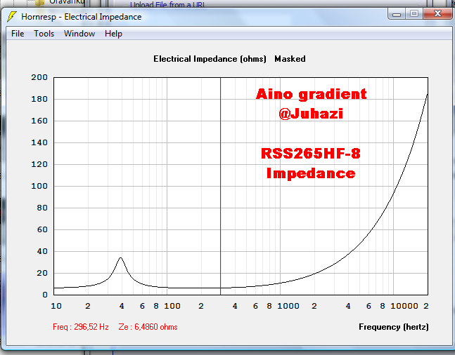

I made some Hornresp simulations of the bass box.
Dayton RSS265HF-8 would be ok. I used 35L closed box, lined (Qtc=0,76).
RSS has a copper coil and suitable VAS and Fs and seems to give a quite nice spl curve with some horn effect and boundary gain. The horn comes from the space between the box and the floor. Because it is on the floor I used 1,0Pi environment. The horn segment should be exponential, but I could not get it.
This has the typical features of a closed box - good impulse response, good phase, low GD, minimal cone movement 1,0mm@30Hz, 85,6dB .
We need to have the bass to do 30 -250/300Hz

Here is a manual sketch of Aino gradient. Sorry about the quality - it is quick and dirty!
The mid seems to settle to Beyma LW30 so far.
I think I could use two Fountek NeoCD3 ribbons as tweeters. Look at positioning! The frame for tweeters is birch plywood bent to an angle of 45-60¤. This makes kind of two-pole CBT. Perhaps they need sort of wave guides on their sides (wings).
