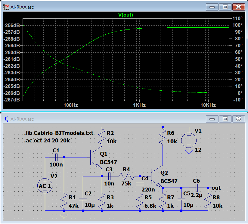

Thanks for all the fine help and discussion, it was an attempt to use a tool, and try to understand some electronics in the process of having a conversation with the group all while testing the limits of AI, (ive had success developing very complex python based GUI software with Grok) guess that's too hard to conceive of in an internet forum.
part of the issue is that GROK can't draw, so It's giving me directions on where to wire things. I'm using kiCad fro the first time here so some of this is most likely me. This is how he's giving it to me :
in Right --- C1R (0.1µF) ---+---- R1R (47kΩ) ---- GND | | +---- Base Q1R | | | +---- Emitter Q1R ---+---- R3R (1kΩ) ---- GND | | | | +---- C2R (10µF) --+ | | +---- C3R (0.01µF) --+---- R4R (75kΩ) ---- Base Q2R | | | +---- C4R (0.22µF) --+---- R5R (6.8kΩ) ---- GND | +---- Emitter Q2R ---+---- R7R (1kΩ) ---- GND | | | | +---- C5R (10µF) --+ | | +---- C6R (2.2µF) ---- Vout Right

Just for fun (I've fixed the grounds to see what the actual circuit does):
To be expected, since the bases aren't biased. Even if they were, you'd have two emitter followers one after the other, so no gain. And that's before even getting to the RIAA eq part...
Good advice above. This is the wrong tool for designing circuits or even just learning about electronics. Search the forum, get a good book (e.g. Horowitz & Hill "The Art Of Electronics"), visit Rod Elliott pages, ask questions here. We'll be glad to help.

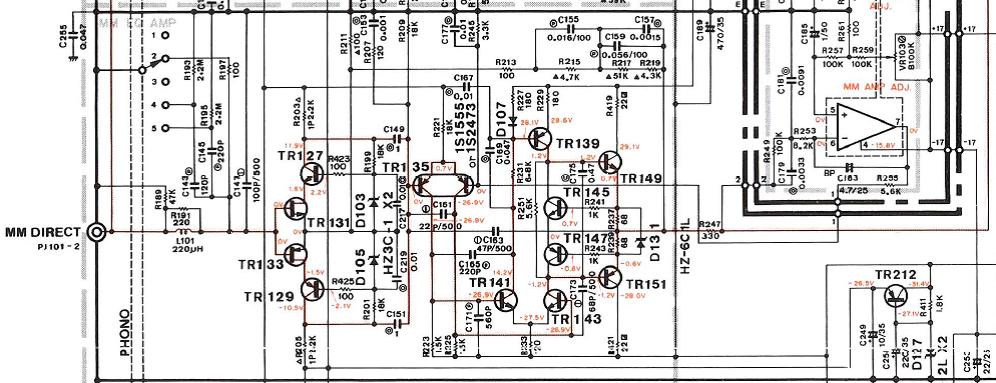

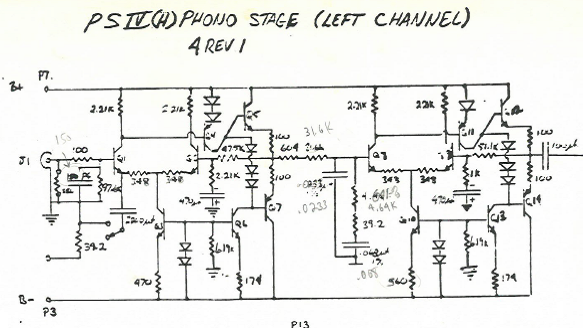

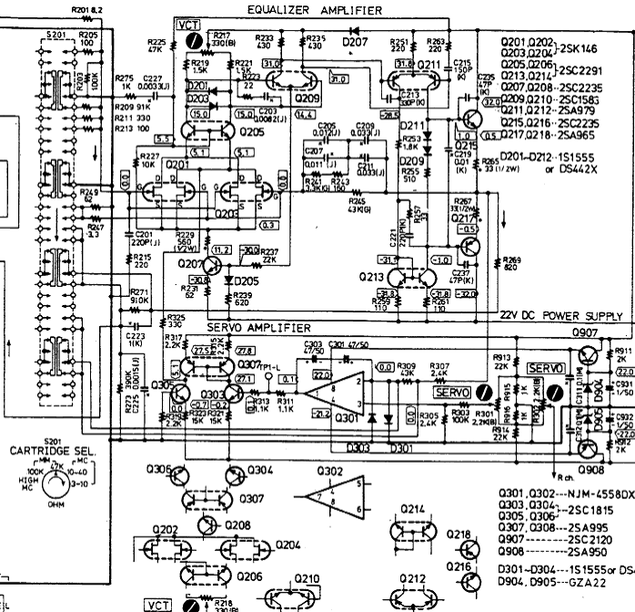

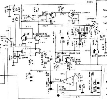

Here are few solid state phono preamps i tried which were designed by human brain, not arteficial stuff.
Although i still have three tube phono preamps, mostly tim deparaviciny clones.
