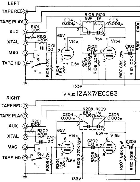

As suggested, I did look at the schematic and there is supposed to be a 1.5K ohm resistor in that position. But since what's there now is blue, it is newer than original.

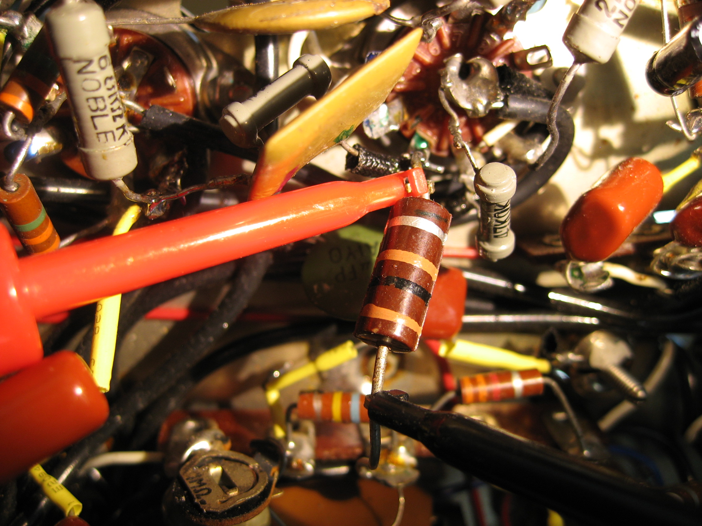

And doing that drew my attention to another resistor that's different from what's on the scehmatic as far as I can tell. This one goes from pin #3 of that same 12AX7 tube to ground.
What is in place looks to be banded brown/black/brown = 100 ohms. I measured it and it's 119 ohms. The diagram claims another 1.5K ohm resistor should be there.
The attachment is that resistor - I estimated it as being 1/2 watt.

Measuring four plate voltages shown on schematic should tell you where to look.
More accurately, it would tell you where to look.
If 12AX7 plates are pins 1 & 6, the voltages I measured are not what the schematic says.
The tubes are referred to as V14 & V15. And as long as I identified them with correct orientation:
V14 pin 1 should have 65V and V15 pin 1-85V.
My measurements were V14 pin 1-82V and V15 pin 1-135V
V14 pin 6 should be 65V and V15 pin 6-85V.
My measurements were V14 pin 6-125V and V15 pin 6-135V.

Disregarding the feedback network, on pins 3 and 8 of V14, there should be nothing but a 1.5K resistor-to-ground on those pins.
Anything else is improper, and must be corrected, period.
Putting your meter on those pins and to ground, should read 1.5K give or take a bit.
V14 is used obviously for both channels - the schematic clearly shows that (a/b).
The same goes for V15 (a/b)
And those measured voltages are way off. - troubleshoot the plate resistors down to the power supply.

I agree that the circuit components should match the schematic. I have no knowledge why a 100 ohm resistor is located where a 1.5K ohm should be.
Regarding the 4 plate resistors, those immediatly connected to the pins, two are bad - producing an OL reading. They are the gray kind (wire wound?) as it happens. The ones I thought were not susceptible to failure.
V14b pin 1 - 2W 270K ohm
V15b pin 6 - 2W 68K ohm
And how about that. V14b & V15b is right channel, the side where the problem exists.

They are both carbon, common 1/2 watt values, check the other channel's plate resistors as well - if in tolerence (10 or 20%?).
12AX7's don't draw much current, and there's no need to go crazy with parts.
The slob that put that 100 ohm in there must have done it to increase the level, decrease feedback, or whatever.

The Digikey resistors arrived late last week but during the course of soldering them, another resistor broke in two. I waited until the local, small town parts/repair place reopened after a stat holiday and got lucky. They had 2.2M ohm resistors on hand which was what broke.
Replacement resistors seemed to have done the trick in that both phono channels are playing at the same volume level now.
It was a bit odd, and dismaying when I removed the two old resistors I had my eye on. Both produced a repeated OL reading on the meter but they tested within spec once removed.
