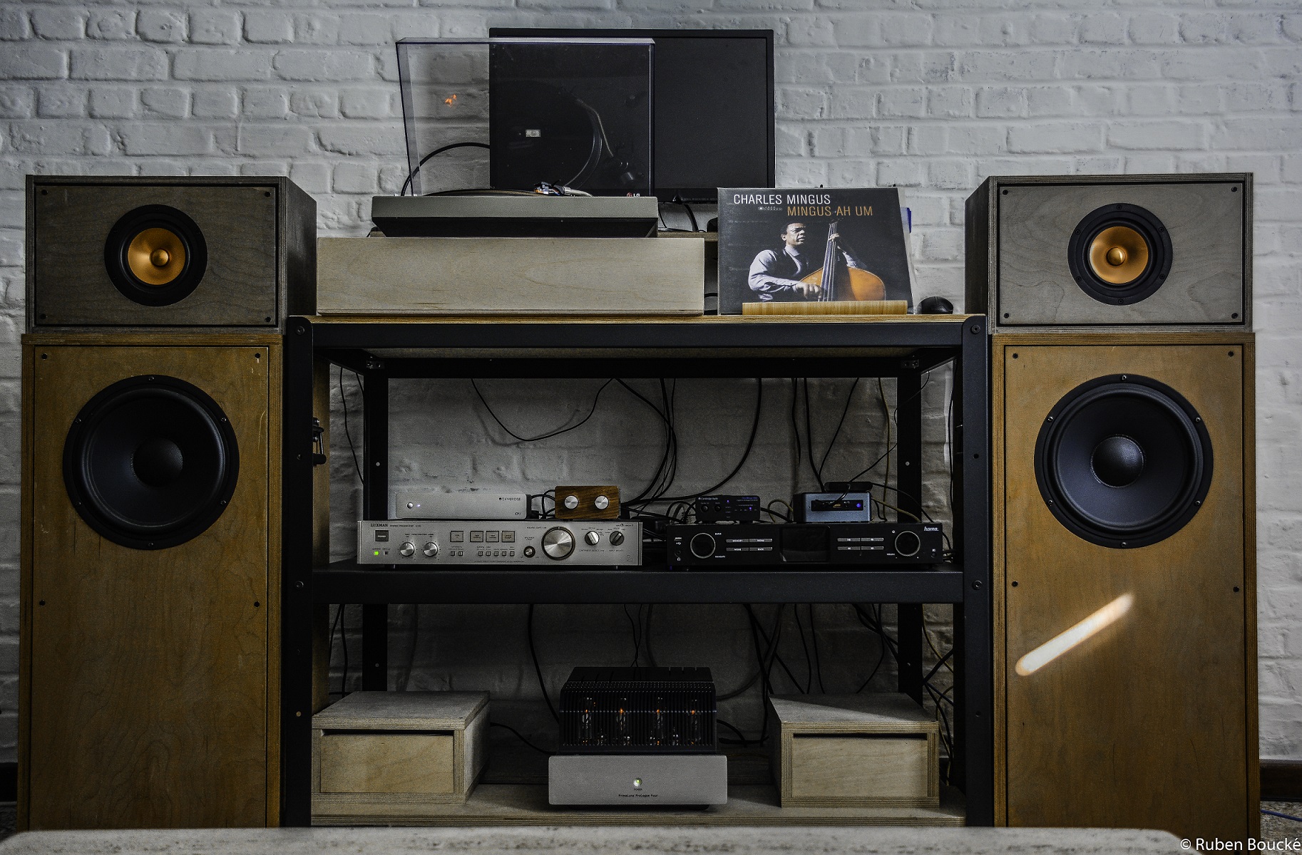

I would build that waw that i mentioned and already did build. The waw (woofer assisted wideband) is in my case a Mark Audio 10.3M fullrange in a 11.5L sealed cabinet build following the BBC principle of a mass damped lossy thin wall cabinet (like the infamous LS3/5A) and a Scanspeak 26W/8534G00 (sub)woofer in a 77L sealed cabinet. I use a passive serial 1st order crossover at 250Hz with notch filters build in to flatten the sound. I amp it with a 32w push pull tube amp with EL34 tubes. I have no drawn plans for those (someone will do that soon), but something similar could be great. But that is an own custom design that took a lot of work and (i hope) design skills to get it right. Mine has a good response to about 32Hz. Picture is it in my actual setup. The wooden boxes next to the tube amp contain the filter network as the parts (especially the coils) are rather and heavy big to put them in the box.
I thought Dave (Planet10) has a design for a waw that also works great using Mark Audio Drivers that you can get from him. It's one of his favorite sets of all he builds he said... Info is found here: Alpair 12P, and helper? Design Question
