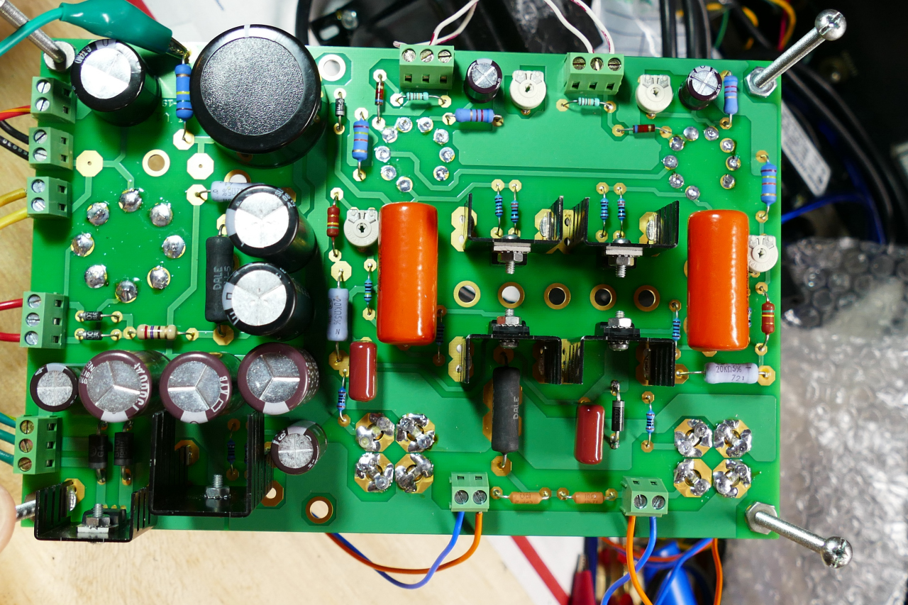

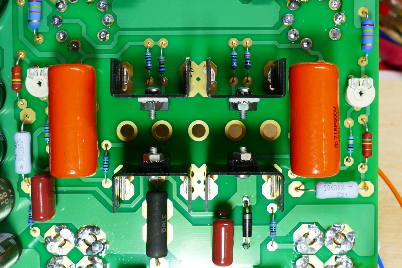

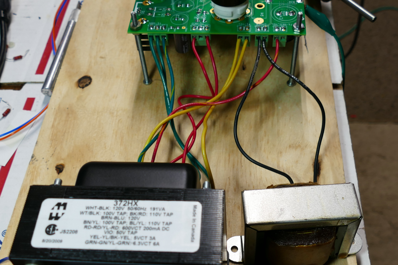

Here are some pictures of my working 2A3 board. It has also been used with 45's, but the power transformer must be changed. 45's don't like 400 volts! The Chinese 2A3's don't seem to care and give me a bit over 4 WPC.
Some of my parts are not exactly correct. I used what I had where it doesn't matter. I see a 6.2 K carbon comp where a 4.7K is specified. Anything from 4.7K to 10K will work fine. I also used 1/2 watt 620 ohm resistors where 1/4 watt is called for. There are probably a few more such cases, but the correct parts are on order, and will be used for the assembly manual photos.

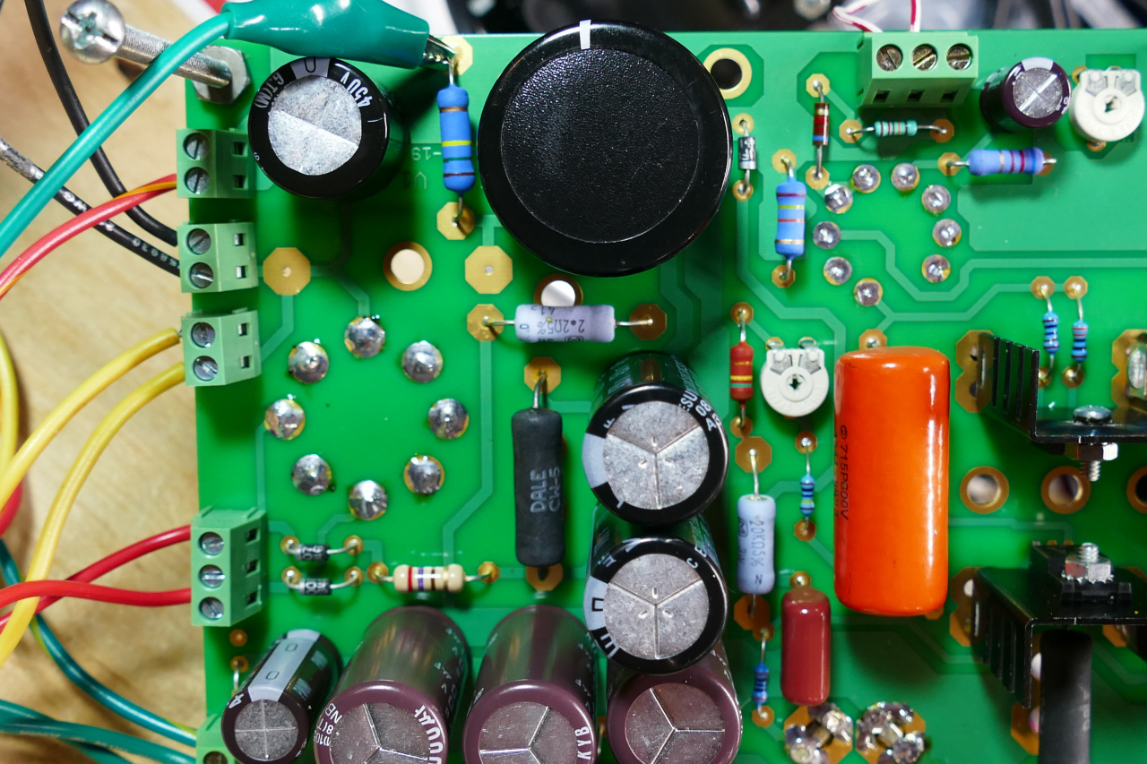

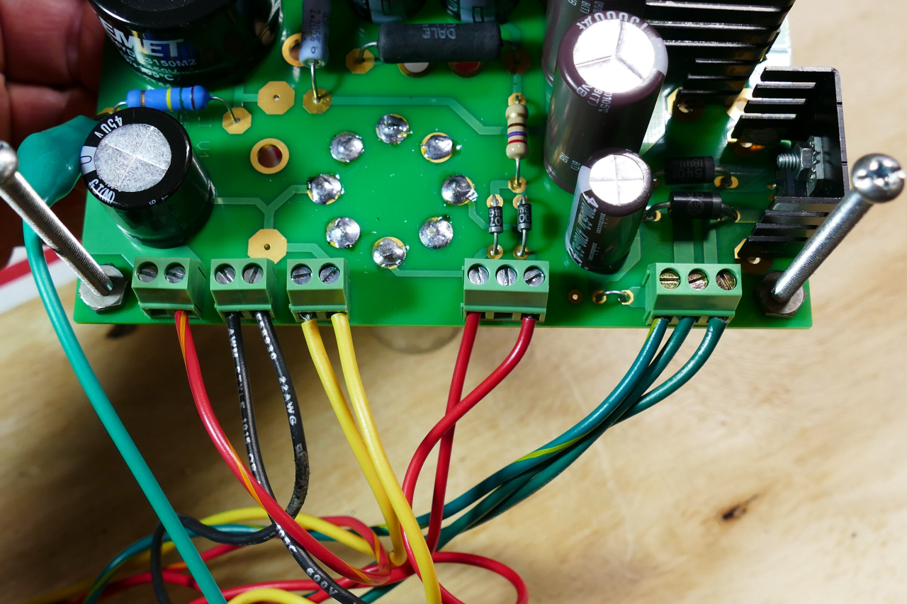

The green clip lead is the voltmeter ground. I was taking voltage readings while twisting the Variac the other night when the volume pot hit the heat sink.
Is there an advantage to using 1/4 watt resistors if one already has 1/2 watt resistors in the appropriate values?
If your resistors fit the board, use them. The parts dissipate 50 milliwatts worse case, usually about 20, so that any 620 ohm resistor will work.
My 1/2 watt parts are a little big for the board, but work. I just got a few of the "correct" parts to be used to make pictures for a build manual similar to the SSE and original TSE.

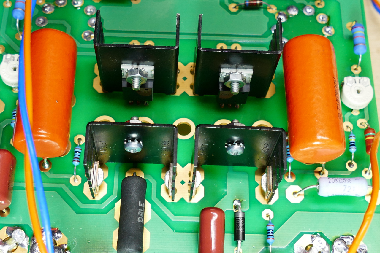

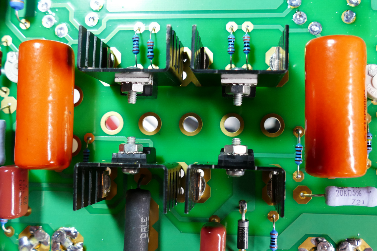

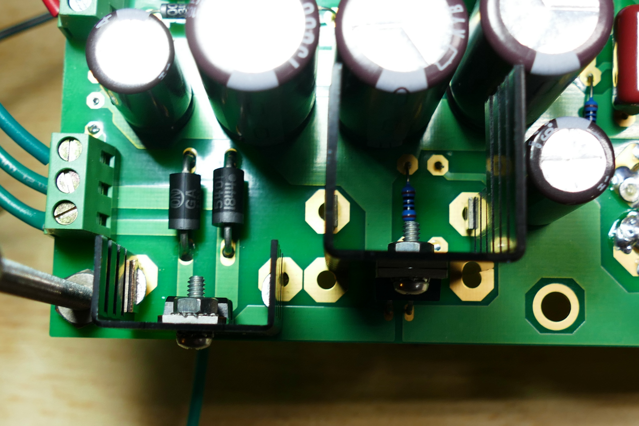

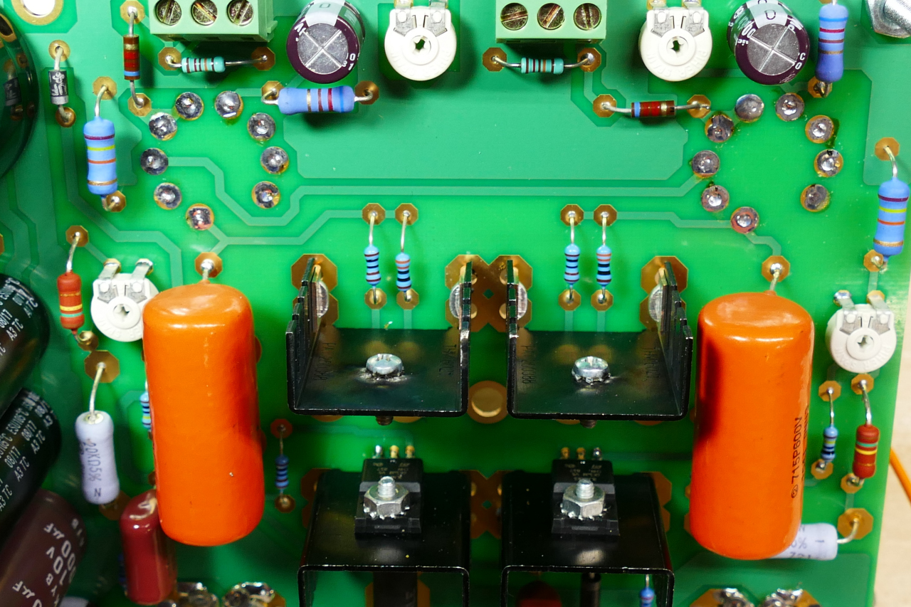

A few more pictures showing the heat sink detail when mounted on the under side of the board.

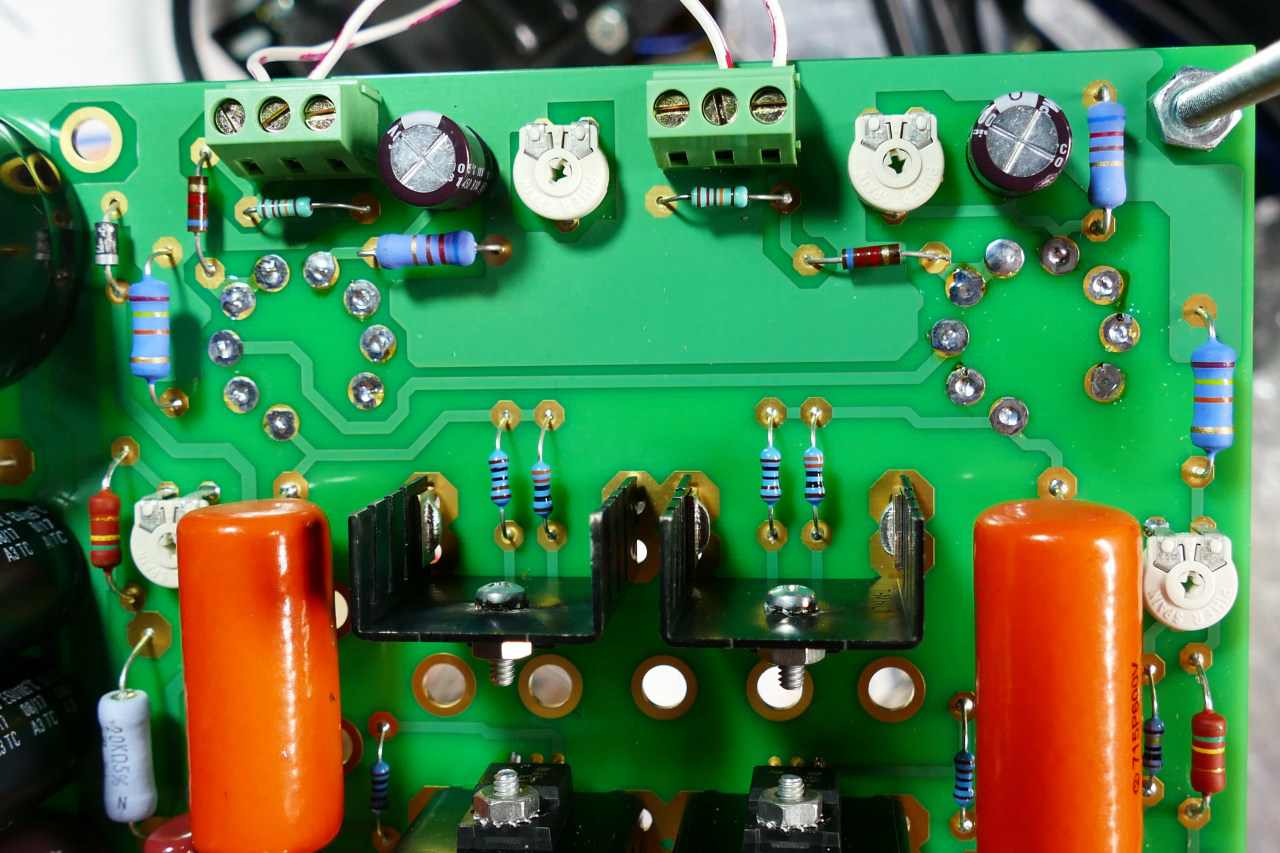

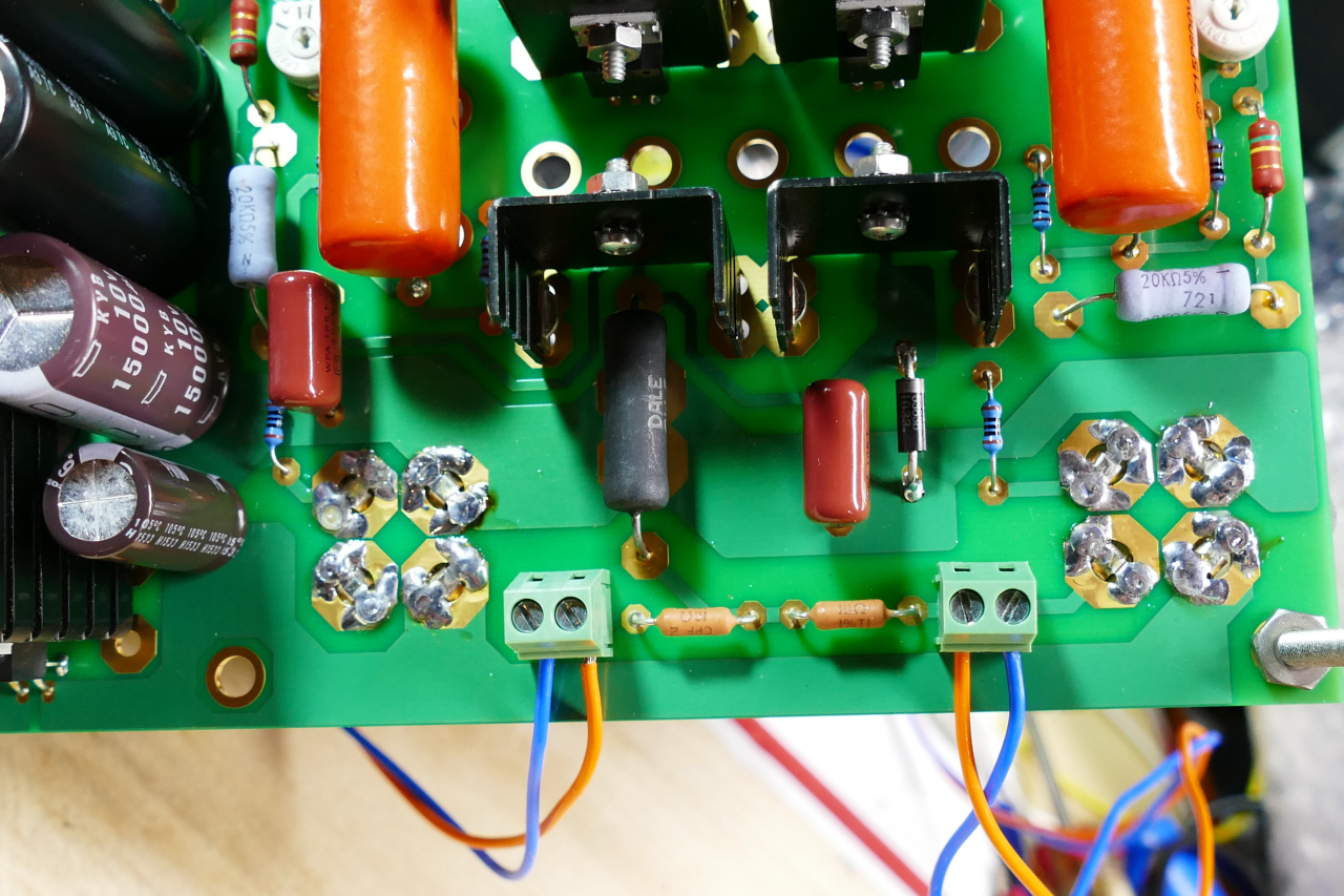

I have temporarily moved R2 and the jumper to the top of the board for easy voltage changes. It can be mounted there permanently if it does not touch the chassis plate. I still don't have any 300 ohm resistors, so mine is a 100 ohm and a 200 ohm in series.
I have 300B's in the board now, and will be doing some experiments with higher voltages in the near future.....first stop 5.5 volt 307A's wired as triodes. They worked nice in the older boards. I should have some 811A's somewhere, but haven't seen them in years......maybe they didn't make the big move.

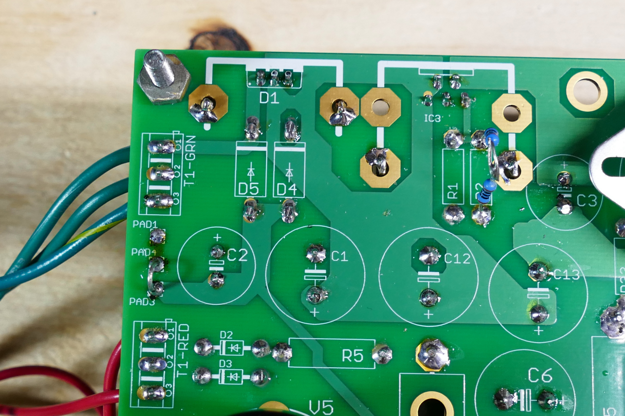

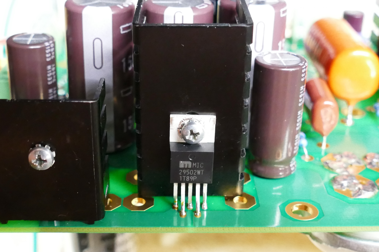

D1 is reversible and can be mounted on either side of the heat sink. IC3 is not. It comes with the leads flat, and they must be formed differently depending on which side you mount them on.
It is helpful if the parts are mounted on the heat sinks with the screw heads facing the edge of the board. This makes it possible to change a part without removing the heat sink.
The heat sinks have tabs that fit into holes in the board. If the amp will be subject to vibration or rough handling, these tabs should be soldered into the board. I usually will tack solder one or both pins so that the heat sink won't fall out during assembly. Some builders don't solder them at all.
