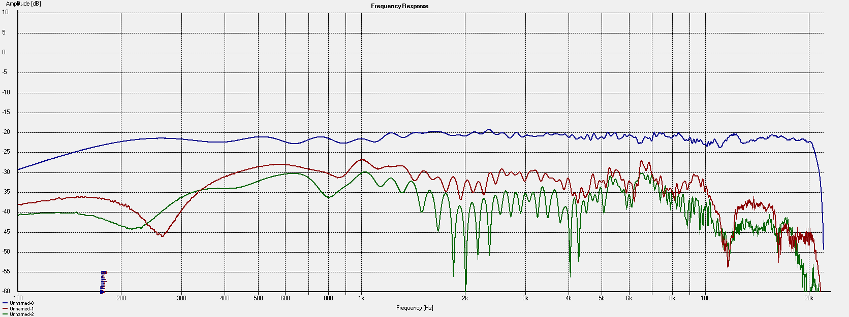

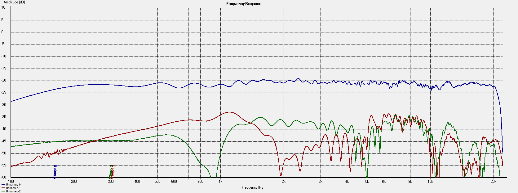

Measurements all around ...
It took me a few goes to find a way to measure all round Juhazi suggested in post #25.
The cables are too short to rotate the speakers in the middle of the room, so I compromised and did a bit of rotation and measured two quadrants (front right, rear left) plus some extra measurements moving the mic. Part way through I realized that the acoustic center is not exactly where I expected, so I probably rotated around the wrong point by about 2cm, somewhere close to the rear surface of the baffle (in other words the dipole null is not at +/-90 degrees from the listening=tweeter axis, but slightly behind.
Another compromise is measuring at 80cm and 15 degree steps. I positioned the mic within 2cm of the correct azimuthal position and about 1cm radially, from the 3D center of the tweeter, which was probably not exactly the true origin, as noted above.
All measurements are using Holm Impulse. All the measurements in this series are gated below 200Hz. I tried to keep the same gating, but had to change for a few angles on the rear right quadrant, as I couldn't rotate the speaker enough and was getting close to hard furniture, that's fixed in place.
I thought I was gating out the floor bounce in these measurements, but I think my eye was distracted by a mid-tweeter impulse at a similar distance from a table, and the floor bounce from the bass drive was in most of the measurements at 80cm. I had put some cushions etc. on the floor, but should have checked more carefully first. The effect is a bit more ripple than I need have had. If the gating mark for a channel can't be seen, it's behind another one on the plot, not off the plot.
The axis is zero degrees, I'll use R for measurements as I moved the mic rightward and backward, and L for measurements to the left of the axis, leaving 180 degrees for the rear.

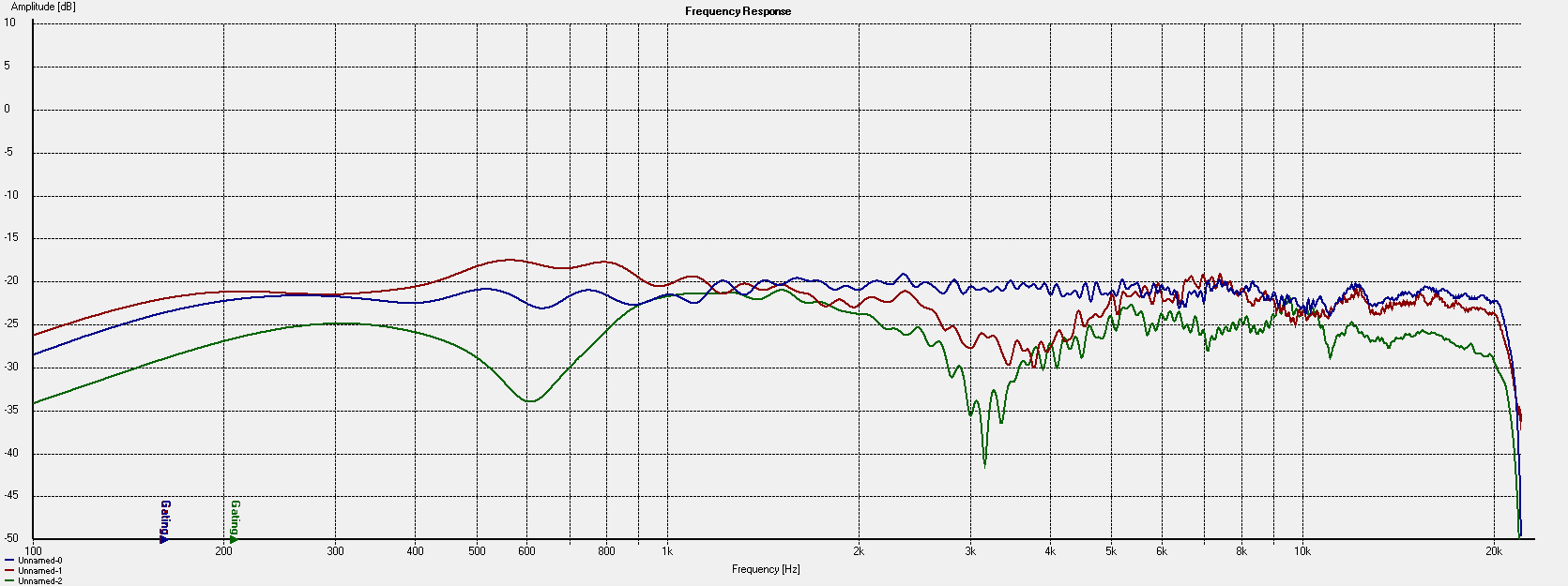

Before embarking on that, as a prelude I investigated the mid-tweeter crossover, as it was meant to have it's first lobe on the ceiling bounce direction, so I was hoping for a really good match of ceiling bounce spectrum to the direct spectrum. For the floor bounce I'm relying on my brain to figure it out. More thoughts on that below, stimulated by an observation during the measurements.
The on-axis curve (blue) is left for reference and I'll note the red and green curves in that order each time until otherwise stated.

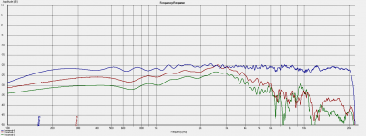

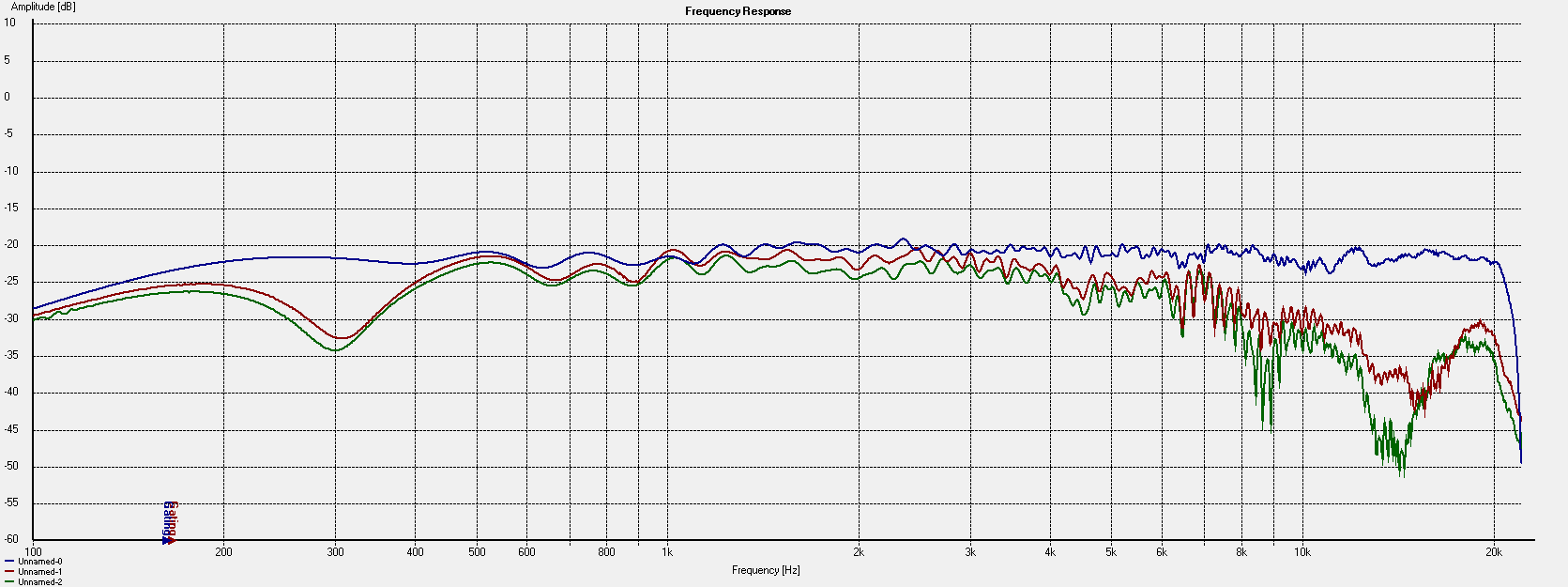

Vertical measurements on-axis horizontally
First plot - 0, 15 degrees up and 30 degrees up. The null at the mid-tweet XO is meant to be around 22 degrees (forget exactly) such that the ceiling reflection, a bit under 45 degrees up is in the next lobe. The +30 degree curve needed shorter gating due to the ceiling reflection.
Second plot shows the response at roughly the angle corresponding to the ceiling reflection at the listening position, but measured at 80cm. The mic positioning is less precise here than in most measurements. The bass-mid crossover shows up in excess, but the choice of close-mounting the GRS mid and tweeter worked out (for my room). I'm really happy with this (perhaps I shouldn't be, but it's the best I've made).
Long enough - next post the first half of the horizontal measurements.
Ken

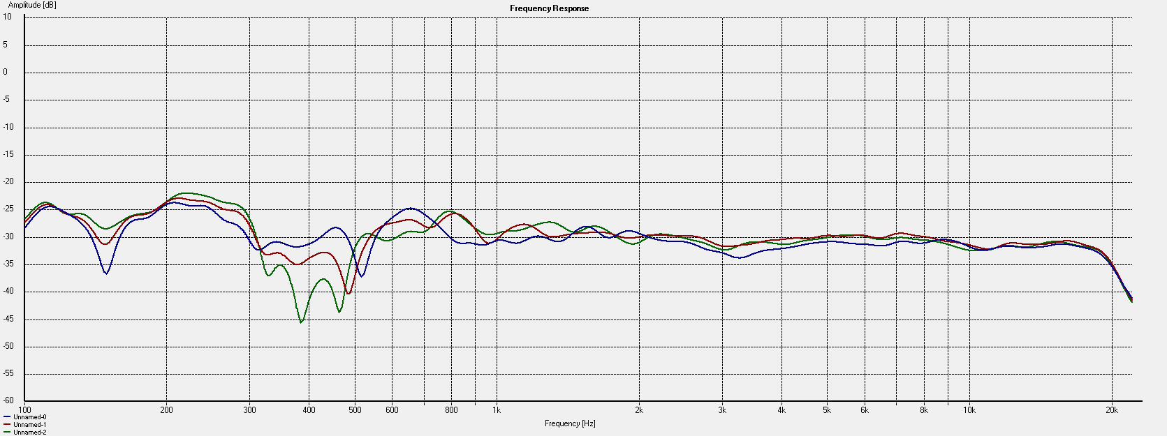

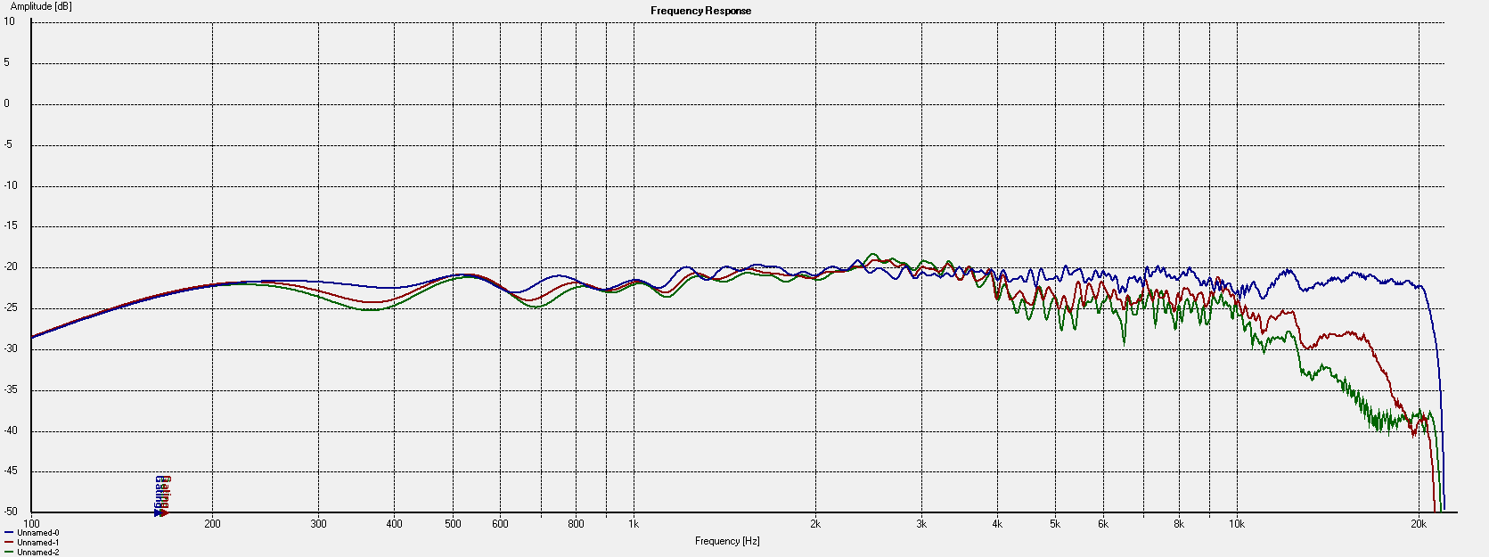

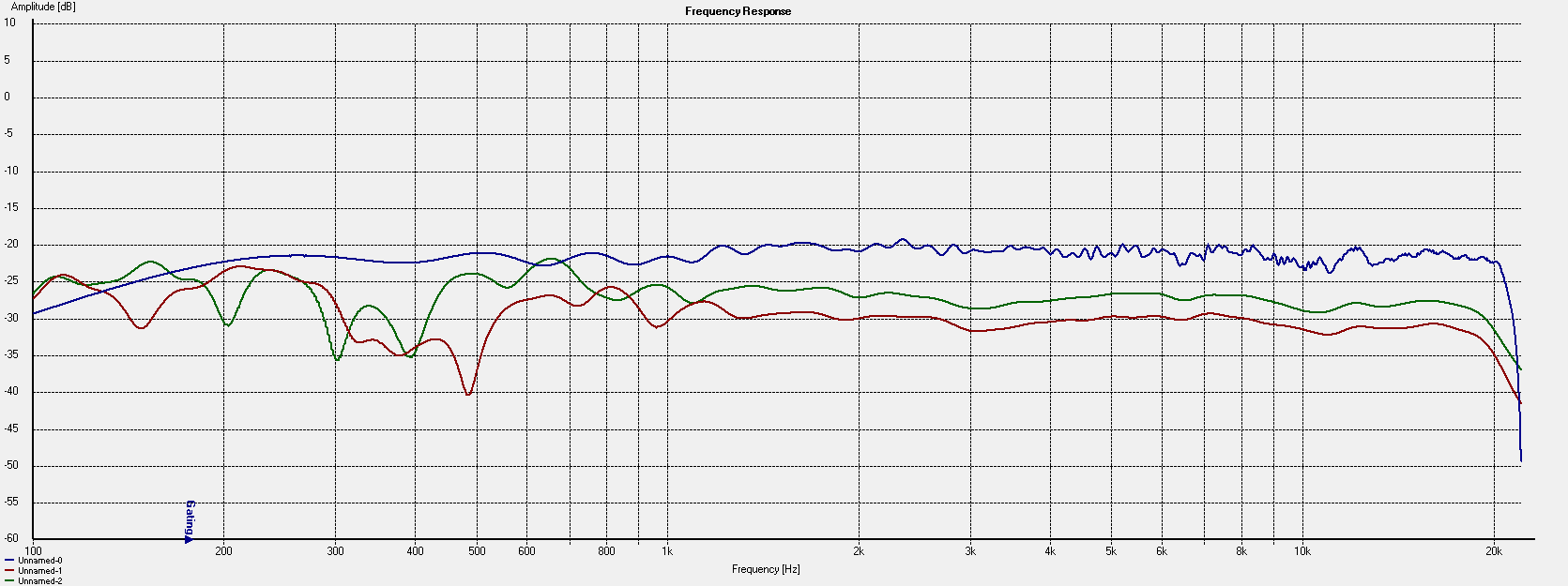

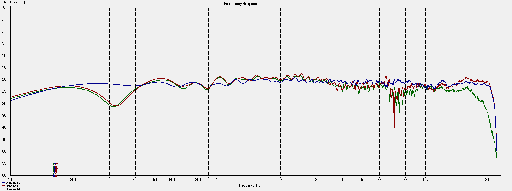

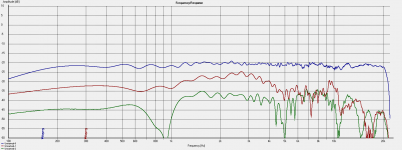

Measurements, horizontal to the right
See the previous post for details of the measurements. I'll keep this one to results and comments.
Plot one: on axis (blue); 15 degrees (red), 30 degrees (green);
Plot two: 0, 45 and 60 degrees;
Plot three: 0, 75 and 90 degrees;
Plot four 0, 97 (approx) and 105 degrees;
Observations
-the response is reasonably flat out to 30 degrees, these are meant to cover a modest listening area, toed in with ear on the tweeter axis. In stereo, by ear, I find it hard to sense a problem with the fall off out to that angle.
- especially at 45 and 60 degrees, there's excess energy at the mid-tweeter XO - deviates from the dipole response around there
- 90 and 97 degrees bracket the null for the tweeter, the latter is close to the null for the mid
180 and other angles behind the speaker are in my next post.
Ken

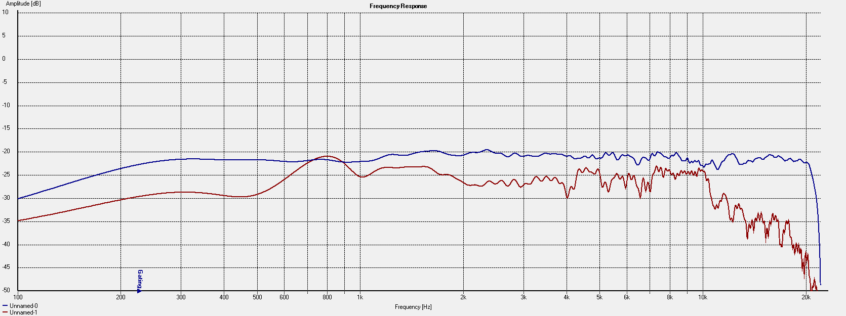

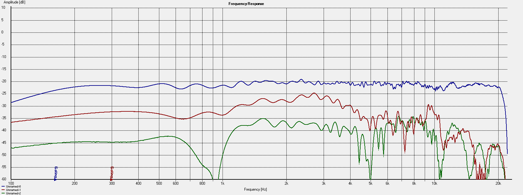

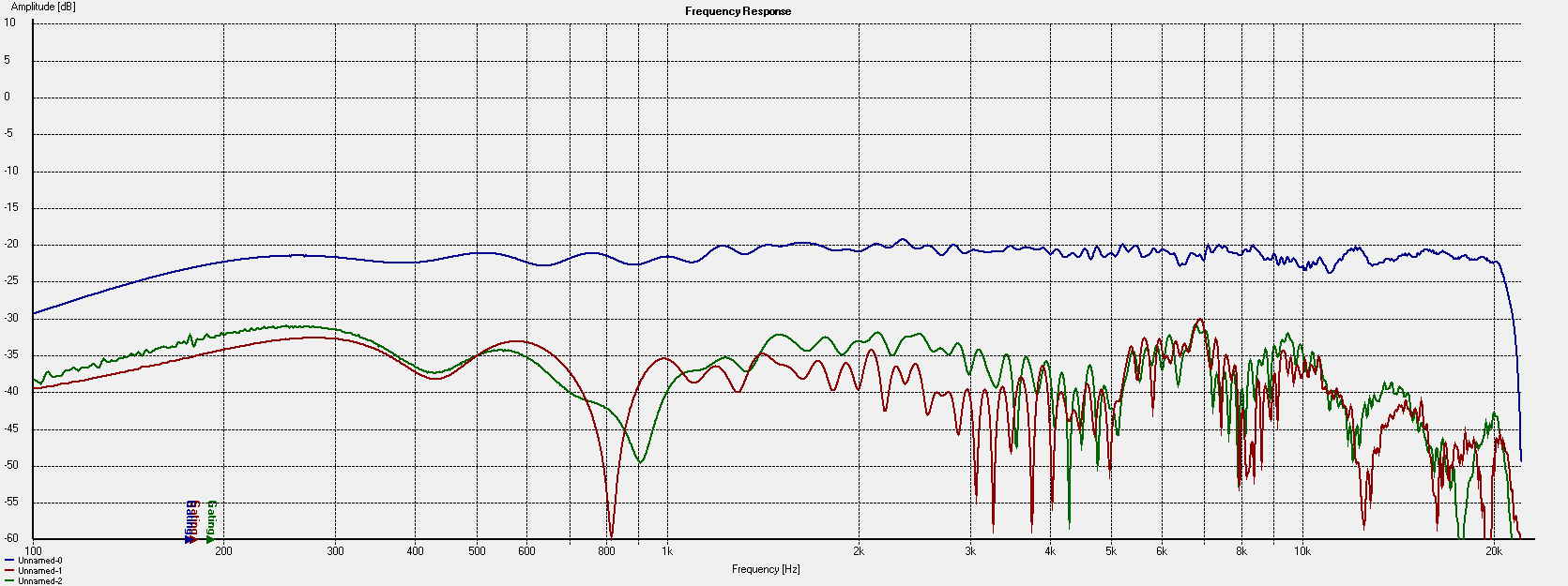

round the back
Following on from my last two posts, measurements round the back of the speakers, starting from 180 degrees (directly behind) and coming forward on the left side (front view). See two posts ago for details.
Plot 1: 0, 180 and 165 degrees;
Plot 2: 0, 150 and 135 degrees;
Plot 1: 0, 120 and 105 degrees;
Plot 1: 0, 97 and 90 degrees;
We'd already seen the cavity resonance due to the baffle behind the tweeter. It makes a narrow hole directly backward, and spread the energy out to the sides. After some thought and looking for it in reflections around the room, I'm not planning to change that.
During these measurements a few other ideas came to mind - my next post to follow soon.
Ken

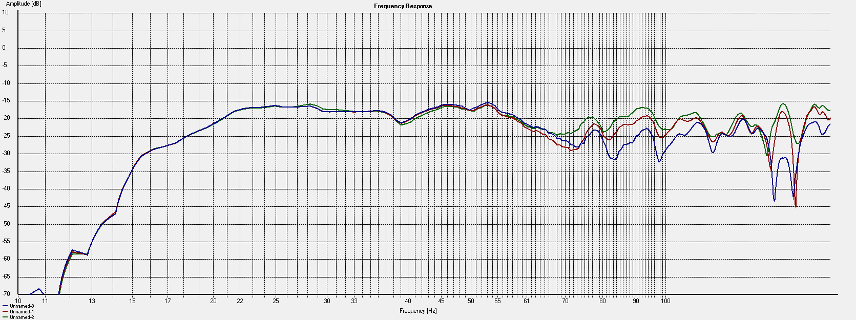

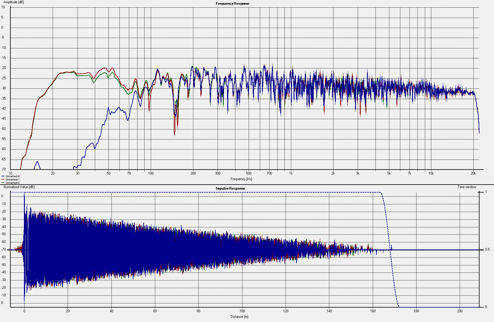

Random measurements - the end for now
Thanks again to Juhazi for pushing me to do the measurements, though I didn't do 10 degree steps this time ...
This post covers three quite different measurements (in four plots).
Floor bounce: Plot 1, I moved the mic back, on the tweeter axis to 240cm (red) then 160cm (green) the blue trace is the original 80cm. I did this in part because I'd noticed that some effects I had been attributing to floor reflections were more likely furniture reflections and I moved things around. Note that the speaker was not in its usual position (i.e. different from earlier in the thread, though it's back there now). I'll skip to Plot 4 - this is measured in the vertical listening window. It gives me an idea for listening at different heights and seeing how well my hearing tunes out the floor bounce - the response is sufficiently consistent at other frequencies that it might be a worthwhile experiment.
(Turns out I'm listening to Floor as I write this - Nightwish)
Plot 2 is a check of the power response of an OB combined with my four subwoofers. The subs were reduced 3dB to allow for only driving one OB, which probably leaves them loud by between 0 and 3 dB - the measurements were not at the usual listening position. I'm happy how flat the response is given that it's not measured at the target location. I think I might have hit on a lucky distribution and setup of subs.
There's a dip around 90Hz due to the transition from monopoles to dipoles, as noted above, reaching the Schroeder frequency (90Hz+/- a few) was a design requirement. I can't prove it's a good choice, but bass instruments with harmonics bridging the transition sound great. Dipole bass advocates would no transition at all... The red trace has the wrong setting on one of the subs and is with the mic in a different position, I left it in.
Blue trace, no subs, Green trace, four subs.
The lowest frequencies are from a bandpass sub that was meant to be flat down to 18Hz in room (designed for the room mode). The house has been extended and said room mode is now 15Hz. I doubt it makes a difference.
Plot 3 resulted from my curiosity to check the reverb time of my room. This is measured with the speakers back in position (actually I made an error of about 15cm on one and I think I fixed that after this measurement, so not quite). The mic is equidistant from the speakers to within 5mm (laser measure). I present this as a curiosity, it can be compared with Plot 2.
Comments or questions most welcome on any of the above. I hope it's useful to someone, especially as concerns the GRS drivers and ideas for baffles for them.
I can't say how pleased I am with the sound - I'm at that stage where I have to listen to everything, and that's going to take months - I've hardly touched my favorites and there are whole genres to explore.
Ken

DCX users should recognize the notation I use below; I've added clues for those unfamiliar. Other than the bass-mid, and noting the almost resistive impedance of mid and tweeter, it would be simple to make passive crossovers: surprisingly so. Only the delay of about 1/9th of a wave at the crossover, to get the main lobe on to the tweeter axis is hard to achieve and may not matter in a slightly different setup.
The tweeter and mid are driven from the same type of amplifier, the bass-mid amplifiers have a few higher gain which I roughly account for below.
Tweeter: 0dB gain. Crossover is LR24 (LR-4th order) high pass at 3.04kHz; EQ is mainly one HP (i.e. 1st order shelf adjustable above the stated frequency) at 3.11kHz gain -4dB.
There's also a peak filter about which I'm equivocal: BP 6.57kHz, +2dB Q=7.1. It corrects a small ripple that's seen over a wide range of angles and distances: a small dip is seen around there on the GRS datasheet.
Midrange: -2dB gain. Crossovers are i) LR24 high pass at 691Hz, ii) low pass at 3.04 kHz. EQ - the lower crossover has slightly better phase with a BP (2nd order section) peak at 581Hz gain +6dB Q is 2. It's possible to get almost the same by reducing the low-pass crossover frequency slightly and reducing the peak. The difference is subtle - I went for deepest reverse notch.
Both mid and tweeter are delayed by a couple of inches as they sit in front of the acoustic center of the bass, I adjusted this to get the main lobe pointing forward: by measuring at the nulls and getting them symmetrical to within a few cm at 3m.
Bass-mid - the overall relative gain allowing for the different amplifiers (all UcD, but different types) - is close to 0dB.
The lower "crossover" is a 72Hz 2nd order Butterworth high pass, but is more a blend with the subwoofers than a well-defined crossover - unique to my implementation (room).
The upper crossover is LR24 at 706Hz - it takes a bit of notional overlap with the mids to get the sharpest reverse null: the GRS droops a bit just below the crossover, the unfiltered 14NDL76 is relatively flat to well above the crossover.
The EQ has four 2nd order sections (BP). The first is inaudible - I put it in to flatten the already gentle breakup peak - BP 2.16kHz, -4dB, Q 3.5. This does nothing and could be omitted.
The other three EQ filters correct the OB response and the damping, mainly from the motor: fs/Qts is around 132Hz. I prefer this approach to one or two shelf filters: there are more degrees of freedom.
The resulting filter response, excluding the crossover which reduces the peak electronic gain by a few dB, is peaks at +6dB near 80Hz, slopes down to a minimum of -6dB at about 209Hz and recovers to 0dB by around 450Hz.
This is, as expected, and predicted by @CharlieLaub in #2, steeper than 1/f.
One 1/f slope is needed to compensate the OB response, below the dipole peak, and "part of" a second 1/f is needed to compensate damping of the mass-spring resonance.
There are other combinations of three filters that give almost the same result, but here are the ones I settled on:
BP 80Hz +7dB Q 3.2; BP 135Hz +3dB Q2.5; BP 218Hz -8dB Q3.2,
