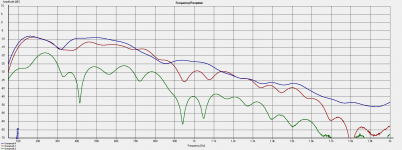

Welti & Devantier paper and study ignores vertical modes... I have found it a very difficult issue, because a sitting person has ears at near half of the (small) room height, so a strong null is unavoidable. I even had one sub on top of the bookshelf in my HT, without help. One at half height near listener would help...
Here my HT in stereo (L/R measured separately) with a single sealed 2x15" sub, minidsp 2x4HD LR2 xo at 100Hz. Upper lines at ear height when sitting and lower curves at butt height on the sofa...

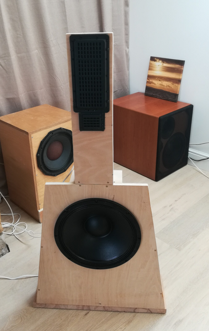

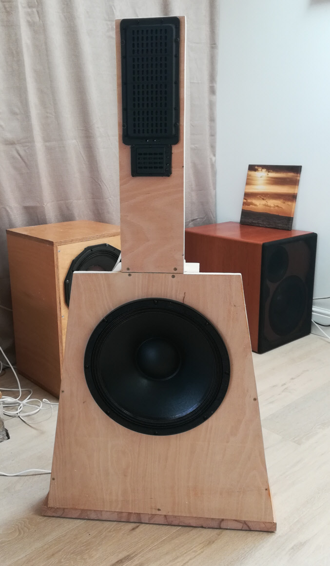

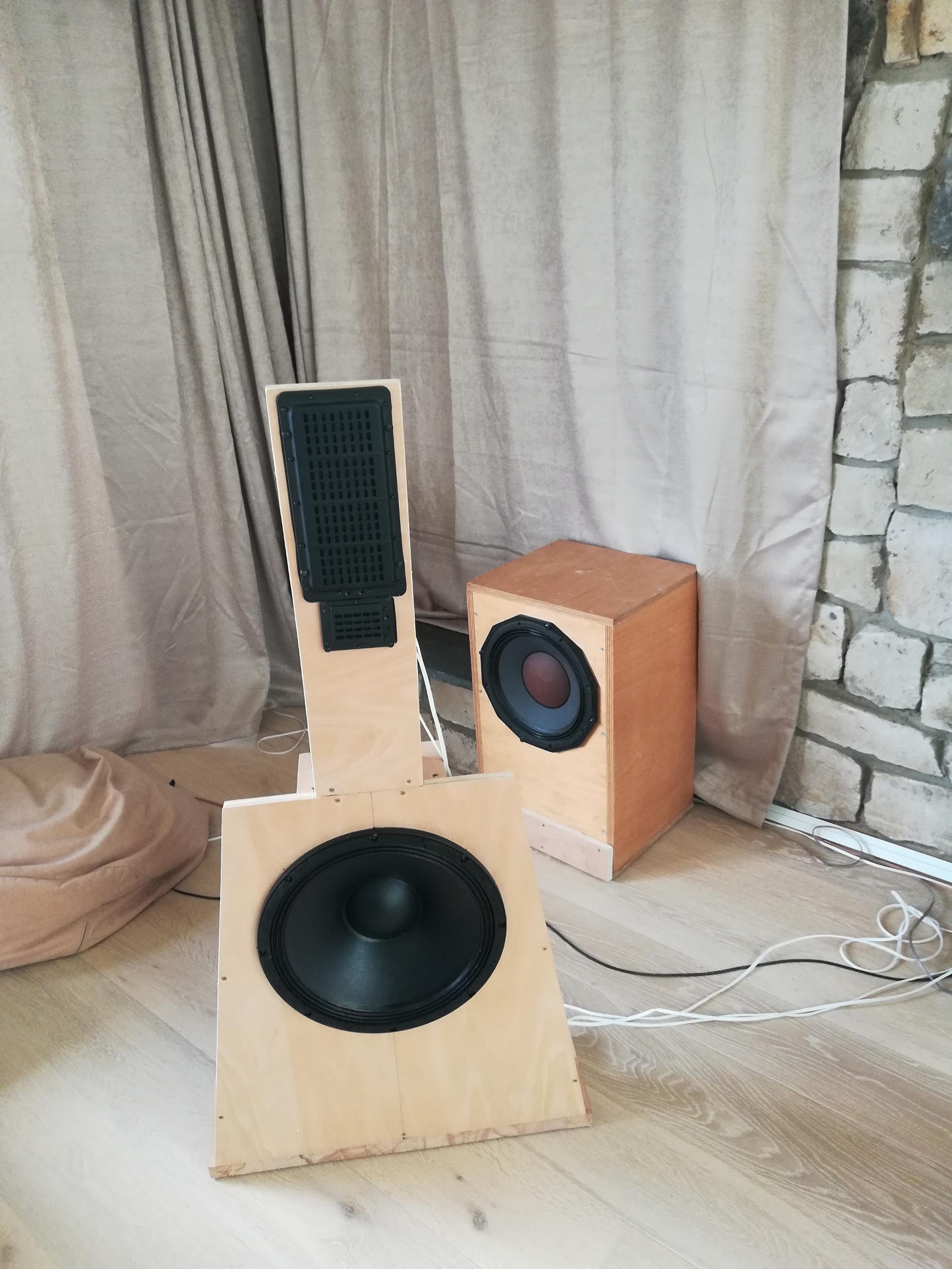

- After 10 days of planning and 2 days of building; thanks to one forum member / an OB
