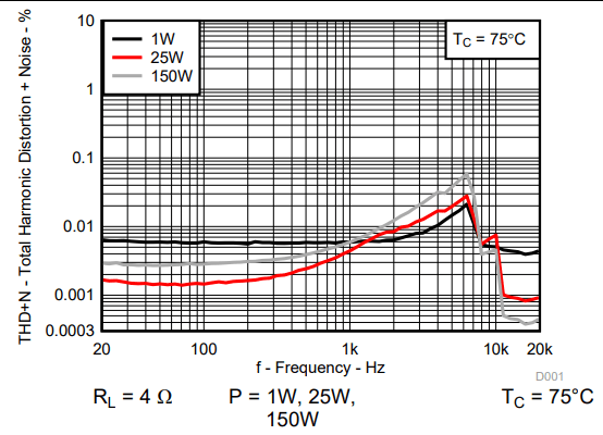

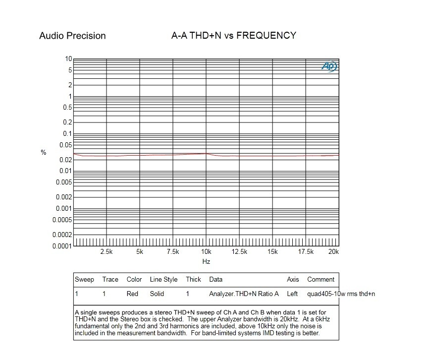

For example:
this graph is THD(Frequency) of the Class D "single-chip" amplifier TPA3255:
and this graph is THD(Frequency) of the (venerable famous and bright) Quad 405:
Both amplifiers are non-ideal (sorry for this trivia) but which is better in the sense of lower degree of non-ideality?
IDK.
And nobody knows.
And so on (I suspect it will be ad infinitum).
