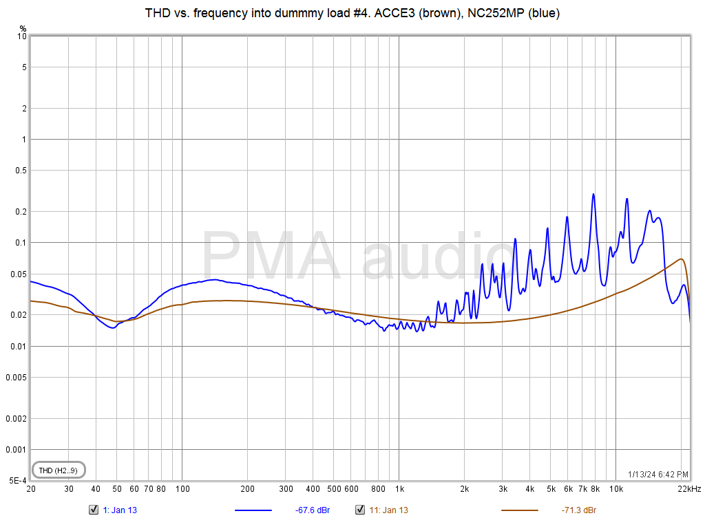

Reliability and MTBF aren't in the assessment. You can calculate it, that is beyond the scope of the proposal.Reliability/MTBF is difficult to measure till you're already entered the market, and it can change over time due to production changes.
Also low distortion does not have to come at the expense of other performance metrics, it just takes sensible design, ~10ppm isn't hard to attain for instance with straightforward architecture into 8 ohms for class B. Same for low noise, this isn't rocket science.
One problem throughout this thread is that the word "quality" is almost meaningless, or rather has many different meanings from ergonomics to MTBF to audio performance to power efficiency to flexiblity of configuration to value-for-money to "looks stylish", etc...
Low distortion without any consideration of other factors is where the problem lies. The idea behind this initiative is that this is corrected and other, as important, aspects are addressed as part of the design process, or in the assessment of a finished or commercial amplifier.
Fair comment on the use of the word 'quality'. It must be 'technical design quality' or perhaps the word not used at all within the framework of the proposed assessment.
I do not want to muddy the waters with perceived sound quality. We all have our preferences and those have to be respected. The assessment is purely on specific technical aspects. (Sugden would probably score quite well in the tests).Mind tricks

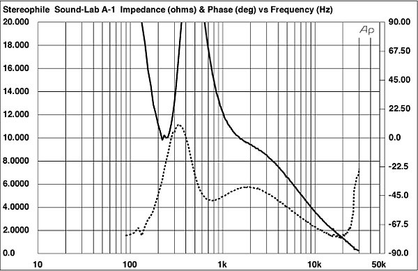

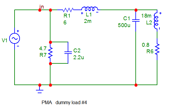

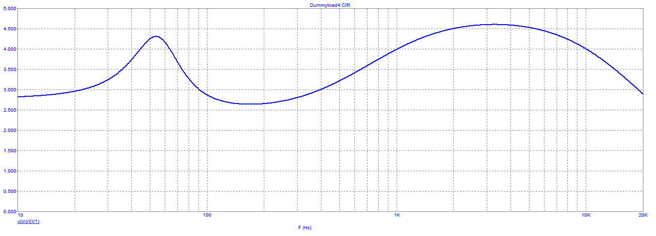

John Curl suggested a 0.1uf very high quality polystyrene (low esr, etc.) at the amplifier output terminals. Not fair because its not realistic, but it may be a torture test.The reliability can be predicted from tests with difficult complex loads.
According to JC, if the cap is REL polystyrene (Richard Marsh's patented design), or close to that good, its good for causing oscillation. This is from experiments he did.
Hey, my speakers and Sound Lab, and I know they are difficult. I will say this: Benchmark AHB2 didn't cut it all that well with those speakers. OTOH, Marantz MA9S2 are very good. A modified Aragon 8008 MkII was somewhere in between.
EDIT: IMHO, noticing things like how different amps sound with a difficult load likely gives some insight into better topologies and better construction details. For MA9S2, the service manual says if you have to move any wire for any reason, put it exactly back where it was when you are done working. IOW, layout is critical for its level of performance.
