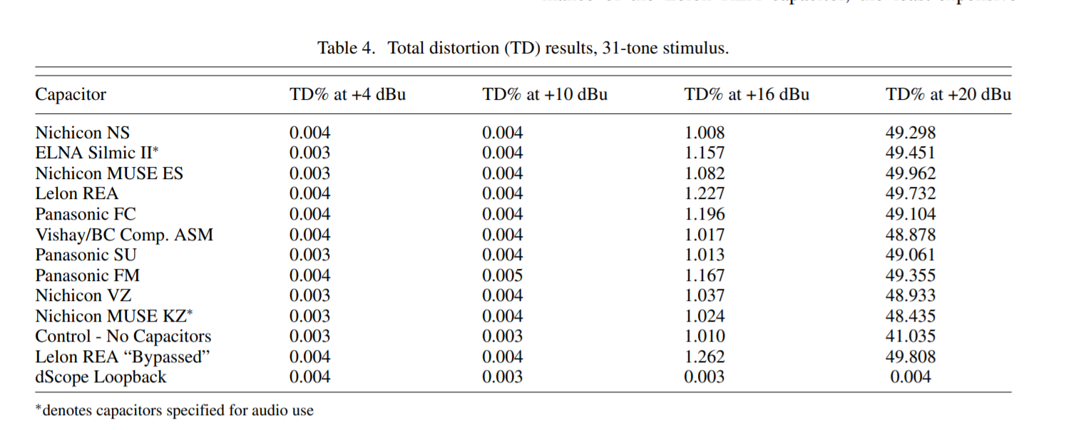

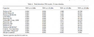

In the 31 tone test the author concludes:
Results of all tests at +4 dBu and +10 dBu show no appreciable increase in distortion products over the test instrument. At +16 dBu, we begin to see slight differences between capacitors, but still no more than a 0.25% increase in distortion over the control.
The Lelon REA's 1.227% is a 22% increase over the Nichicon NS at 1.008%. All the caps appear to soil the sheets at high levels, showing distortion nearly 20% over the 'no-cap' control circuit. The takeaway may be don't use electros or 5532s.
Still all credit to Anderson, that must have been a ton of work.
rdf, I think the 31 tone test results need a bit more appreciation before any broad-brush difference can be assumed due to particular capacitors.
The author did indicate that one DUT with capacitors gave a slightly lower TD than the control channel without caps, and indicated there may be noticeable TD differences between channels due to gain and resolution issues. That could raise a red flag as to cherry picking a performance difference, especially when all DUT channels gave pretty much the same TD results at 6dB lower level, and 4dB higher level, and where opamp distortion was pretty much the major TD instigator.
I reckon the takeaway is that this is what to expect with 5532AP based line-level mixing desk audio equipment - and that may well be good general information for JAES readers. Maybe some of those readers will also check out whether they can swap out their 5532 devices for LME49720s, although at $3 a pop that may cause the thought bubble to burst.

..the takeaway is that this is what to expect with 5532AP based line-level mixing desk audio equipment..
Agree that's a fair situational takeaway. Also caught the note about not reading too much into the precision of this test. Understanding the mechanisms at play when the test circuit is under duress - +16 and +20 - might still have value as the distortion differences even masked by the 5532 contribution seemed significant. Not sure the author intended 20% precision.
It is probably worth appreciating where the paper fits in - the author appears to be the only staff member associated with electronics/audio equipment in a large Uni school of Music. And the technical performance of existing console equipment in that environment would likely be a very small item of interest in the audio recording scope that the associate professor covers. There is also a 'publish or perish' pressure sometimes at a Uni, so I'd imagine the paper and project were a good fit for showing how to set up audio test gear, but not have to be at the bleeding edge of anything and everything contained in the paper, especially as the contents would go over the head of pretty much anyone else in the school.
