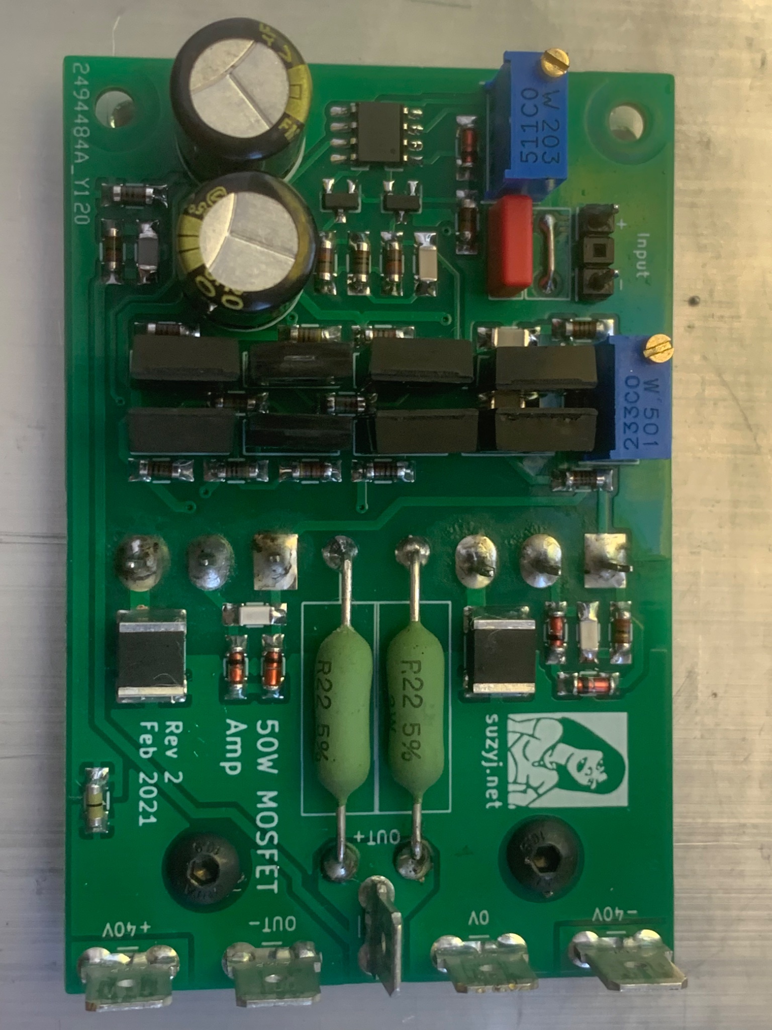

@Dolamike i have one pairs finished board and 2x r2 version 50w PCB
I sell my 50w amp because i want to build 100w🙂

What price do we get for a finished amp?

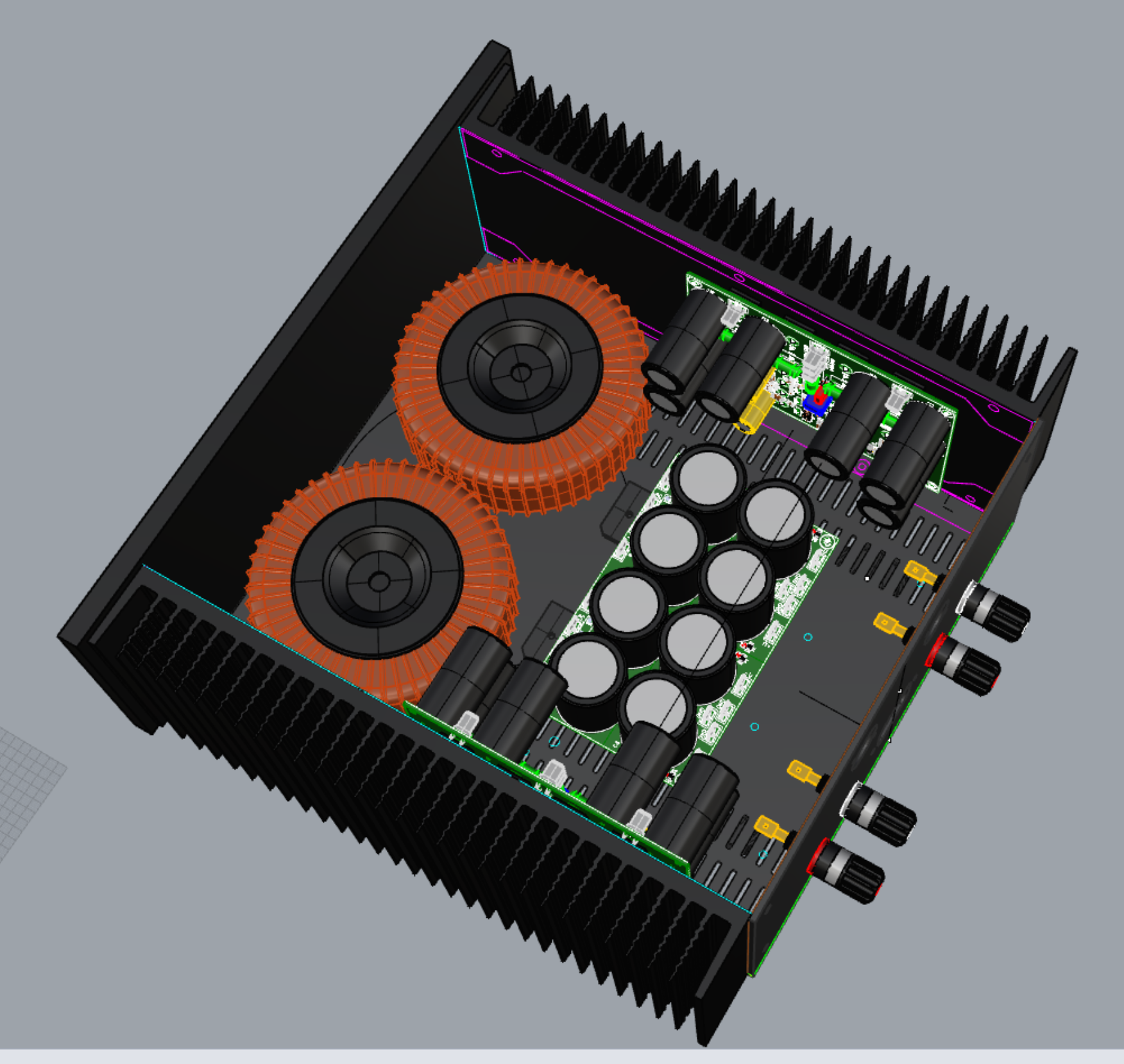

Some amplifiers are worth spending money on. Some of them for me; Parallel tda7293, LM4702 LME49830 and AEM6000. 2x Amplimo 2x35V 300VA transformers for AEM6000 only 240€....
I think that it would be technically beneficial to put all the transistors in the same heatsink and work with equal heat in AEM6000. I also think that the mids of this circuit, which are great with sst404, will be even better with JFE2140. It will be a good amplifier with DC and short circuit protection, soft start and ac filter.
