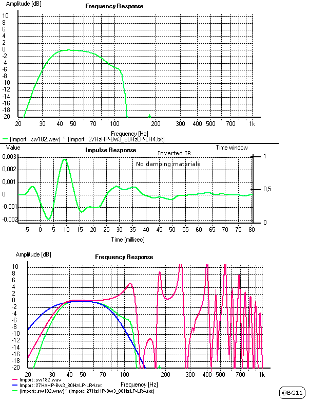

for the watts I've put 125 so Eg is 30.98.
I find a ~5dB difference.😕
Compared to what.What is confusing? 125W/8Ohm requires a Rms voltage of ~31.63 (V)

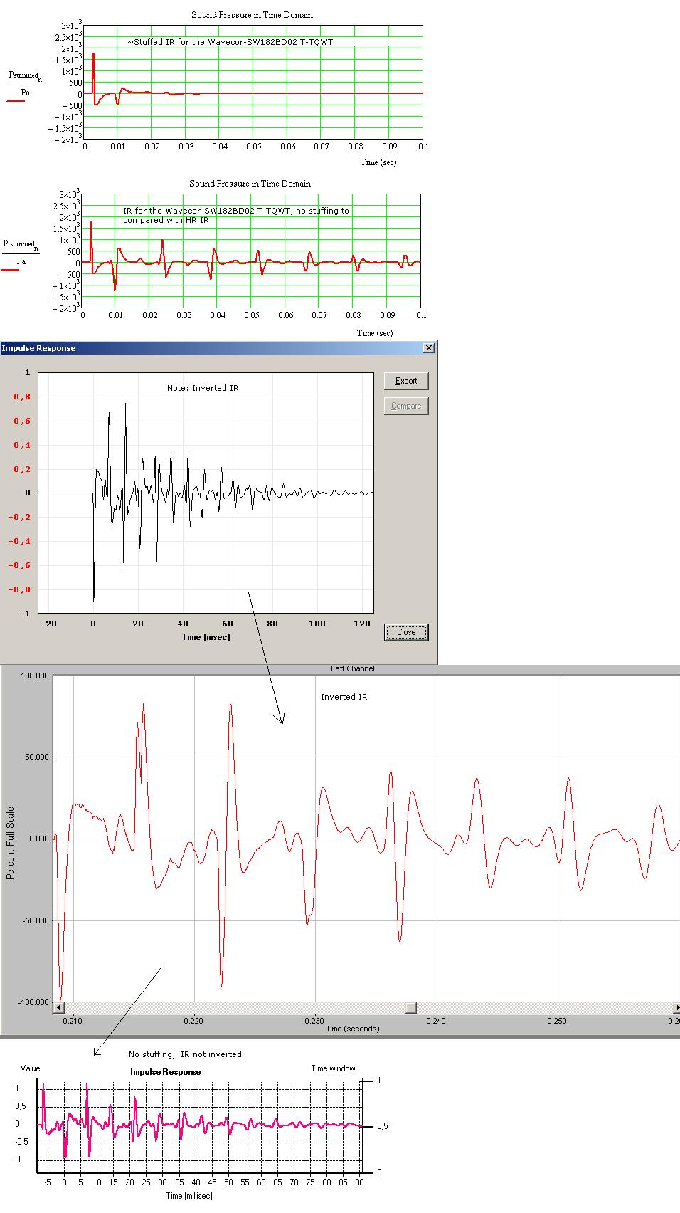

What do you think about the impulse response ?
Excellent of course.. 😉 If you do the necessary investigation of this box when properly stuffed with damping material.
The picture showing the HR IR is almost impossible to interpret unless the impulse is magnified and chopped into small pieces in order to give any on psycho acoustic observation based reliable clues of the perceptible performance.
I find any attempts to base assumptions on how a T-TQWT/T-QWP or even a multi-folded TH will perform viewing the HR IR to being an utterly impossibility.
Have a look at the submitted picture to get a clue.
b🙂
